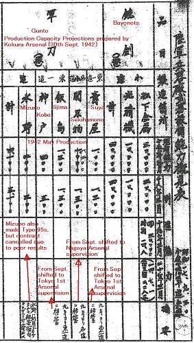

Bruce Pennington Posted February 28 Report Posted February 28 And that would explain why my brain has been carrying around both numbers, 1940 & 1942! I think I will default back to '42 after reviewing Nick's post and chart page, which I'll post below: "Further on details of interest to collectors, I understood from Stu W's article that there were unknown markings. Production statistics information often help in clarifying such points, so I show you an excerpt of production capacity projections for March and September 1942. You will see a supplier called Mizuno , who is not included in Stu W's thread. They only produced for a few months in 1942 before getting sacked. They had a logo consisting of the character 水 in a hexagon. Also of note is the switching in arsenal jurisdictions that occurred in Sept. 1942, which would have changed markings, too." 2 1 Quote
