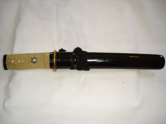

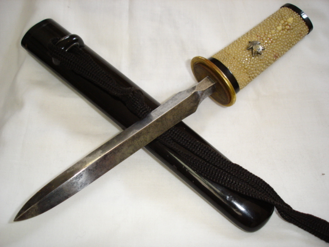

estcrh Posted February 5, 2010 Report Posted February 5, 2010 Thought I would share some pics of this interesting yari tanto, here is a link to some more detailed pics. http://s831.photobucket.com/albums/zz238/estcrh/Antique%20samurai%20yari%20tanto/ Quote
Bugyotsuji Posted February 5, 2010 Report Posted February 5, 2010 How far down inside the Saya does the blade go? How long is it, and how do they compare in length? Is there a Kozuka/Kogai for the Hitsu ana in the Saya? What I am getting it is, do you think the Saya was made specially for this Yari, or could a pre-existing Saya have been adapted to take this Yari? Quote
estcrh Posted February 5, 2010 Author Report Posted February 5, 2010 Bugyotsuji said: How far down inside the Saya does the blade go? How long is it, and how do they compare in length? Is there a Kozuka/Kogai for the Hitsu ana in the Saya? What I am getting it is, do you think the Saya was made specially for this Yari, or could a pre-existing Saya have been adapted to take this Yari? I am out of town right now but I realized that I need to take a few more pictures. Did you see the pictures I posted on photobucket? I have wondered about that myself, if you look at the openings of the tsuka it looks like it was made for this yari but I need to take a better look and see if the saya is the same and how long the yari is compared to the saya and if there were any alterations done. Someone did go to a lot of work to have this made into a tanto though considering that regular tantos would have readily available. I will post some more pics when I get home. Quote
IanB Posted February 5, 2010 Report Posted February 5, 2010 Eric, Piers, These are not uncommon, I have seen maybe half a dozen over the years. The koshirae were obviously made to take the blade with its cut-down tangs since you could hardly get a yari blade into the cavity made for a regular tanto blade. Presumably they were made for stabbing with, particularly for armour piercing. Ian Bottomley Quote
estcrh Posted February 5, 2010 Author Report Posted February 5, 2010 IanB said: Eric, Piers, These are not uncommon, I have seen maybe half a dozen over the years. The koshirae were obviously made to take the blade with its cut-down tangs since you could hardly get a yari blade into the cavity made for a regular tanto blade. Presumably they were made for stabbing with, particularly for armour piercing.Ian Bottomley Thanks, except for this one I have only seen them in pictures and then very rarely, and its been stored since being purchased until recently, this is the first time I have actually taken a close look at it. Well they certainly were not made for cutting, it would do some damage to armor or chainmail by the looks of it. Quote
Bugyotsuji Posted February 5, 2010 Report Posted February 5, 2010 Eric, I have one of these myself and it is as Ian said. They are a nice object to have at hand, but not terribly valuable in the scale of things. Mine is probably worth less than 800 GBP. (?) When Ian said armour/armor piercing, he was probably referring to Yoroi-doushi, which strictly speaking was pushed between the gaps in the armor/armour to finish someone off. Quote
estcrh Posted February 5, 2010 Author Report Posted February 5, 2010 Bugyotsuji said: Eric, I have one of these myself and it is as Ian said. They are a nice object to have at hand, but not terribly valuable in the scale of things. Mine is probably worth less than 800 GBP. (?) When Ian said armour/armor piercing, he was probably referring to Yoroi-doushi, which strictly speaking was pushed between the gaps in the armor/armour to finish someone off. If you have any pics I would love to see it, yari tanto would have worked good against chainmail or other kinds of armored clothing......I have a yoroi-doshi .5 in at the motogasane, it would certainly have done the job, I will post some pics, and 800 GBP is worth a lot more than $800 but you would be suprised how much the more rare weapons sell for sometimes. Quote

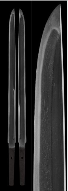

Eric H Posted February 6, 2010 Report Posted February 6, 2010 A very rare shape of Yari is the so-called KIKUCHI-YARI...the example I have added is from the Sue-Enju school. 38.9 cm - muzori - motohaba 2.33 cm - Kasane 1.0 cm - mumei - made in the late Nanbokucho or early Muromachi period. Kikuchi Takeshige in Higo province ordered Enju school swordsmiths to make Yari, those Yari are single edged like a Tanto, and this style is called Kikuchi-Yari. Eric Quote
estcrh Posted February 6, 2010 Author Report Posted February 6, 2010 Eric H said: A very rare shape of Yari is the so-called KIKUCHI-YARI...the example I have added is from the Sue-Enju school. 38.9 cm - muzori - motohaba 2.33 cm - Kasane 1.0 cm - mumei - made in the late Nanbokucho or early Muromachi period. Kikuchi Takeshige in Higo province ordered Enju school swordsmiths to make Yari, those Yari are single edged like a Tanto, and this style is called Kikuchi-Yari. Eric I have never seen this type of yari before, here is another picture i found after a google search, Quote

estcrh Posted February 9, 2010 Author Report Posted February 9, 2010 Bugyotsuji said: How far down inside the Saya does the blade go? How long is it, and how do they compare in length? Is there a Kozuka/Kogai for the Hitsu ana in the Saya? What I am getting it is, do you think the Saya was made specially for this Yari, or could a pre-existing Saya have been adapted to take this Yari? I finally got to take some more pictures. It looks like the saya was made for this yari, but the saya is much longer than needed? There is no Kozuka/Kogai, from the tsuba to the point is 9in. Quote
Bugyotsuji Posted February 10, 2010 Report Posted February 10, 2010 Ah thanks for the piccies. Yes, it's definitely designed to look like something else. A kind of reverse Shikomi. Not an umbrella or walking stick that is really a sword, but a Wakizashi that is really a spearhead. No other need for the extra length, or for the sori in the saya. Ultimately, besides the beauty of the spear point itself, these are enjoyable mostly for their novelty value, and in the assembly and disassembly, I guess. Everybody should have one anyway! :lol: Quote
