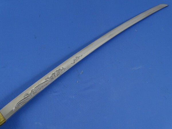

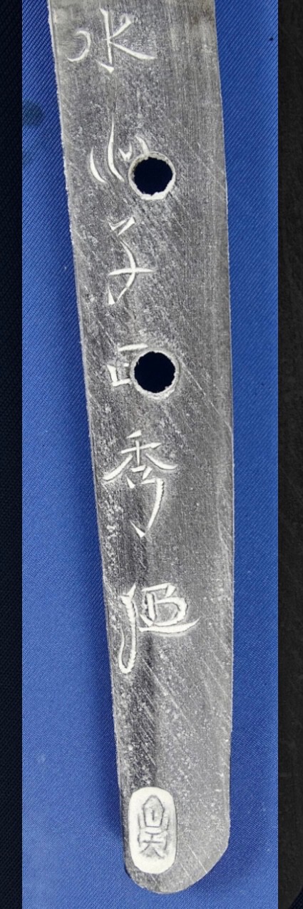

th6y2 Posted Thursday at 05:59 PM Report Posted Thursday at 05:59 PM Saw a listing for a Masahige in WW2 fittings without paperwork recently. What is the likelihood this is an authentic example? I’ve uploaded the pictures of the blade provided in the listing. The only other Masahige examples I’ve seen have the signature on the other side of the nakago so I have my doubts. Quote
ROKUJURO Posted Thursday at 07:59 PM Report Posted Thursday at 07:59 PM SUISHINSHI MASAHIDE (not Masahige) is a very famous name. A blade with this name (as TACHI MEI) without ORIGAMI is very unlikely to be authentic. But you have to look at the blade itself, perhaps it is not bad. Quote
Bruce Pennington Posted Thursday at 09:12 PM Report Posted Thursday at 09:12 PM I only have 4 of his on file, and one is a bad gimei. There is enough variation in each to make it difficult to compare this one with the rest. The only distinctive point I see on this one is the kakihan (enscribed kao). It has a 'bottom' on the 'B' AND an underscore, whereas all the others on file use the underscore to 'finish' the "B". I don't see anything obvious on the mei. Example: 1 Quote
Ian B3HR2UH Posted Thursday at 10:15 PM Report Posted Thursday at 10:15 PM Absolutely NO chance that this is genuine. My strong guess is that it is a showa era fake . 2 Quote
PNSSHOGUN Posted Thursday at 11:34 PM Report Posted Thursday at 11:34 PM https://griffinmilitaria.com/product/1805-dated-katana-by-a-famed-Japanese-swordsmith-in-world-war-ii-army-officer-mounts/ Quote
rebcannonshooter Posted yesterday at 01:49 AM Report Posted yesterday at 01:49 AM The Kokuin on this sword is an exact match for the kokuin of the Showa swordsmith Fukumoto Amahide. Amahide's son Fukumoto Kanemune often signed for his father and others at the school. The formation of the "hide" kanji is exactly how Kanemune signed. I don't know much about Amahide's other students, but would be willing to bet that this "Masahide" is one of them. Does any one have more info on this group? Tom 1 Quote
Bugyotsuji Posted yesterday at 02:07 AM Report Posted yesterday at 02:07 AM The koku seals look quite different. Quote
rebcannonshooter Posted yesterday at 02:22 AM Report Posted yesterday at 02:22 AM Hi Piers, I disagree, they even match the listed Amahide Kokuin in Slough's Oshigata book. Tom Quote
Bugyotsuji Posted yesterday at 02:39 AM Report Posted yesterday at 02:39 AM No, I mean the one in Tyler's first post above compared to the example shown earlier by Bruce above. (By the way, Masahide changed his name to Amahide in old age, I believe.) Quote
PNSSHOGUN Posted 23 hours ago Report Posted 23 hours ago The Showa Amahide was heavily influenced by Suishinshi Masahide and indeed paid homage to Masahide through the use of his later name, along with using the same Kokuin that Masahide used. Of what connection this has to the posted Gimei, I must admit I fail to understand the connection being implied? Also note the Gunto mounts, which are mid 30's style. Quote

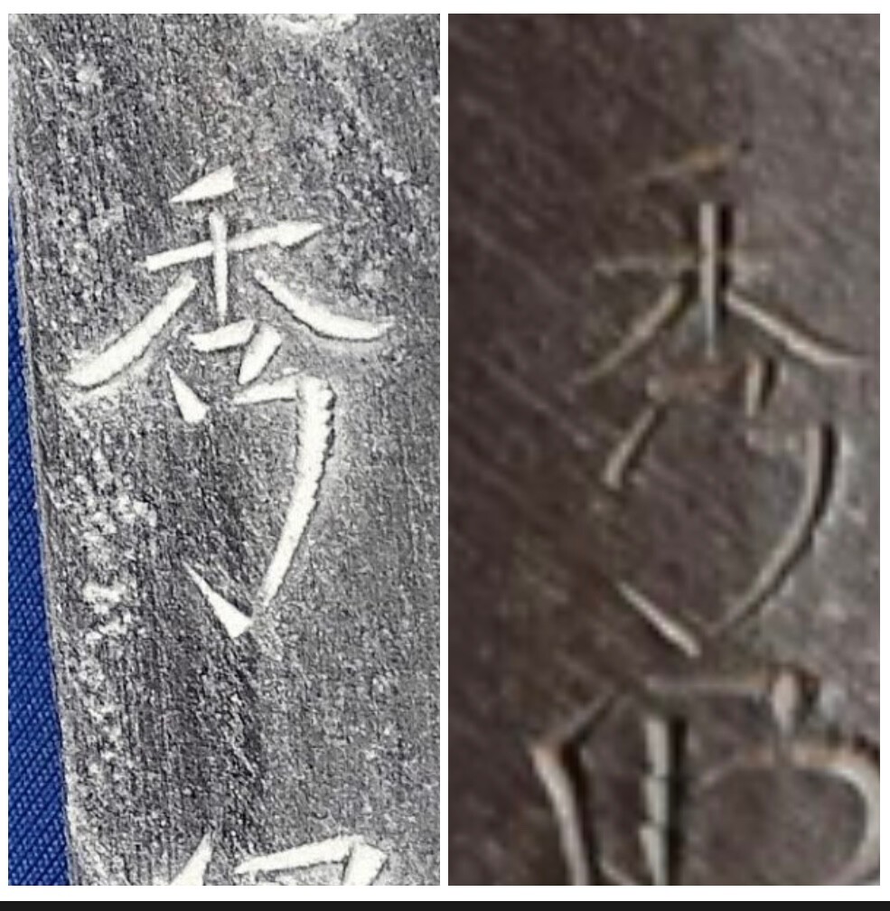

KungFooey Posted 21 hours ago Report Posted 21 hours ago From the seller's listing: The blade itself is engraved (the engraving of a blade known as a “Horimono”), with one side bearing the kanji for “Inori Bu’un Chokyu”, or “Prayers for Continued Success in the Fortunes of War” What war was Japan participating in in 1805? (The date on the blade.) Also, below are comparisons of each kanji character and the hot stamp with an original papered Tokuho (on right). Anyone with eyes can see the difference in the chisel strokes. 1 2 Quote
