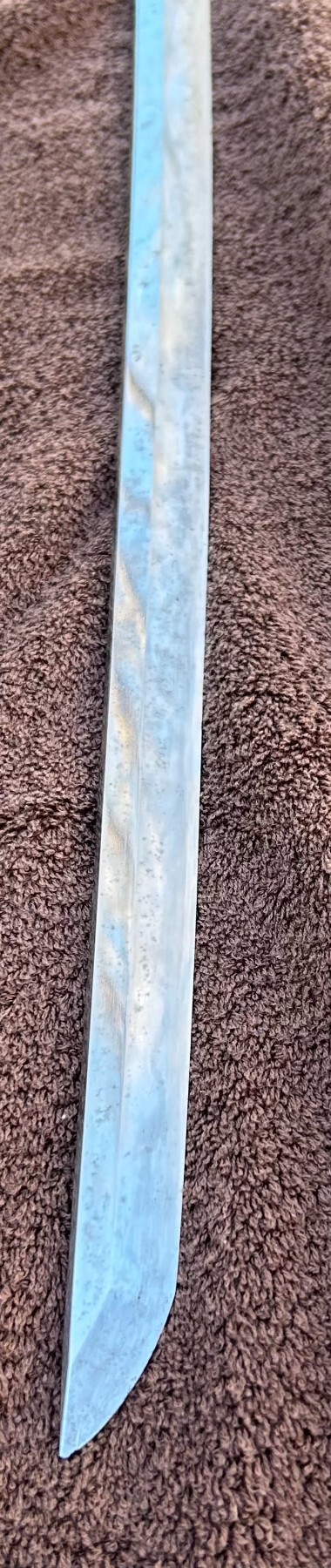

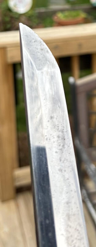

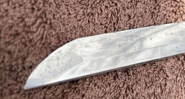

ROKUJURO Posted February 27 Report Posted February 27 On 2/27/2025 at 1:06 AM, reinhard said: There is something wrong with the sori (curvature) of the blade. The monouchi-area seems to bow down. This indicates a retempering of the upper part of the blade. Close expertise (in hand) could solve this question.... Expand I agree that the SORI (it has in fact become MU-SORI) in the MONO-UCHI is strange, BUT a) if a blade is retempered the SORI usually becomes more pronounced because of the expansion of the martensite in the HA area. b) you cannot "partly" retemper a blade because the hardness and HAMON would be lost in most of the rest of the blade I believe that this odd shape is the result of 'cold deforming', i.e. a very heavy blow against a massive object like a tree stump. This cannot be repaired in my experience. 1 Quote
Bruce Pennington Posted February 27 Author Report Posted February 27 I've emailed the owner, asking for another shot of the blade, with different lighting, different surface background. I'll update if you sends us something. Quote

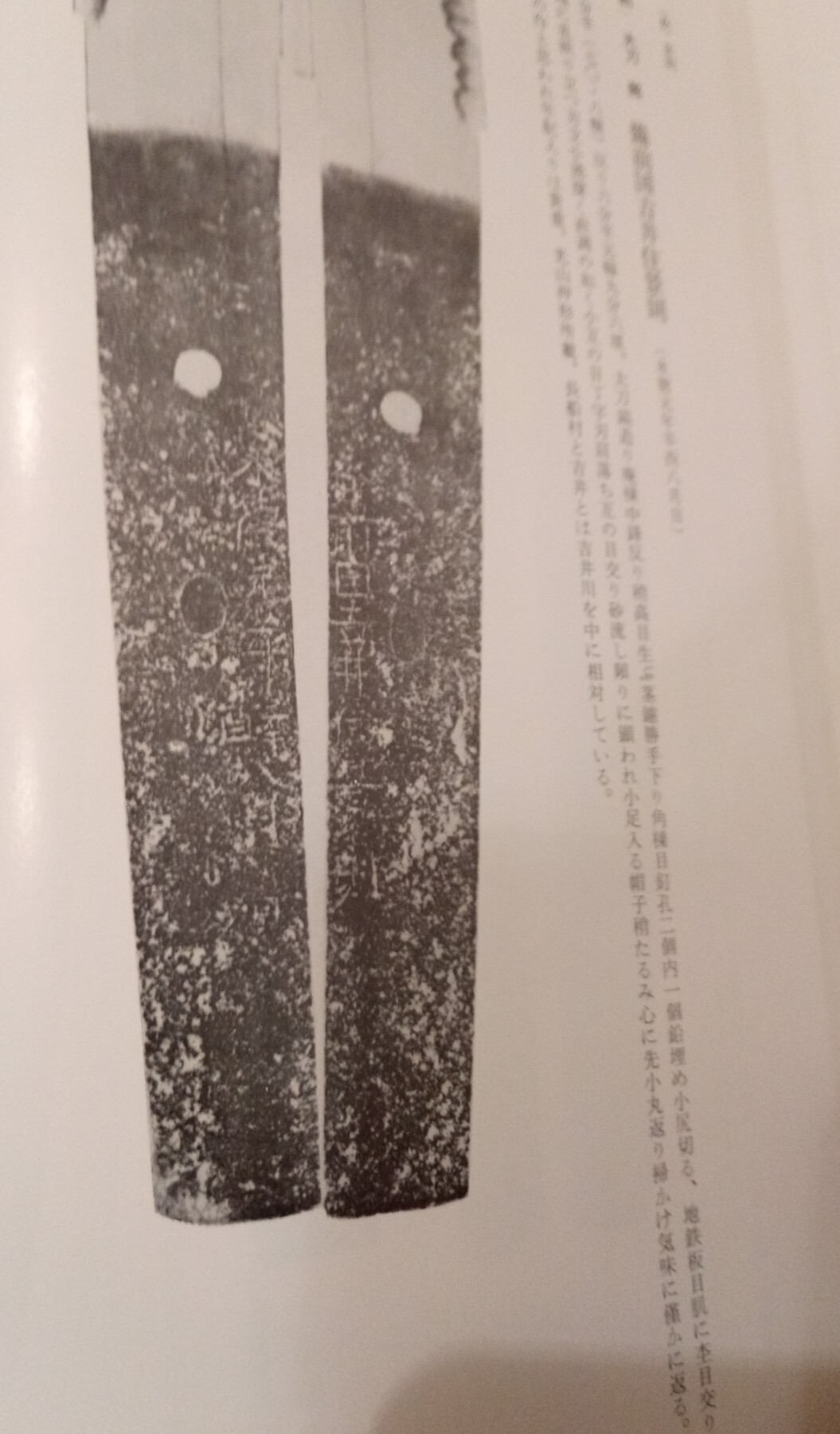

Jacques Posted February 27 Report Posted February 27 On 2/27/2025 at 9:27 AM, Brian said: Jacques, When you see a nakago jiri that is clearly cut off, multiple ana and a hi that is all in the nakago and doesn't extend into the blade.....I expect you immediately think faked to be older, whereas others immediately think o-suriage. But I expect you're constantly walking around hearing zebra instead of horses. They might fake mekugi ana and the jiri, but who on earth adds a short hi and patinates it for no reason? Expand A picture of the nakago of a showato which was arranged to look far much older (i cleaned the mei) this sword is not suriage in no way just the nakago jiri was cut down and another mekugi-ana was drilled. I've a big doubt about the hi you mentionned Quote

Jacques Posted February 27 Report Posted February 27 Brian How many swords have you actually really held? Ubu nakago (one mekugi ana filled) Quote
reinhard Posted February 28 Report Posted February 28 On 2/27/2025 at 2:27 PM, ROKUJURO said: I agree that the SORI (it has in fact become MU-SORI) in the MONO-UCHI is strange, BUT a) if a blade is retempered the SORI usually becomes more pronounced because of the expansion of the martensite in the HA area. b) you cannot "partly" retemper a blade because the hardness and HAMON would be lost in most of the rest of the blade I believe that this odd shape is the result of 'cold deforming', i.e. a very heavy blow against a massive object like a tree stump. This cannot be repaired in my experience. Expand Thing is: We can tell, what the real hamon is. To me it looks cosmetically added in the monouchi-area. a) is correct when the heated blade is plunged into water horizontally; the proper way. It is a dfferent thing when the partially heated blade is plunged into water vertically with the tip downwards. b) is definitely correct, but again: We haven't seen the real hamon yet, just vague pixels. reinhard 1 Quote

Bruce Pennington Posted February 28 Author Report Posted February 28 Got these in from the owner, but don't think he showed enough to answer your question about a bend. I've asked him for more blade, and he said he's send when able: Quote
Bruce Pennington Posted February 28 Author Report Posted February 28 Here are the updated photos: I believe the impression of a bend comes from puff in the towel and/or lighting. 1 Quote
