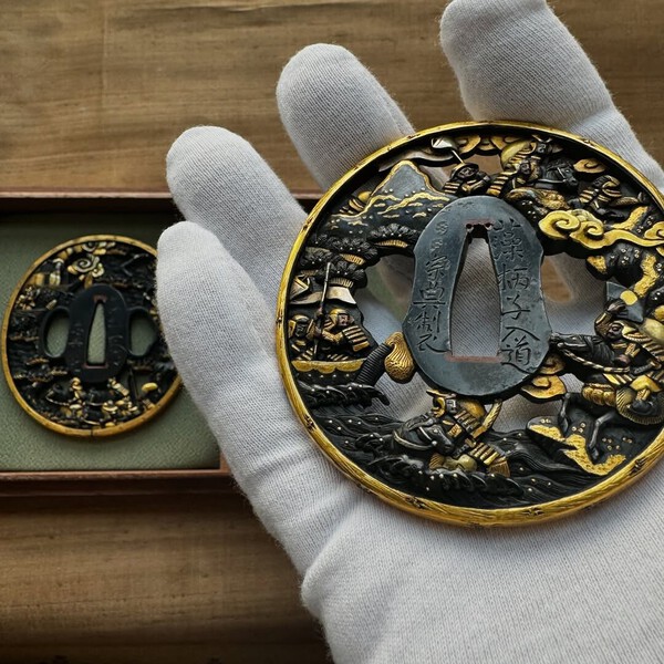

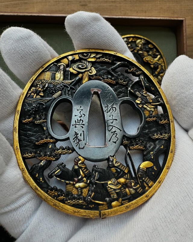

Well, shakudo Soten are rare, especially daisho; this one is single by its still uncommon. Some argue they are seldom of any association with the Soten himself (at least in this style), but they are great examples of the school.
In the US at a show the minimum price will likely be 2,000, maybe 3,000 USD.
The top is basically determined by whether you find an interested buyer.
I once saw an example which sold for 8k, another for 10k. But I would not be sure these prices are repeatable at ease.

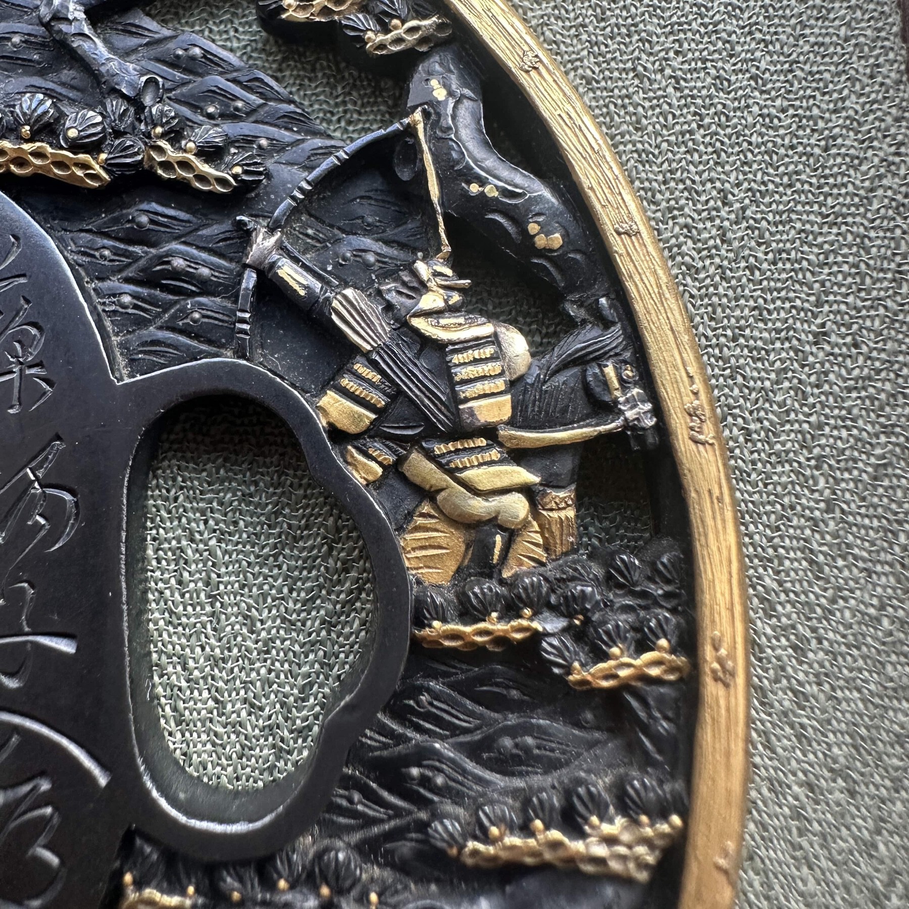

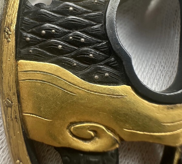

I find your example quite interesting from a different perspective... it is the first time I have seen rivets/pins holding the fukerin join together. Obviously a later fix, but I'd love to know how the rivets are connected to the shakudo plate... a "belled" bore with the rivets filling the belled end?

I've been searching for any information about Soten Tsuba for 2 weeks. If we consider the small details and the overall workmanship, then this set does not arouse any suspicion of authenticity. I compared a lot of Soten photos. I'm not an expert, and these are just my observations.
Depends on what kind of authenticity is desired.
The founder's work - unlikely.
Higher end school's work - probably yes.
Sothebies considered circa 1875 which is Meiji, so their belief is its even after-school imitation.

Even studying tsuba for 25+ years, Soten is one of the schools I know less. I've seen maybe >1000 and would say this is one of the nicer ones. Even with my experience, I'd hesitate to offer an opinion on the signatures.
Soethebies does only a minimum amount to vet a signature. They do try a bit... but not a lot. Take their opinion very loosely.
As to value- probably take what they sold for in 2006 and discount it a small bit. Soten tsuba have not held nor raised (nor dropped) in value as much as some other schools.
The discussed daisho is for sure an above average example.
The Soten school at a certain point in time was so popular that other workshops in Kyoto and Nagoya (citing from memory) started to produce pieces in the style, or so it seems from the common lore.
Some signed as soten others mumei with a large variation of quality, from very crude to high quality. Tsuba from the school proper (first, second and maybe third generation) are extremely rare. Most of example we see are at best "in the style of" from other workshops.
I have by now amassed a database of a hundred referenced pieces. NBTHK papers are basically useless they seems to only certify thet a tsuba is not a modern fake, no information is given about anything.
Also from mei comparison no conclusion either, the variation is staggering.
It is a mess...
