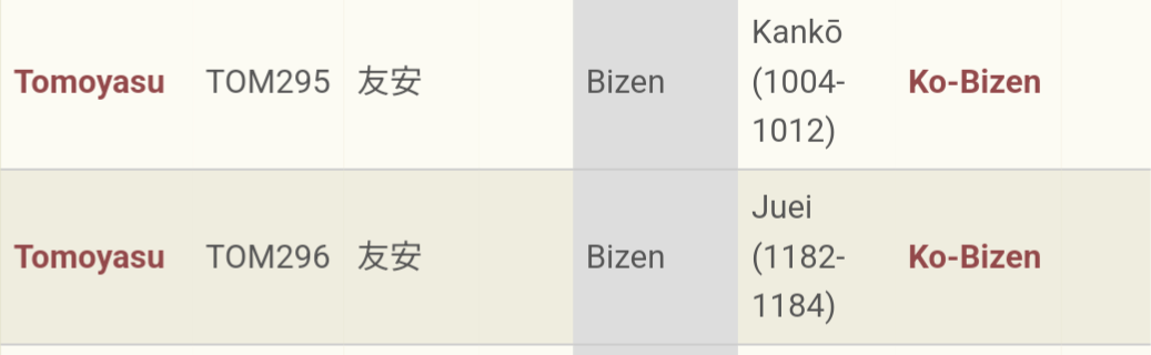

SteveM Posted February 7 Report Posted February 7 4 hours ago, Jussi Ekholm said: I do not know the person writing sayagaki but if I look to me it seems like there is possibly faint 寛弘頃 that would indicate it was appraised c.1004-1012. Yes, that is correct. According to Aoi, this Tomoyasu is the son of Tomonari (友成), who is supposed to have been the origin of the Ko Bizen school (c. 987). Which would place his son (Tomoyasu) around the 1000s (Kanko era, as indicated on the sayagaki). But this leads us down a little rabbit hole, as there is a divergence of opinion about Tomonari. Anyway, without getting into those details, I can only repeat what Jussi says; a blade that appears to be from the early 1000s, that has a plausible signature from Tomoyasu, would be interesting from a historical perspective even if it were retempered. A real unicorn. 3 Quote
nihon Posted February 7 Author Report Posted February 7 Base on nihontoclob.com, there seems to be 2 ko-bizen tomoyasu. Aoi seems to think the sword is form the juei era Quote
