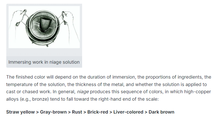

vajo Posted January 31 Report Posted January 31 Maybe the ura side got an extra treatment with niage? Quote

vajo Posted February 2 Report Posted February 2 The side is longer treated with niage. There is no mystery in making one side darker. Quote
Matsunoki Posted February 2 Author Report Posted February 2 Sorry Chris, in this instance you are wrong. I have the benefit of handling the piece and also the others that came with it. All had similar heavy discolouration to one side. 1 Quote

vajo Posted February 2 Report Posted February 2 52 minutes ago, Matsunoki said: Sorry Chris, in this instance you are wrong. I have the benefit of handling the piece and also the others that came with it. All had similar heavy discolouration to one side. Colin i think i misunderstood you, sorry. I thought these doubled color tsuba was the work of the artist. No i understand it was obvious the reason of a long time presenting. 1 Quote
