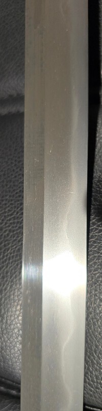

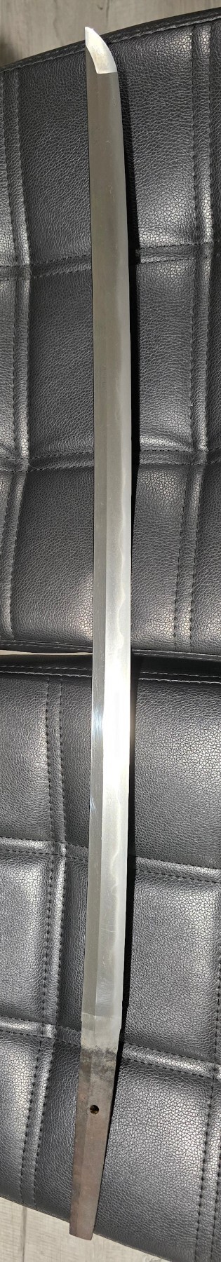

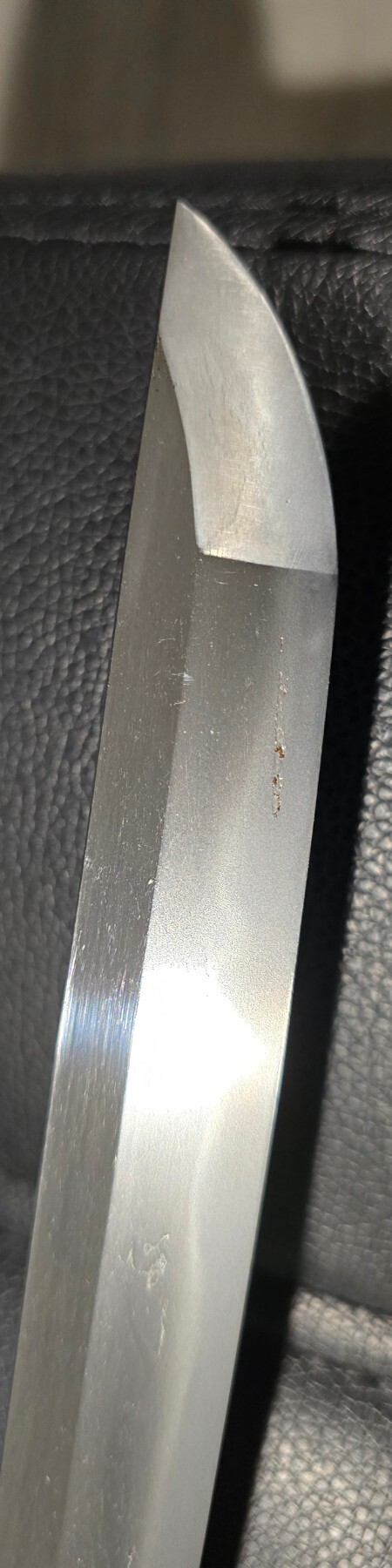

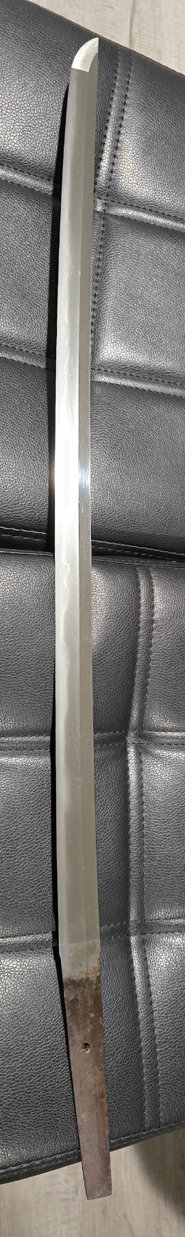

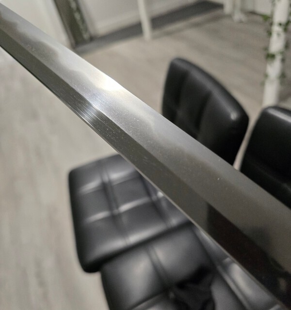

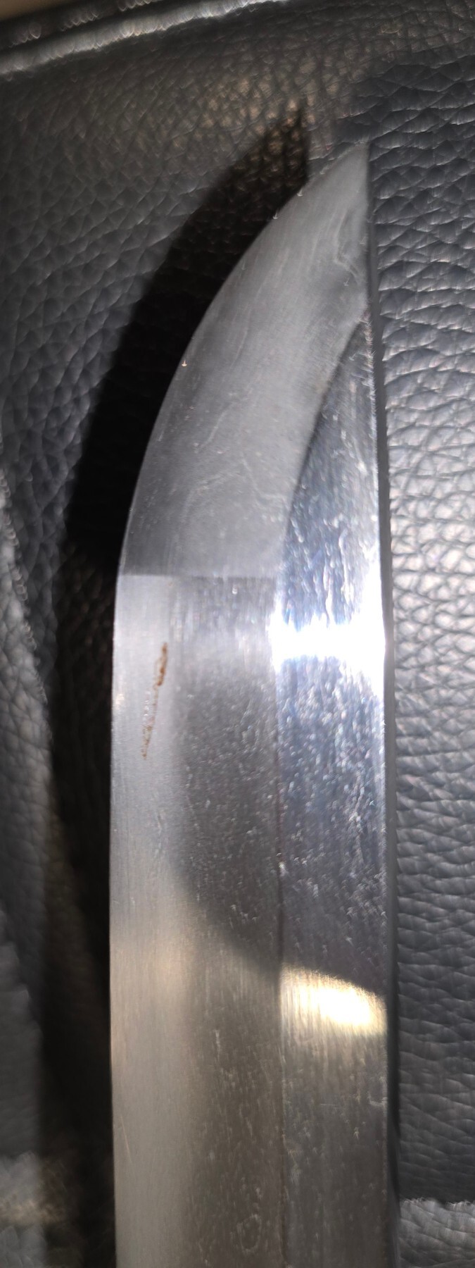

Hello, everyone!
I'm very much new to collecting and appreciating Nihonto, and this is my first full-sized blade - I was wondering if anyone might be able to shed any insights or thoughts on this mumei? My only thoughts are that its shallow sori and general profile might suggest it's a Shinto blade, but that's about it, and I'm afraid with my (lack of) experience I don't trust myself to try and read into the jigane or hamon. Happy to try and take any other pictures if that might help.
Album: https://drive.google...vobNSIrM?usp=sharing

I'm also fairly new to the Nihonto world, so can't pass much judgement on the finer points of the blade, but I would say it looks to me like a really nice mumei katana.
I would also agree that the general form looks to be Shinto, and the rust levels on the nakago reinforce this - but I can't quite shake the feeling this could be o-suriage, where the entire original tang has been removed?
It having been o-suriage would also explain the kiri cut (flat end to the tang - https://japaneseswor...com/terms/terms2.htm)...
How long is the sharp part of the blade?
Thank you, George! I had added the photos to Google Drive because I thought it might be the best way to preserve original quality, but I certainly understand the reasons to prefer embedding them directly, and I appreciate you taking the time to do so. I'll take note going forward.
And thank you both for your feedback so far - it definitely does look o-suriage to me too, especially seeing the hamon extending down to the nakago. I believe the nagasa is around 62cm / 24.5", so quite a petite blade.
