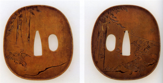

I have a catalogue called "Drawing with tagane chisels"...that was put out by the, now defunct, Tosogu Museum in 1997.
There's a shichu tsuba by Mitsuoki Otsuki illustrated in it which is, imo, one of the finest works of kata-kiri in existence...and I've seen a few ;)
Anyway, for my own nefarious reasons I'm looking for a bigger, better, clearer image of this masterpiece. Front and back.
If anyone has such an image...I'd be most grateful to receive a copy.

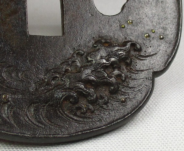

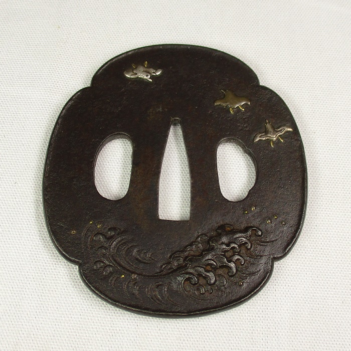

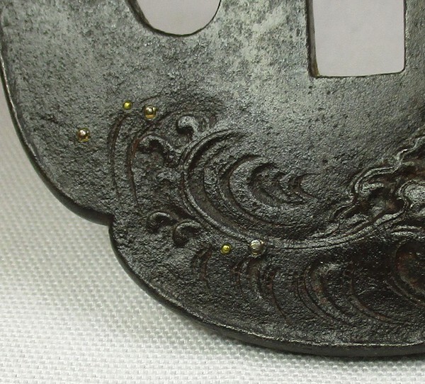

Just to better illustrate the quality of Mitsuoki's kata-kiri here's an excellent example borrowed from the MFA site...for educational purposes. ;)
What Mitsuoki does that marks his work out as being something more than regular kata-kiri is he subtly begins to carve and model the focus points of his subject. Where most kata-kiri is a picture made up of chiselled lines representing brush strokes Mitsuoki Otsuki pushes his strokes to the point they are actually also carving the picture in a more sculptural way.
In this example the Oni's nose is actually properly modelled and the robes, while cut with a kata-kiri chisel, are done so deeply, and vigorously, as to appear completely 3 dimensional. Personally, I judge him to be a true genius of the art form and for me, the most expressive exponent of kata-kiri.

Ford,
are you sure it is a SHINCHU TSUBA? On the photo, I have more the impression of YAMAGANE.
Some aspects of the work remind me of JOI. Of course, he sometimes used a variety of different techniques in one work, and often mixed KATA KIRI with others, more sculptural ones.
