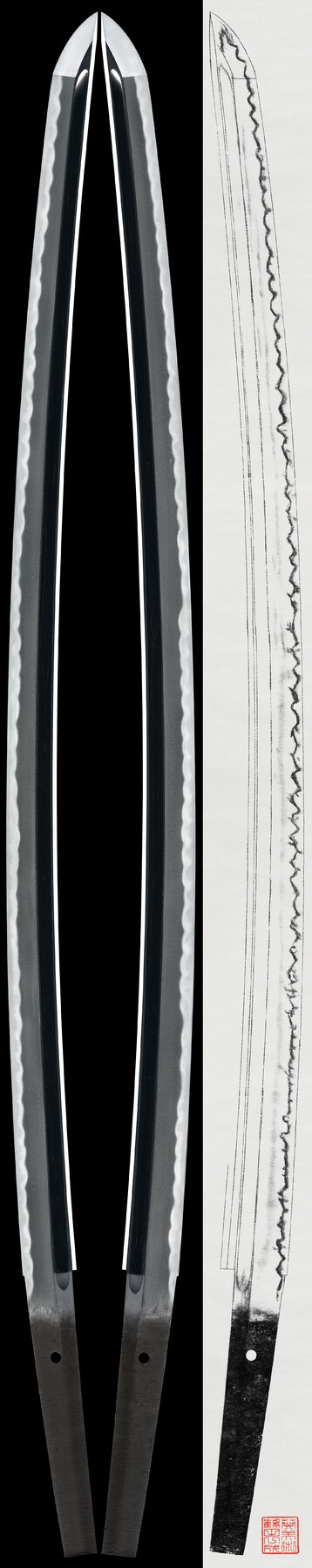

Pierre F Posted January 12 Report Posted January 12 I wish you all a wonderful year for 2025 ! (I hope the timing is still acceptable for this wishes) As a good resolution, I would like to try to acquire my first blade. Well in fact I've been wanting this for almost 2 years... but as you know better than I do... there is so much to know... Well and then to search and learn, isn't that ultimately the real pleasure. I'd like to have your comments about this sword ... I voluntarily prefer not to say anything about it with a more "raw" opinion and spontaneous opinions. Once again all the best for you all and your families. Best regards, 2 Quote

Pierre F Posted January 12 Author Report Posted January 12 I can't explain why I like it .... It is old ...but dont look too old...I like the grain of the steel (for what I can see on pictures) , I like the fact that it has bo-hi.. the hamon look nice. I can't really explain but this sword intrigues me. I don't know if I can say I like it... I just wanted your opinions on maybe why I shouldn't like it ;P I can see it is not on the original shape and probably strongly shortened...In fact, you will undoubtedly see innumerable flaws... hence my question 1 Quote

Lewis B Posted January 12 Report Posted January 12 Good eye. Lot to like there and if you can get it for around the starting bid you will be making an excellent 1st purchase, assuming it fits with your collecting aims. It has to speak to you and from what you say it appears to have made an impression. Positives. NBTHK TH, obviously very healthy, characteristic Nanbokucho era sugata, very little kitae ware and in what appears to be good polish. Cherry on the cake is the very low registration number and date of Feb 1951 which means this was once owned by a Daimyo family. I would recommend you see if Tsuruta san can ask Tanobe sensei write a sayagaki. They are well worth the stipend IMHO. Oli makes a good suggestion too, but Koto blades were thin on the ground in 2024. Quote
Alex A Posted January 12 Report Posted January 12 Its a good blade and healthy and sturdy for its age. You have to like a blade to buy it and obviously know why you like it, if you don't know then don't buy it. Have you read books?, learned for a while?. Learned to know what you like and why ? Would bet most folks 1st sword purchase they later sell. Also. you will get numerous opinions that are not your own. Personally, im not interested much in unsigned swords these days, would that opinion put you off? If it does, your not ready to buy this sword. Its only your own opinion that matters. Quote
nulldevice Posted January 12 Report Posted January 12 On 1/12/2025 at 3:01 PM, Pierre F said: I can't explain why I like it .... It is old ...but dont look too old...I like the grain of the steel (for what I can see on pictures) , I like the fact that it has bo-hi.. the hamon look nice. I can't really explain but this sword intrigues me. I don't know if I can say I like it... I just wanted your opinions on maybe why I shouldn't like it ;P I can see it is not on the original shape and probably strongly shortened...In fact, you will undoubtedly see innumerable flaws... hence my question Expand Looks like a nice sturdy sword. I’d wager the Bo-hi was added much later when the sword was cut down seeing how it doesn’t continue down into the nakago. 2 Quote
Lewis B Posted January 12 Report Posted January 12 On 1/12/2025 at 3:37 PM, nulldevice said: I’d wager the Bo-hi was added much later when the sword was cut down seeing how it doesn’t continue down into the nakago. Expand Agreed, but this shouldn't affect the desirability if its done well and there are no issues exposed, at least thats what I read and hear from Japanese collectors/dealers. It was likely done centuries ago. 1 Quote
nulldevice Posted January 12 Report Posted January 12 On 1/12/2025 at 3:42 PM, Lewis B said: Agreed, but this shouldn't affect the desirability if its done well and there are no issues exposed, at least thats what I read and hear from Japanese collectors/dealers. It was likely done centuries ago. Expand I agree, its just additional points to consider. I think it looks well done. Quote
Jussi Ekholm Posted January 12 Report Posted January 12 I think it is a decent sword. It has an attribution to quite good smith who has very few signed tachi remaining. Honestly I cannot really tell Nanbokuchō Bizen smiths apart from work style. Personally I don't like the size of this as I would want something bigger if looking for a Nanbokuchō sword. For me that bo-hi would be a large negative in this case, just a personal preference. This sword has been around, and it has been listed at several places. Last time was late November 2024 at Yahoo Auctions: https://buyee.jp/ite.../auction/x1161730631 Still old sales are old sales and some time ago it was on eBay listed with asking price of c.15,000$. I feel the current asking price that Aoi has is perfectly reasonable, just that for that amount of money I would look something else. However Motomitsu attributed swords do not pop up online that often and they are often highly appreciated. 5 Quote

Alex A Posted January 12 Report Posted January 12 Hi Pierre They are wrong on occasion. Sometimes you see a sword with two different attributions from two different organisations, sometimes the same organisation but different dates. That's not my issue though, my issue lies around relying on attributions. I want to see an ubu TEXTBOOK sword with a mei to match. Had my fair share of mumei swords, i dont like swords that still have questions that need answering or have me wondering which generation it is that made it. Got a little pedantic lol Im not saying i don't appreciate any good quality sword, i do, whether signed or not. Its what i can live with that matters. People build different collecting habits, we are all different You need to understand what you can live with, this will only come with time and experience. 1 Quote
atm Posted January 12 Report Posted January 12 I noticed that sword, too, @Pierre F. Here is a signed Juyo for comparison: Motomitsu. I saw it at DTI last year. It is an impressive blade. I think it is interesting that despite these two swords from the same smith being relatively similar in their current dimensions, one is signed and dated and the other is mumei. And there is a 6M yen difference in their prices. I think it is hard to pick out a first blade without seeing them in person. The way a blade feels when held says a lot, in my opinion, in addition to being able to better see its features. A sword show is a great way to do that. 1 Quote
