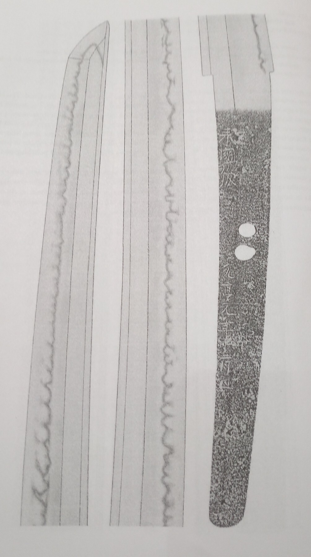

Benjamin Posted January 17 Report Posted January 17 Very wild guess again for me : Spoiler Tachi-mei side (omote?) : Gunome midare with Choji (from the yakigashira) achi and yo other side (ura?) : suguha based ko-achi with nijuba (?) boshi : suguha consistant with hamon, komaru and short kaeri Do I see an utsuri ? Quote
