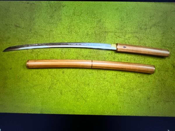

sc72 Posted January 6 Report Posted January 6 This wakizashi (with 54.5 cm blade) Edo/Shinto sword, here in shirasaya (no hozon) has a gold writing on the nakago (that is mumei)... it is difficult to say whether it is original or recent gold work....which should mean "retsu ryu" / "angry dragon?" (zugan in gold)... What does this writing mean? What is your opinion could be interesting? Quote

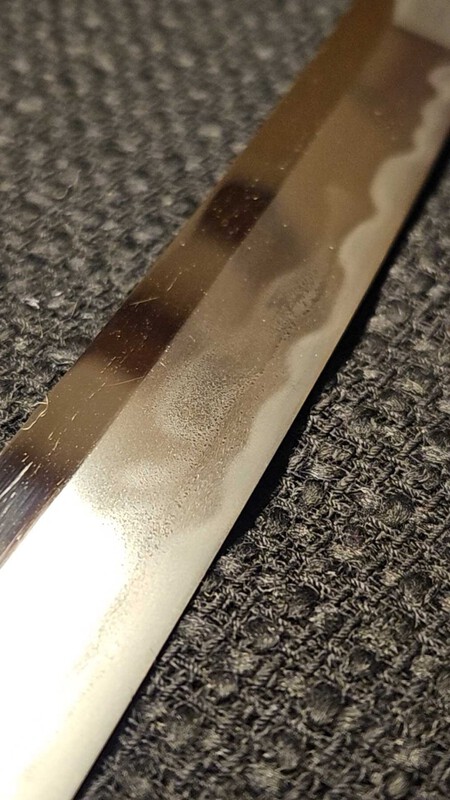

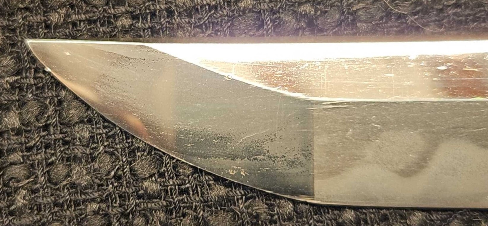

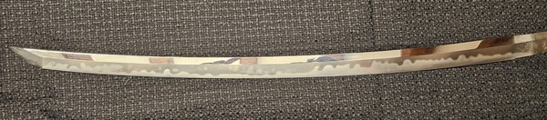

Nihonto student Posted January 8 Report Posted January 8 The world is small...I think I can help as I am the new keeper of the blade... I'm sorry Stefano, I purchased the blade a month ago and the advert probably hasn't been cancelled. I would have liked to make a post dedicated to blade later also because given the Christmas holidays I only had the opportunity to appreciate it a couple of times. The blade is not papered but in this case it was superfluous for me as the blade screams Shinto Mizuta as also expressed on the togishi paper. Know that a paperless Shinto O suriage blade doesn't tend to be very attractive in a market sense but this was the case when "I bought the blade", I was bewitched by his wildness and ambition of the hamon, also I wanted to help the previous owner who due to health problems was forced to sell his entire collection of weapons. About the blade: Nagasa:54.5 Sori 1.7 Kasane 0.64 Hada: dense Ko mokume Hamon: Nie deki, Gunome midare/Hitatsura, Togari, Tobiyaki, sunagashi Kinsuji Boshi: Ko maru, hakikake Nie everywhere, Ji and Ha in all shades and sizes (Definitely Ara nie, boiling effect and ko nie), creating a lot of activity. Regarding a possible attribution I find the Mizuta school very tricky, stylistically I would be oriented towards the Kunishige line compared to the Tameie line but in any case I find it complicated to distinguish the works of the various generations (Kantei point are welcome), this is also one of the reasons why I think that certifying it would be relative/useless since in general the quotation of the various generations are more or less the same and only some specific attributions (Es. Oyogo Kunishige) could give a plus. Below are some photos, please note that in two shots I used a negative filter which I find very useful for seeing the base of the Hamon, Boshi shape and hardened areas in the ji as in this case, especially when the light is not adequate and you are not a professional (like me). As always, comments on any aspect are welcome. 6 1 Quote
