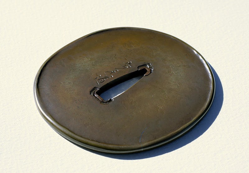

For the last couple of months I've been working on a series of 3 tsuba that explore variations of texture and colour. I find the early Umetada work by Myoju and his son, Shigenari III, to be very appealing in this respect. As a way of gaining a more instinctive feeling of these qualities I've created my own interpretations of examples of theirs.
If you're interested you can see the whole series here.
This is the first one I made, it wasn't based on an existing work but was rather merely inspired by the overall aesthetic.

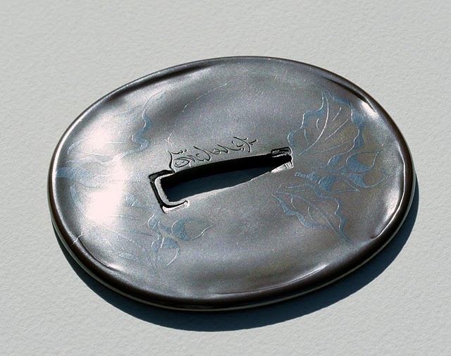

This one is my expression of a well know Myoju piece, one of his most attractive in my opinion. I made a number of minor adjustments to the design as well as following my own instincts as regards the final colouring.
...and a view of the back shot in different lighting conditions.

Firstly I must agree this is truly beautiful work. A question for you though........ Why do you put sekigane in the nakago ana of your tsuba? The use of sekigane is surely to resize the nakago ana. Since these are newly made pieces, then the nakago ana has surely not yet required resizing in order to mount it on a sword.
Hi Keith,
thank you for the kind compliment :)
Interesting question re; seki-gane...I was wondering if someone would question my use of them.
As with all the parts that make up the finished works I use the saki-gane for their aesthetic value. I don't always add them but in this series I was consciously emulating an specific aesthetic. That they are ostensibly functional is of less importance to me, as an artist, than what they ( the seki-gane) bring to the overall expression.
I alluded to this in the thread on contemporary tsuba. The function of tsuba is the same as that of any art-form; ie: artistic expression. I attempted to show that this has probably always been a significant (if not primary) part of the tradition and for me, today, the actual history of the tsuba itself becomes part of what inspires my own contemporary expressions in this tradition.
In a nut shell; we tend to appreciate old, gnarly seki-gane in tsuba because they speak of age. I've simply used that vocabulary to express a part of my own aesthetic. I've treated the seki-gane in the same way I treated the choice of alloy, the way I treat the surface, the colouring...everything is considered as part of he whole effect. This is tsuba as art...in my opinion.
A number of schools of the past finished their tsuba with sekigane in place. Those of the Suruga are so "designed" as to make it clear they were considered part of the overall look of the finished piece. The Tanaka school, however, must get the prize for really elaborating their pre-fitted seki-gane. It's probably a kantei point, as is the Suruga one.
I've simply followed their lead but chosen a more subdued, wabi/sabi ( :? ) expression in the way I've applied mine. That rough and haphazard look is no accident ;)
Thanks for giving me a chance to elaborate,
regards,
ford

After eating the first one, which was delicious by the way, I keep coming back to the third.
It's now set as my desktop wallpaper so I don't have to keep using NMB's bandwidth to view it.
Would you happen to have a frontal shot with the raking light?
I just love the colouration it shows.
No worries if not.

You know Ford, The two with the shakudo inlay really give me the feeling of Hayama tsuba. I know they used sahari, mostly in iron plate, but, some in soft metal plate. I was surprised at the file used on the inlay, I don't know why, but, expected something really fine. I suppose as you removed metal and got closer to the plate's surface you used abrasives. Just curious, when you have the inlay where you want it, do you put the tsuba in a furnace briefly to meld the inlay? John
Hi John,
there is only one tsuba with shakudo inlay :D ...that the front and the back. Perhaps the different lighting set ups created some confusion.
Not sure what you mean but I don't use any files on my inlay work at all :shock: ...you may be thinking of another tsuba maker.
If you follow these images here, on my forum, you'll see how I go about it.
All true inlay is purely a mechanical setting. No heat is used at all. In any case, the shakudo has a higher melting point than the shinchu so that would melt away first.
I assume you mean Hazama tsuba, in that case, where the sahari is melted into prepared cavities in a manner similar to champleve enamelling, the excess is most easily filed off and then polished level with stones.
