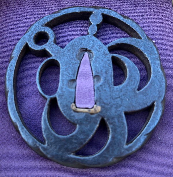

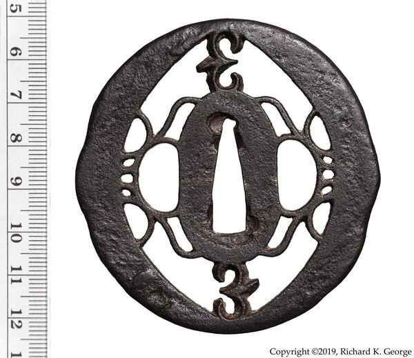

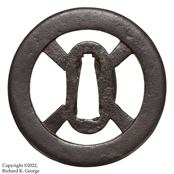

Iaido dude Posted December 29, 2024 Report Posted December 29, 2024 Here are two study pieces. Are they Kanayama, Ono, or Yagyu or later Edo pieces? https://www.jauce.com/auction/h1164546266 https://www.jauce.com/auction/g1165325614 Quote

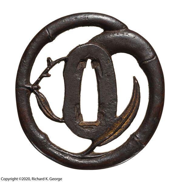

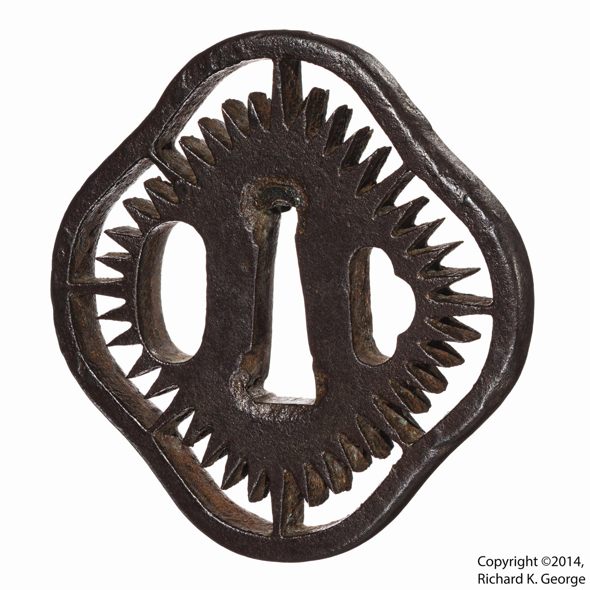

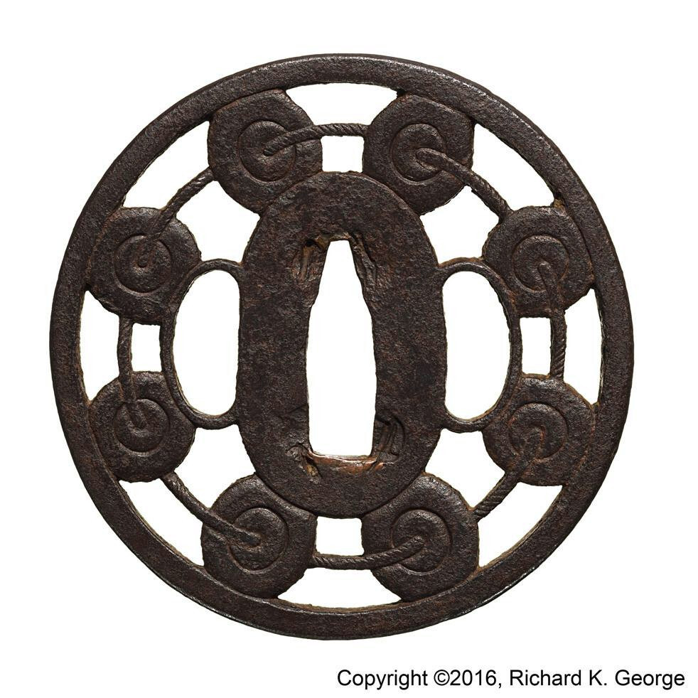

Tsuba gardener Posted December 29, 2024 Report Posted December 29, 2024 On 12/26/2024 at 5:59 PM, rkg said: Curran, I've always liked that theme EDIT: Those are very nice pieces. thanks for sharing! Here's a few Ohno as per your request, plus a couple that have been called Kanayama, owari, etc as well as Ohno... gear (tokei) theme: sunrise (hi no de) theme: Bamboo (take) theme: Riceball, head bag (kubi tsunagi), etc. theme (I don't know if the board member that purchased this still has it, but if he wants to comment on whether the NB thought this was a Ohno, please do...) This one Is a head scratcher. I've seen extremely similar (in terms of both theme and workmanship) binned as Ohno, Owari, and Kanayama. Make of it what you will: And finally, this was labeled as being an Ohno by the seller, but the general consensus is that it should be binned as an owari tsuba, so... Best, rkg (Richard George) Expand Hi Richard, I have a similar design to the rice ball/ headbang tsuba which l posted a while back. Your design is shown in Haynes catalogue number 19 and described as a Yagua design Robert was shown my tsuba and described it as ko-Shoami. A member here stated it could relate to Raijin the thunder God. Quote
Iaido dude Posted December 29, 2024 Report Posted December 29, 2024 Yagyu from page 94 "Owari To Mikawa No Tanko." 1 Quote
Winchester Posted December 29, 2024 Report Posted December 29, 2024 Hi Steve Hsu. The first tsuba you posted I'd like to see in person, but it is my opinion that it is Kanayama. I briefly looked at the price and it seems like a good value. While this is speculative, I feel fairly confident... Some of these designs were shared, so in my newbie opinion we need to look to other points that are indicative of the den or known style. For this diagnosis, I am trying to find a sort of kantei or matrix or create one, but haven't had luck nor started yet. Quote
Iaido dude Posted December 29, 2024 Report Posted December 29, 2024 Thanks, Brian. I agree. The wave and waterwheel motifs hint at Yagyu, but the symmetry is more consistent with Kanayama or Ohno. It is 7.1 mm thick, which is suggestive of Ohno, but I have seen thick Owari and Kanayama. There are two similar and famous Kanayama tsuba in Owari To Mikawa (left) that help to support it's likely Kanayama roots (right), although it still has a unique shape and may still reflect elements of Ohno/Yagyu influence. I just can't fully appreciate tekkotsu without the tsuba in hand; maybe a globular tekkosu at the left bottom between 6 and 7 o'clock. I think that these three are quite rare examples of mokko style Kanayama tsuba. 2 Quote
