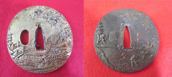

dwmc Posted 7 hours ago Report Posted 7 hours ago Recently purchased this Tsuba from Japanese dealer. I'm puzzled with the kanji, I believe it is Goto Chengjo with possibly a Hanayoshi kanji symbol (kao). Was there a Goto smith Chengjo or is this a Chinese copy ??? Thanks in advance, Dave M. Quote
Jesta Posted 6 hours ago Report Posted 6 hours ago I can’t comment on the mei, but the rest of the tsuba doesn’t look like Goto work. The nanako look cast rather than punched - take that with the appropriate amount of salt given that I can only look at the photo… This is an example of Goto school work with figures: https://www.bonhams....arly-18th-century-3/ 3 1 Quote
Spartancrest Posted 5 hours ago Report Posted 5 hours ago Sorry it is mass produced, they can come in several coloured finishes and also a "daisho" pair is available. I will try and find some other examples for you. 2 1 Quote
dwmc Posted 5 hours ago Author Report Posted 5 hours ago Thanks Justyn and Dale. Agree, things just didn't seem right with the tsuba... 1 Quote

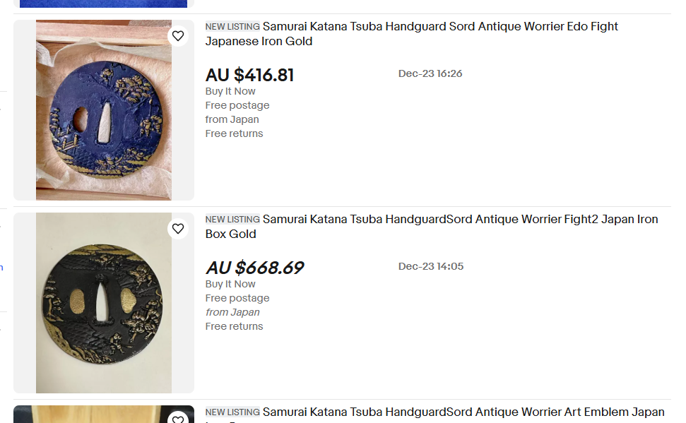

Spartancrest Posted 5 hours ago Report Posted 5 hours ago https://www.ebay.com/itm/404336982792 There are usually a few getting about at once - except when you start trying to find them! These also have a stamped in Ume/Ategane with applied colour - no way you could 'pop' them out. Hey you got a "free" box that is something 3 Quote
Spartancrest Posted 4 hours ago Report Posted 4 hours ago https://www.jauce.com/auction/p1166440099 Starting to find them now - some like this have no 'iroe' colour added. They were meant to deceive, the cast in tagane-ato is a good touch to look convincing. The matching 'Daisho' is here https://www.ebay.com/itm/226478001685 US $339.99 WTF!!!! Both hitsu are cast-in on this size. Tagane-ato are the same as the other guard [Lazy!] A particularly poor cast 'set' from some old ebay sales. [These would not have fooled anyone!] I really need to do a book on all these fakes - no good just being stuck in my head. 1 1 Quote
dwmc Posted 3 hours ago Author Report Posted 3 hours ago Excellent information Dale...Thanks much! 1 Quote
Spartancrest Posted 2 hours ago Report Posted 2 hours ago I can't help noticing there is a lot of confusion with the signature - Goto Tonojo Goto Hosono Goto Teijo Goto Chengjo Maybe Google translate has something to do with it? Just goes to prove never buy for the signature 1 Quote
