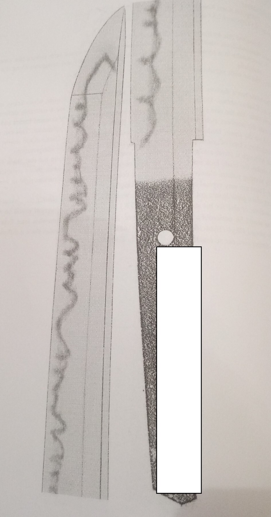

Jacques D. Posted December 22, 2024 Report Posted December 22, 2024 Wakizashi Nagasa = 54,5 cm Sori = 1,3 cm iori mune Jigane = very dense ko-itame with many ji nie and chikei. Hamon = as shown on oshigata. Nioiguchi is bright, wide and clear with much ko-nie. Isolated little tama on both side. Boshi as shown on oshigata. Answer next sunday 3 Quote
Nihonto student Posted December 25, 2024 Report Posted December 25, 2024 Spoiler Echizen no Kami Sukenao Quote
Alex A Posted December 25, 2024 Report Posted December 25, 2024 Purely for fun and off top of head first thought (without seeing if i have matching image), Hizen Masahiro. Quote
Jacques D. Posted December 25, 2024 Author Report Posted December 25, 2024 Since it's Christmas and there are some who have difficulty reading a hamon I'll help you : Hamon is a Toran midare mixed with elements yahasu. Quote
Grevedk Posted December 25, 2024 Report Posted December 25, 2024 Wild and possibly very uneducated guess - Terukane. Happy Christmas to all. /Soeren Quote
Natichu Posted December 25, 2024 Report Posted December 25, 2024 Wild and definitely uneducated guess: Echizen no Sukehiro (second generation, pages 1001-1002 in Markus Sesko's "Swordsmiths of Japan"). As a complete beginner, I just wanted to say thank you to Jacques for posting these and getting the conversations going. Even though I will only rarely be participating, I will definitely be lurking and appreciate the effort that goes into these. Quote
Jussi Ekholm Posted December 26, 2024 Report Posted December 26, 2024 Without books I would not have been able to go for this guess but I would have been in the direction. Christmas hint by Jacques was also very helpful. Spoiler 越後守包貞 - Echigo no Kami Kanesada Quote
Benjamin Posted December 26, 2024 Report Posted December 26, 2024 probably wrong but here's my try : Spoiler Echizen no kami Sukehiro for the toran midare hamon and the bright nioiguchi with a few question - despite the lack of Osaka yakidashi, but I guess it's no mandatory? - I'm puzzled by the boshi that should have a longer kaeri for Sukehiro - How to make a difference with his pupil Omi non kami Sukenao? the sori? kanbun shape? And thank you for the kantei Jacques. For now it's a very interesting exercise whereas I also used books to make my try. Quote

Jacques D. Posted December 29, 2024 Author Report Posted December 29, 2024 Dog is fine kantei answer : ECHIGO NO KAMI KANESADA. For those who are right, can you say which generation and why ? 2 Quote

Okan Posted December 29, 2024 Report Posted December 29, 2024 2 hours ago, Jacques D. said: Dog is fine kantei answer : ECHIGO NO KAMI KANESADA. For those who are right, can you say which generation and why ? I can. But why? Get better soon! Quote
Jacques D. Posted December 29, 2024 Author Report Posted December 29, 2024 It's always interesting to know the motivation behind a choice. Quote
Natichu Posted December 29, 2024 Report Posted December 29, 2024 20 minutes ago, Okan said: I can. But why? Get better soon! It would certainly help us beginners to be able to follow the intellectual footprints of those who got it correct! 1 Quote
Okan Posted December 29, 2024 Report Posted December 29, 2024 31 minutes ago, Jacques D. said: It's always interesting to know the motivation behind a choice. 2nd gen. General shape of the hamon and Toran midare (I was going back and forth between Terukane and Sukehiro) 2 1 Quote
Jussi Ekholm Posted December 29, 2024 Report Posted December 29, 2024 Get well soon Jacques! I would have gone for Tsuda Sukehiro guess initially. I admit I am not at level where I could tell Ōsaka-shintō smiths apart from worksmanship, and most likely will never be as they don't intrest me that much. However as Jacques gave the extra hint I had to refresh my memory from encyclopedia to figure out what yahazu is. Seems like this detail is often seen on the 2nd generation Kanesada work, as well as his tōran hamon is slanting. Also it seems like the three gunome elements right below yokote are often seen in his work. I am often very puzzled by Japanese descriptive terminology, as katayama-midare elements in hamon are described being featured in his work. As there are many different styled mountains in the world I am trying to understand just what this "half-mountain" element means. If it is the very steep drop compared to more gradual slope? Things like bright nioiguchi, wide nioiguchi etc. I cannot really say Ōsaka-shinto smith differences from those extremely fine details. I do confess I am better with the picture and text kantei than I would be in real life kantei. They are quite different even though of course some same basics apply. My eye is just not trained for extremely small details, and most likely never will be. 3 1 Quote
