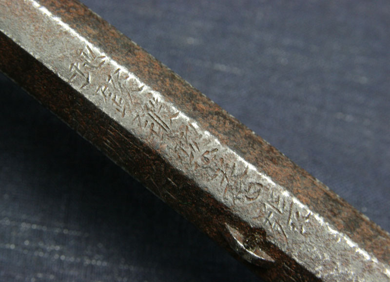

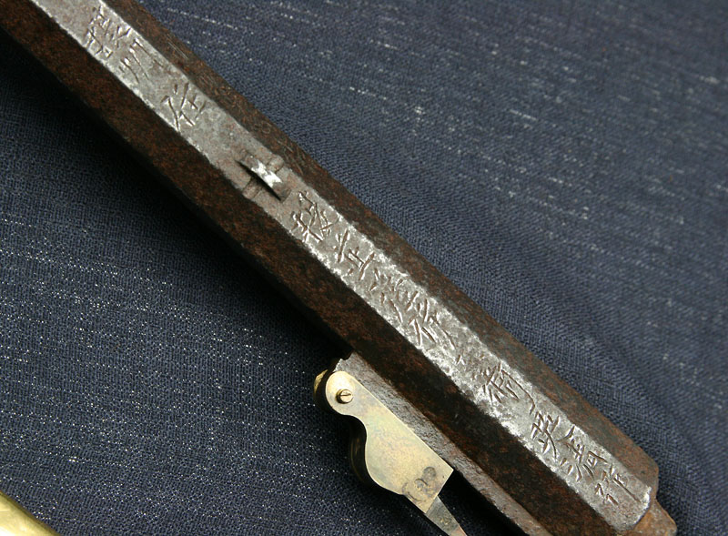

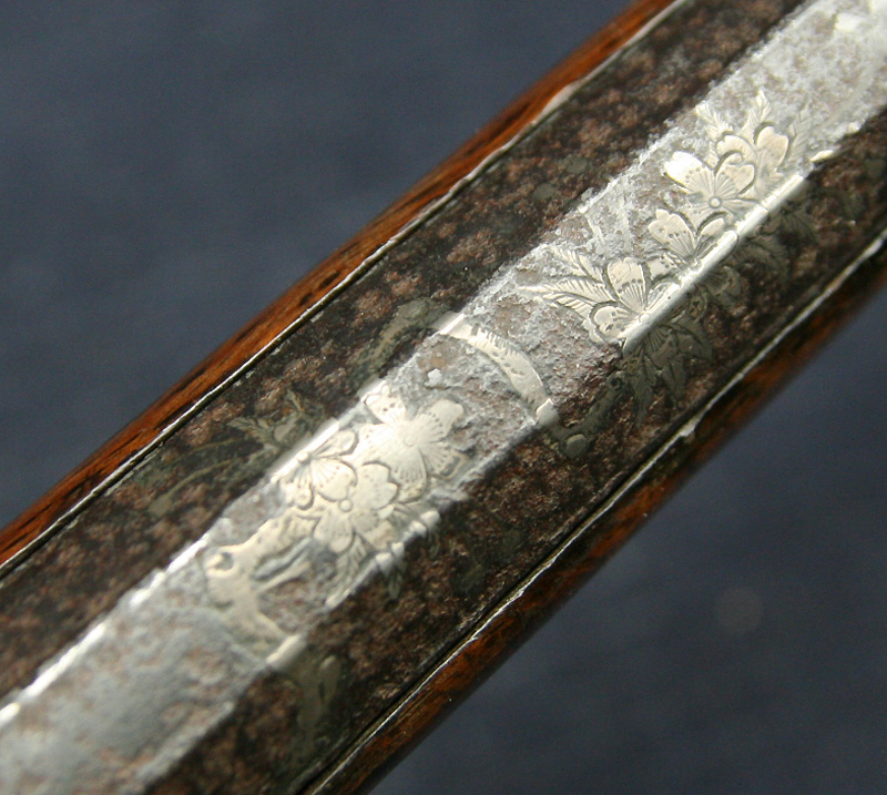

Dmitry Posted January 25, 2010 Author Report Posted January 25, 2010 I have successfully removed the barrel, and lightly cleaned the kanji area with some BreakFree CLP oil. The stock did not contain any writing on the inside, or else I was not successful in finding it. The silver Quote
Bugyotsuji Posted January 25, 2010 Report Posted January 25, 2010 That confirms Sakai at once. Enamiya gun. Gotta rush, but the Mei seems to say Sesshu ju Enamiya Saeimon(?) Hidekiyo Saku The other line is the method of barrel construction... Quote
Nobody Posted January 25, 2010 Report Posted January 25, 2010 The inscriptions may be; 摂州住 榎並屋伊兵衛英清作 – Sesshu ju, Enamiya Ihe’e Hidekiyo (reading?) saku 地鉄鍛惣巻張 (Jigane kitae, so-makibari) Quote
Bugyotsuji Posted January 25, 2010 Report Posted January 25, 2010 Koichi san, many thanks for the follow-up! PS Dmitry. If and when you start the search for an Ama-ooi, see if you can locate an original brass hinge pin for the pan lid. The one you have there looks like a later addition. (It's a minor detail, but it should really be of a hollow tubular construction, to take the wire support from the wet-weather umbrella.) Oh, and hard to tell from the pic, but do you have a Karuka (Sakujo) ramrod for it? They are quite easy to make if it's missing. Quote

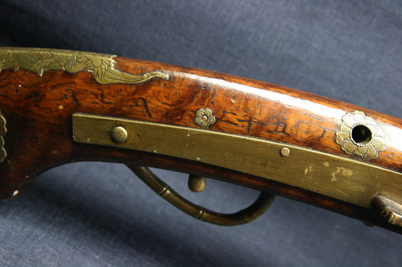

Dmitry Posted January 27, 2010 Author Report Posted January 27, 2010 Thank you very much indeed, gentlemen! Your help and expertise are quite impressive! I won't be restoring this piece, as I am but a temporary custodian of it. I think it is wiser to leave it the way it is now, so as not to spoil it. I find Japanese weapons fascinating, but it is not my area of collecting. I am also fond of looking at the old netsuke. I collect naval edged weapons from the age of fighting sail, and this [and one other tanegashima] were part of a large eclectic collection I have acquired some time ago. There are what appears to be some characters incised in the stock, unless I am seeing things. Also note the name DOZIER lightly scratched in the lock plate. Probably a bring-back from WWII... Quote
Bugyotsuji Posted January 27, 2010 Report Posted January 27, 2010 Numbers on a stock can mean various things, but the most common goes back to 1872 when the Meiji governement mandated a registration of all guns in Japan. Depending on the Prefecture, the way of stamping/inserting/branding the numbers was very different. I think I can see 八十八on the left, and then 二千五?... on the right. This registration was repeated several times over succeeding years. Quote
