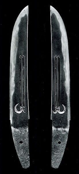

Jacques Posted January 27, 2010 Report Posted January 27, 2010 Hi Jean, Nagasa 54.5cm. Motokasane 7.1mm This one is surprising too: Nagasa 40cm Motohaba 38.48mm Quote
Jean Posted January 27, 2010 Report Posted January 27, 2010 Thanks Jacques, So this Aizu Kanesada is still the stouter, length compared to width and motokasane, A real chopper Quote
Jean Posted January 27, 2010 Report Posted January 27, 2010 Hi Jacques, I see your example is katakiriha, I lack references to see if there is any influence of the suguta on the width at the hamachi Quote

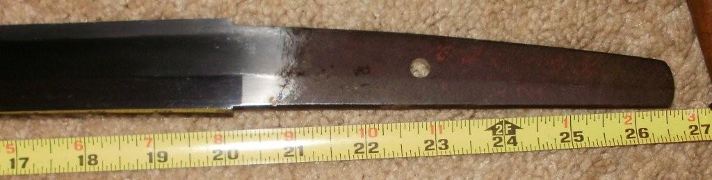

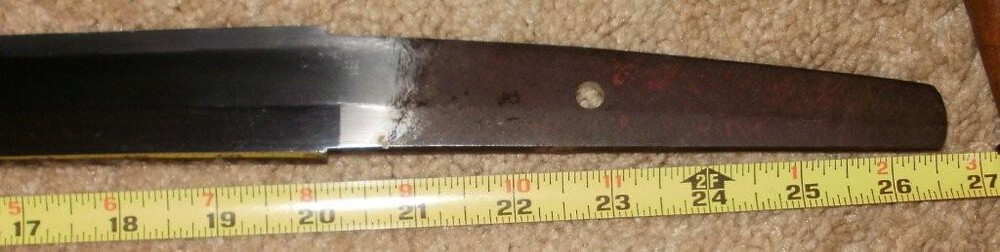

Jean Posted January 27, 2010 Report Posted January 27, 2010 Fantastic John. Now I would like to know the weird Monster Wakazashi measurements because as so far we know only its overall length. Katanako, can you please provide them Quote
Eric H Posted January 27, 2010 Report Posted January 27, 2010 Jean said: Now I would like to know the weird Monster Wakazashi measurements because as so far we know only its overall length. Hi Jean, In the first picture by Katanako the Katana tapers against the Kissaki, whereas the Monster Wakizashi contrarily tapers from the Kissaki to the Tsuka. Additionally the Hamon starts narrow and widens gradually forming a seemingly long yakidashi. As I mentioned the picture can be foxing, but I believe Motohaba and Sakihaba at the best are identical in measure, most likely the Monster Wakizashi has been repaired eventually. Another example of a very wide Motohaba in relation to the length is the Hocho Masamune. Eric Quote

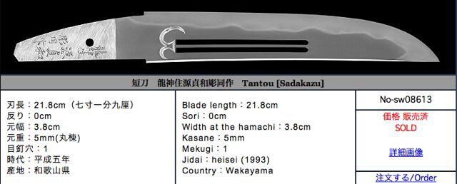

Jean Posted January 27, 2010 Report Posted January 27, 2010 Thanks Eric, I knew this one but the Motokasane is only 5mm, which is not outstanding for a tanto. It will be interesting to have Katanako's blade measurements. In fact, he should have provided them from the start and not the overall length of the blade which brings nothing, we cannot compare the Katana width with the wakizashi's one for lack of data. I have seen katana width (Hamachi) vaying from 25/26 mm to 35 mm ....... Quote

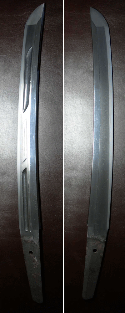

katanako Posted January 31, 2010 Author Report Posted January 31, 2010 OK Jean, I got around to taking a couple of pics of my weird Monster Wak. From your discussions, it has been obviously been honed down. If you have any more comments, please post them! Thank you all for the enlightenment! KATANAKO Quote
nagamaki - Franco Posted February 1, 2010 Report Posted February 1, 2010 Hi, looking at these new images I must admit that without seeing this wakizashi in hand it's difficult to tell exactly what is really going on here. Quote
Toryu2020 Posted February 1, 2010 Report Posted February 1, 2010 Jean, maybe you need to ask "How wide is it at the part where the blade begins?" (where the notches are) and "How wide is it at the tip?" (where the yokote line is) and "How thick is it at the base of the blade?" (where the notches in the tang are) and "How thick is it at the tip?" (where the yokote is and the blade flares sightly) Katana-ko sorry if this is putting it too simply, I agree with Jean, the other dimensions will help us get a real idea of the "Monster" status of your wakisashi... -tom Quote
