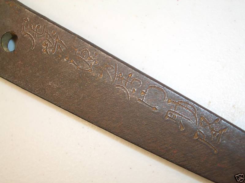

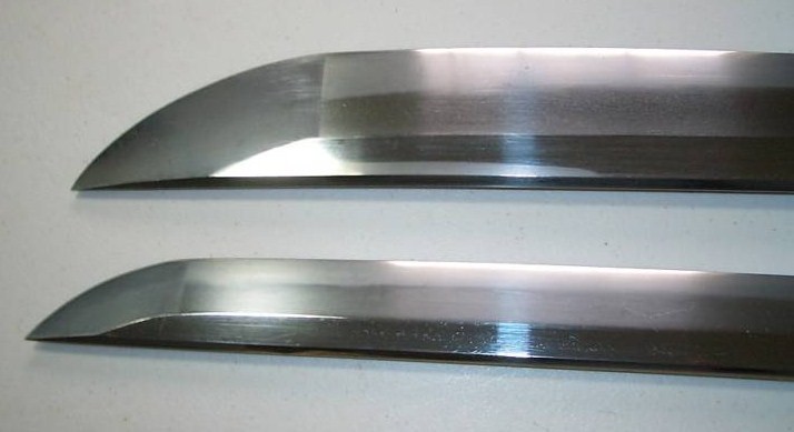

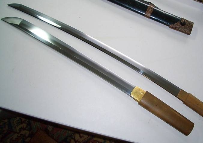

katanako Posted January 22, 2010 Report Posted January 22, 2010 I have a super sized "Monster" wakazashi and I would like to know exactly what it is. It has the kissaki and boshi of a katana, but it has a thick and wide blade! I will attempt to attach some pics here. The mei is signed OZAKI GENGOEMON FUJIWARA SUKETAKA, and in my 1981 Hawley book, it is under SUK525, circa 1790. It could be a gemei. The blade is 27 inches. Is it a Nagamaki? Perhaps a Nagamaki fashioned into a wak? I can't imagine a warrior using it for sword fighting. This blade was made for chopping/butchering, perhaps by a foot warrior chopping down a horseman in combat, or ??? How rare is this type of blade? It has a nice habaki and is in shirasaya. Would this blade originally have had a regular tsuka, or would it have been mounted on a pole like a Naginata? I've never run across something like this. Thank you very much. KATANAKO Quote
Death-Ace Posted January 22, 2010 Report Posted January 22, 2010 Perhaps it was used by George Foreman's Asian ancestors. :D Aren't Nagamakis generally widen towards the kissaki? Quote
Jacques Posted January 22, 2010 Report Posted January 22, 2010 Hi, 27 inches long is a katana not a wakizashi, however, the shape looks standard for a shinshinto blade, and at first sight it seems gimei. Quote
Bazza Posted January 22, 2010 Report Posted January 22, 2010 Jacques D. said: Hi, 27 inches long is a katana not a wakizashi, however, the shape looks standard for a shinshinto blade, and at first sight it seems gimei. Jacques, I think he means 27 inches overall, not nagasa. This reminds me of an 'eviscerator' Suketaka kowakizashi a friend of mine has. It would seem to support the notion that Suketaka occasionally produced "outlandish" blades (for want of a better name). I have some pictures somewhere, I think?? I'll have a look and put them up for the sake of the discussion. Bestests, BaZZa. Quote
pcfarrar Posted January 22, 2010 Report Posted January 22, 2010 The Satsuma schools made a lot of oversized wakizashi. I have one signed Sasshu ju Tadakane in crew gunto mounts. The kasane is over 1cm thick and the blade very wide. Quote

FlorianB Posted January 22, 2010 Report Posted January 22, 2010 Katanoko, please be so kind and specify the measurement of the blade (nagasa, mihaba, kasane). A large dimensioned blade isn't unusual for Shin-Shinto and without any proper description it is difficult to judge just by the pictures alone. In the first picture I even got the impression that the blade becomes broader towards the monouchi - THIS would be rather unusual. Some more pictures showing the hada and hamon would help,too, - I can see just a long kaeri, which indeed hints to Suketaka. Concerning the mei I've got my doubts, especially the third kanji from below looks curious, but I'll have to do some research. Florian Quote

Eric H Posted January 22, 2010 Report Posted January 22, 2010 It's nothing else but a clumsy heavily made Wakizashi and most likely as already mentioned intended to be carried by a Sumo-wrestler. Their attitude for oversized objects like Inro, Netsuke, Tabaccoire is well known. Easy to see that it is a gimei. Eric Quote

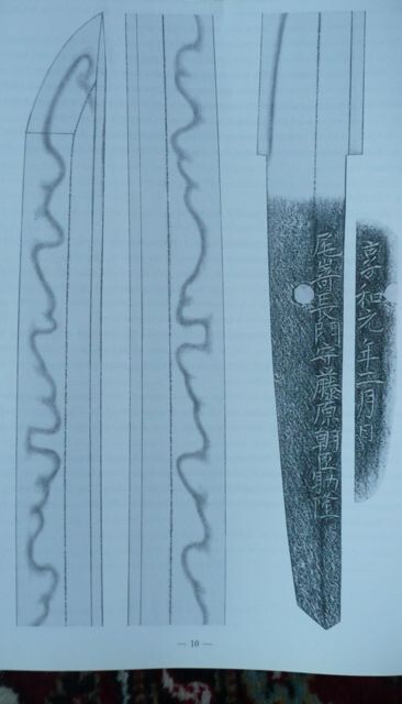

FlorianB Posted January 22, 2010 Report Posted January 22, 2010 Checking about two dozens of Ozaki Suketaka's mei by different resources I can confirm it's a gimei - and, alas, not even cleverly done. Eric's pictures display a grass style writing, Suketaka also inscribed his signatures with more formal kanji. However, this wakizashi signature seems to be an odd mixture of both. Florian Quote

Eric H Posted January 23, 2010 Report Posted January 23, 2010 george trotter said: "...it's a gimei...and not even cleverly done" suggests that there was no serious intent to deceive? A fake whatever kind is always made on purpose. This is undoubtedly an intentionally but poorly and unskilled executed mei. Aside this the expected workmanship of Ozaki Suketaka is not represented in this Wakizashi with straight hamon. I have never seen a shape like this becoming noticeably broader against the kissaki, assumed the pic doesn't baffle, lacking a harmonious shape. I could imagine that the blade has been mended due to a severe damage, thus loosing a large part of the original shape. This would also explain the difference in width of the yakiba. Ozaki Suketaka's workmanship shows the common characteristics of the Shinshinto time and his O-Toranba comes next to Sukehiro. The oshigata I have added is such an example. The "square" bottom lines between the waves is a typical trait he is known for. Eric Quote

nagamaki - Franco Posted January 25, 2010 Report Posted January 25, 2010 Hi, in regards to what appears in the image as a distorted shape to this "weird monster wakizashi", my impression, right or wrong, is that this blade might have suffered a chip in the ha a few inches up from the habaki at some point in time, and the polisher/owner simply decided to average out the chip in only a portion of the blade without raising the entire length of the ha as would normally be done to make it all even once again. Quote
