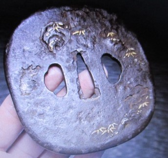

Dan tsuba Posted January 2, 2025 Author Report Posted January 2, 2025 Thanks Thomas, for your opinion about the outer shell of the tsuba being urushi lacquer. But in a previous post here I stated how I used a small sharp knife to try to cut a tiny piece of the covering off the tsuba. I couldn’t do it, and the blade did not even leave a scratch on the surface. Then I tried placing the tip of the blade under a small piece of the covering that was already chipped to see if I could remove a tiny piece for magnetic testing. Well, I couldn’t do that either! And if the covering was urushi, how could the craftsman mold in those pine needle motifs or place in the brass zogan? But let us say you are correct and the outside covering of the tsuba is urushi. Wouldn't that still be an alternative way to construct a tsuba (as the title of this thread suggests)?

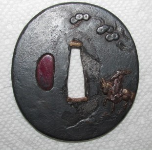

Dan tsuba Posted January 4, 2025 Author Report Posted January 4, 2025 So, I was just searching through eBay and found another tsuba that appears to be constructed the same way as my tsuba. It appears to have an inner core of metal and then an outer shell of metal (I don't think it is lacquer). I wonder how many other tsuba may have been constructed in this way? Pictures are attached. Onward!

Brian Posted January 4, 2025 Report Posted January 4, 2025 18 minutes ago, Dan tsuba said: I wonder how many other tsuba may have been constructed in this way? None. 2 2
Alex A Posted January 4, 2025 Report Posted January 4, 2025 Would suggest water has got into pores, corroded, frozen, expanded and pushed an hole in the surface. Like when your shocks on your car always brake in winter. Its what iron does. 1
Dan tsuba Posted January 4, 2025 Author Report Posted January 4, 2025 Hi Alex! Thanks for your thoughts about the piece and that picture of the dumbbell. You said- "No outer construction coating method as far as im aware, just one of those things." Now, I am only saying this to try and figure out if there actually was an outer shell applied over an inner metal core and what that possible outer metal shell could be constructed of. Is that dumbbell of yours made of steel or cast iron? I know. You are probably saying "oh no, here he goes again"! But I do find this possible alternative way of constructing a tsuba very interesting! Thanks!
Steves87 Posted January 4, 2025 Report Posted January 4, 2025 Guys, that is clearly missing inlay... they are in the shape of shi shi !! There is no alternate construction there, just Suemon-zogan that has been lost 5 1
Steves87 Posted January 4, 2025 Report Posted January 4, 2025 (edited) Here is an example (thereabouts) of how it should look with the two shi shi Edited January 4, 2025 by Steves87 2 1
Alex A Posted January 4, 2025 Report Posted January 4, 2025 Stephen, did consider that, good point. Dan. They are cast and were sat in an outdoor brick toilet at the bottom of my Grand folks garden for many years. They saw many variations in temp and conditions, as old tsuba do. Funnily enough, bumped into a video on youtube about how Japanese houses don't have central heating, apart from one small part of Japan. The guy was saying the houses in old times were murder in winter to keep warm. So if you have old iron like tsuba knocking about, you have to think about what they might of been through. Personally, i think your overthinking it.
Dan tsuba Posted January 4, 2025 Author Report Posted January 4, 2025 So, Stephen made a good point when he stated- “Guys, that is clearly missing inlay... they are in the shape of shi shi !! There is no alternate construction there, just Suemon-zogan that has been lost” So, that got me thinking. If that tsuba (first picture shown below) is not showing an alternate construction and it is just missing inlay, then what is the explanation for the possible alternate construction shown of the other tsuba (second picture shown) where there could not have been any inlay placed around the nakago-ana? Onward!
Dan tsuba Posted January 4, 2025 Author Report Posted January 4, 2025 So, I was thinking again! And Derek (from his post above) can’t stop me from doing that, although he did ask nicely- ha, ha, ha, ha, etc (I crack myself up!). I have included pictures below of 3 of my hand forged tsuba that have missing zogan. The area of the missing zogan on those hand forged tsuba does not look anything like the missing zogan area on the tsuba that I believe has a metal core and a metal shell covering that core (picture of that tsuba again shown in the last picture below). Onward (yes, and I am still thinking!).
Spartancrest Posted January 4, 2025 Report Posted January 4, 2025 7 hours ago, Steves87 said: just Suemon-zogan that has been lost And it looks like it is not far from losing a boulder as well 2
Dereks Posted January 4, 2025 Report Posted January 4, 2025 Dan, See the circled area, that is the exact layer with your first tsuba. On this example, it is corroded nicely, so you don't see the shiny metal. 1 1

Dereks Posted January 4, 2025 Report Posted January 4, 2025 I don't need to think, I can see. Your question was already answered on the first comment but I don't understand why you can't accept it. Working on a new book maybe? Best. 2
Dan tsuba Posted January 4, 2025 Author Report Posted January 4, 2025 O.K. Derek. The gloves are off! I tried being nice. But you won't have anything to do with that! Do you really want to go there with me? Can't you see that the picture you posted are tagane-ato punch marks made in the tsuba that have been further corroded. There are none so blind as those that will not see. Your sarcasm is immature. Why don't you refer to the other pictures I posted? Comment on them. Best. 1 2
Dereks Posted January 4, 2025 Report Posted January 4, 2025 That further corroded area, that layer, is the same one on your first tsuba! That is the answer to your question. Here, I'll put X on them now. It is not molten iron. Just the upper crust flaked off!

Dereks Posted January 4, 2025 Report Posted January 4, 2025 There were different ways to forge a tsuba. Some of them have 2-3 layers, with the upper crust being the top layer. Some not folded. Some inlays are applied on a heated plate so it affects upper layer as well. Two of the tsuba with missing zogan are applied to a prepared area. The other one, with the missing shi shi, is completely different. 1
Dan tsuba Posted January 4, 2025 Author Report Posted January 4, 2025 Hey Derek. Good information, thanks. You stated- "The other one, with the missing shi shi, is completely different." So how do you think that tsuba was made? Do these tsuba look hand forged to you?
Dereks Posted January 4, 2025 Report Posted January 4, 2025 Just now, Dan tsuba said: Hey Derek. Good information, thanks. But do these tsuba look hand forged to you? Yes!
