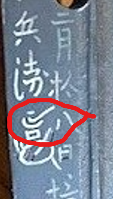

Bruce Pennington Posted Tuesday at 03:51 PM Report Posted Tuesday at 03:51 PM 8 minutes ago, SteveM said: December 18th. August, It actually says both December and August? Also, if you don't mind, I've seen this marking on a couple of cutter mei. Can you tell me what it means (I think I've asked that before, but too much water under that bridge!) Quote
SteveM Posted Tuesday at 03:57 PM Report Posted Tuesday at 03:57 PM One could be the date of the test, and the other the date the inscription was added. Unsure. (my reading of 梅津 could be incorrect as well, or the reading could be correct, but the interpretation of "August" "February" could be incorrect"). 梅津 is a poetic name for August February, but... it is a bit rare. Edit: Oops, correction, 梅津 is a poetic name for February. I'll leave the spoiler as is (with the error untouched) Edit #2: Had to fix a typo in a name. I should also add that the name of the cutter is not included in Guido Schiller's list of known cutters. Unknown, or known at the time, but just rare to see on swords.... who knows. I should keep track of these "unknown" cutters (who have very confident signatures) and create an appendix to Guido's list. 2 1 Quote

Bruce Pennington Posted Tuesday at 04:01 PM Report Posted Tuesday at 04:01 PM 3 minutes ago, SteveM said: . 梅津 is a poetic name for August, but... it is a bit rare. Thanks Steve! What about that kanji I circled? Quote
SteveM Posted Tuesday at 04:05 PM Report Posted Tuesday at 04:05 PM I'm sure that's a monogram (kaō) and so it would be unique to the author. It's hard to tell what kanji the author stylized it from. Usually the kaō is made from a part, or parts, of the family name, but could be some variation of 正 (true, correct) or 眞 (also true, truth, sincere). Quote

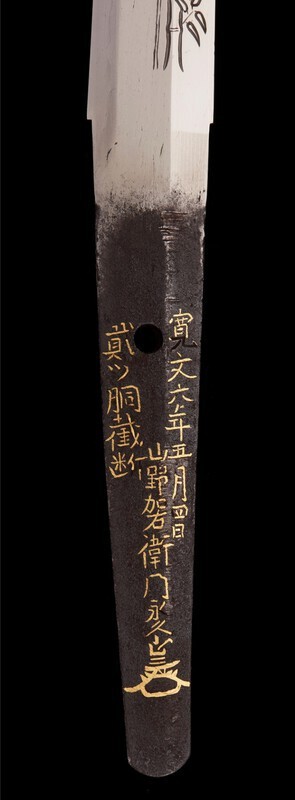

Bruce Pennington Posted Tuesday at 04:11 PM Report Posted Tuesday at 04:11 PM 4 minutes ago, SteveM said: variation of 正 (true, correct) or 眞 (also true, truth, sincere). Maybe like our "Certified" marks and labels, today. Nagahisa used it on his too, slightly different version of it, though: 2 Quote
