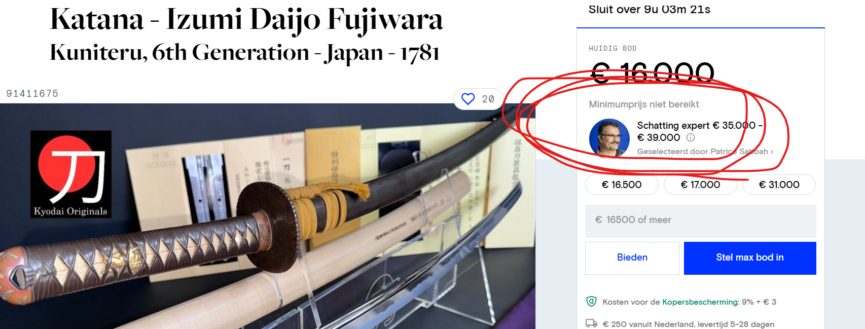

treverorum Posted Saturday at 11:25 PM Report Posted Saturday at 11:25 PM As a newcomer to sword collecting who was excited to purchase my first katana, I was shocked to discover that a katana being sold as authentic is actually a fake with altered inscriptions and papers. The katana in question is currently listed on Catawiki, and the store selling it is Kyodai Originals: https://kyodaiorigin...k-tokubetsu-hozon-2/. However, the katana and its NBTHK Tokubetsu Hozon certificate have been tampered with. Here’s the evidence: 1. The gold inscription on the tang (nakago), which claims a “4-body test cut” (四ッ胴切落), has been added fraudulently. This modification does not appear on the original tang in earlier listings. 2. The original NBTHK Tokubetsu Hozon papers for this katana can be found on the Samurai Museum website: Samurai Museum Original Listing. When comparing the certificates and identification numbers, it’s clear they are the same: • Samurai Museum Certificate: Certificate Image • Kyodai Originals Certificate: Altered Certificate Image 3. The identification numbers on the certificates match exactly, yet the Kyodai Originals listing includes the fraudulent gold-inscribed cutting test (四ッ胴切落), which was not on the original tang or certificate. As someone new to sword collecting, this discovery was disheartening. I was excited to acquire a first katana and trusted the listings and sellers. This experience taught me the importance of verifying every detail, especially when dealing with high-value items like Japanese swords. Any idea how to proceed with this so something like this will have consequences? I already contacted Catawiki about it, but I am pretty sure you guys have more experience with this. Also, how on earth can I trust any future listing of any other katana? 3 2 5 1 Quote
PNSSHOGUN Posted Saturday at 11:42 PM Report Posted Saturday at 11:42 PM Extraordinary, the inlay work is very crude. Also note the difference in photography style between the original and altered paper. This seller often has swords bought from Japanese dealers, then re-listed with huge markups. 2 Quote

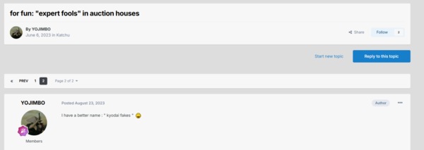

YOJIMBO Posted Sunday at 10:19 AM Report Posted Sunday at 10:19 AM whoever buys there deserves it. catawiki, ebay, .....all s**t. 1 Quote
YOJIMBO Posted Sunday at 11:05 AM Report Posted Sunday at 11:05 AM if you see this expert guy anywhere - run i think there is collusion between kyodai and this expert Quote
Lewis B Posted Sunday at 12:04 PM Report Posted Sunday at 12:04 PM 1 hour ago, YOJIMBO said: if you see this expert guy anywhere - run i think there is collusion between kyodai and this expert That is Patrice Sabbah. He's a well known sword polisher from France, who I met at the Japan Art Expo last summer at his booth. Talk about trashing a reputation. Catawiki is becoming about as reliable as Craigslist and Gumtree with buyer protections to match. AVOID. Quote

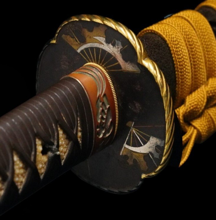

Shugyosha Posted Sunday at 12:21 PM Report Posted Sunday at 12:21 PM The tsuba from the fittings in the Samurai Museum listing has been swapped too and probably changed for a cheaper one (albeit papered). If you can't trust NBTHK papers, there really isn't a lot you can trust any more. 1 Quote
Lewis B Posted Sunday at 12:27 PM Report Posted Sunday at 12:27 PM Kyodai have taken down the images. The plot thickens . Reported to Catawiki so curious how they respond. Top bid is currently 16K Euro. Update. Catawiki removed the listing. Great first post OP and welcome to the NMB. Saved an unsuspecting buyer from being scammed. I will add Kyodai to SupeinNihonto on my list of EU businesses to avoid. Sabbah has also earned a red flag. 4 Quote

Tensho Posted Sunday at 06:31 PM Report Posted Sunday at 06:31 PM 6 hours ago, Shugyosha said: The tsuba from the fittings in the Samurai Museum listing has been swapped too and probably changed for a cheaper one (albeit papered). Yup.. Looks like doubled up the seppa too and removed the "possibly" gold foiled ones altogether. Quote
