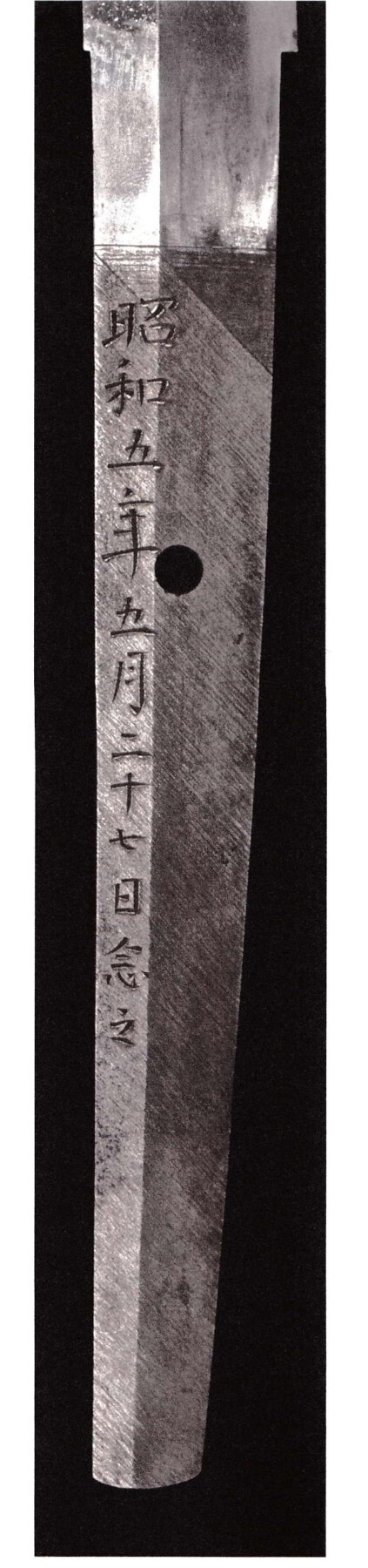

I have not run into this ending on a date before.  What would the Japanese pronunciation and English translation of 𫝹之?
表 omote: 以軍艦三笠砲鋼 秀明 motte gunkan Mikasa hō hagane Hideaki.
裏 ura: 昭和五年五月二十七日𫝹之.
拵え Koshirae: 白鞘 shirasaya.

Was hoping to get a shot of the actual inscription. Presumably it means "in commemoration of", but I can find no other reference to this kind of inscription, and don't know how you would pronounce it. Maybe (in kanbun style)
kore de (date) wo omotte. (With this, we commemorate/remember the date).
But... I suggest this with low confidence.
I had the same idea, Steve!
“念” derives from the kanji Thomas has postet and can be read “nen” or “omu” (which can be translated as: sense, idea, thought, feeling, desire, concern, attention, care, to remember…etc)
“之” ,on the other hand, can also mean “this point in time”.
So the suggestion Steve made is worth to consider, I think. Although I couldn’t find another example as well….
 Motte gunkan Mikasa hō hagane Hideaki      以軍艦三笠砲鋼 秀明.
 昭和五年五月二十七日𫝹之    May 27, 1930 this year.
The concept was:     It reads "nenn kore" which is something like "this memory"  "this memorable date".   ......which was the 25th anniversary of the Battle of Tsushima  in which the battleship Mikasa 三笠, was damaged and the main gun destroyed.   The steel from the gun barrel was used to make memorial   250 +  long swords and 900+ dirks   between 1928 and 1932.....and this was one   Hideaki changed his name in 1932 to Toshihide

The date inscription under discussion is coming from page 87 of Modern Japanese Swords.  The picture below shows the ura 裏 side of the katana-mei 刀銘.  It also has a horimono of 皇國興廃在此一戦.

After consulting with some of the translators, I am going to use the following translation.
昭和五年五月二十七日念之 = 1930-0527 kore o omou/omotte = in remembrance/commemoration/memory of 27 May 1930.
