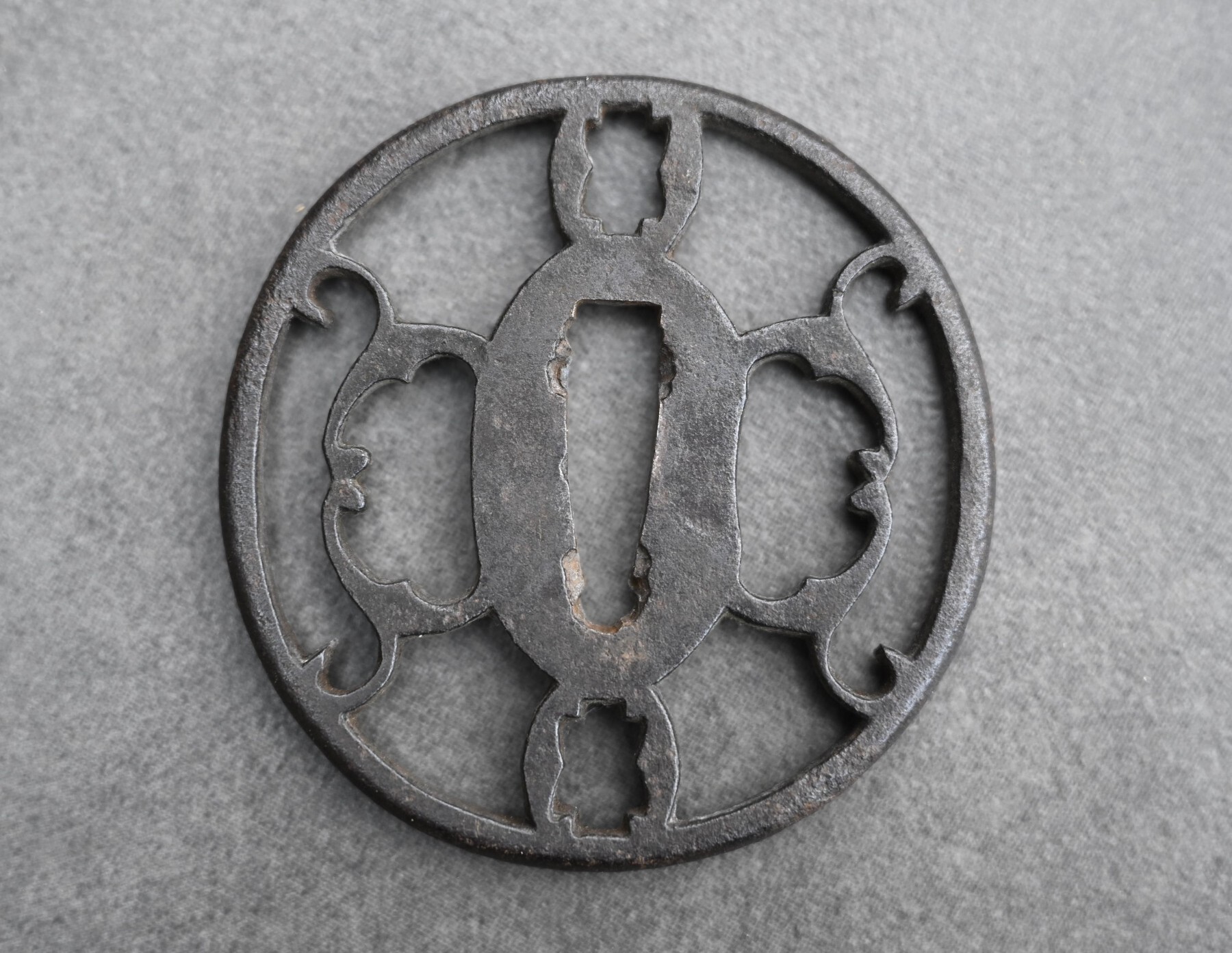

ThomasP Posted December 13, 2024 Report Posted December 13, 2024 Hi everyone I am looking for help identifying this iron Tsuba regarding, age, school, style, etc. Any information or resources would be greatly appreciated. Purchased in Kyoto but didn't receive much info about it. No markings 70,8mm x 69,2mm x 5,7mm Or even a copy? Thank you 1 Quote
Dan tsuba Posted December 13, 2024 Report Posted December 13, 2024 Hi Thomas! Your tsuba appears to me to be an authentic hand forged tsuba, not a fake. Age is difficult to ascertain. Your tsuba is not rusted so it was taken well care of or is a more recent tsuba (made in the later Eco period?). I don't know! I also don’t know about the school; I am sure other members will tell you about it. Oh, and when photographing and displaying tsuba, you should photograph the tsuba so the more pointed side of the nakago-ana (center triangular tang slot) is facing upwards. Onward! 1 1 Quote
Shugyosha Posted December 13, 2024 Report Posted December 13, 2024 Hi Thomas, I'd take a guess at Owari school, Edo period. I can't see anything to suggest a copy, it looks like it has been mounted and I don't see evidence of it being cast plus there's some tekkotsu on the mimi which doesn't suggest modern iron. There's a discussion of the possible motifs in this thread, a little way down from the top. 1 1 Quote

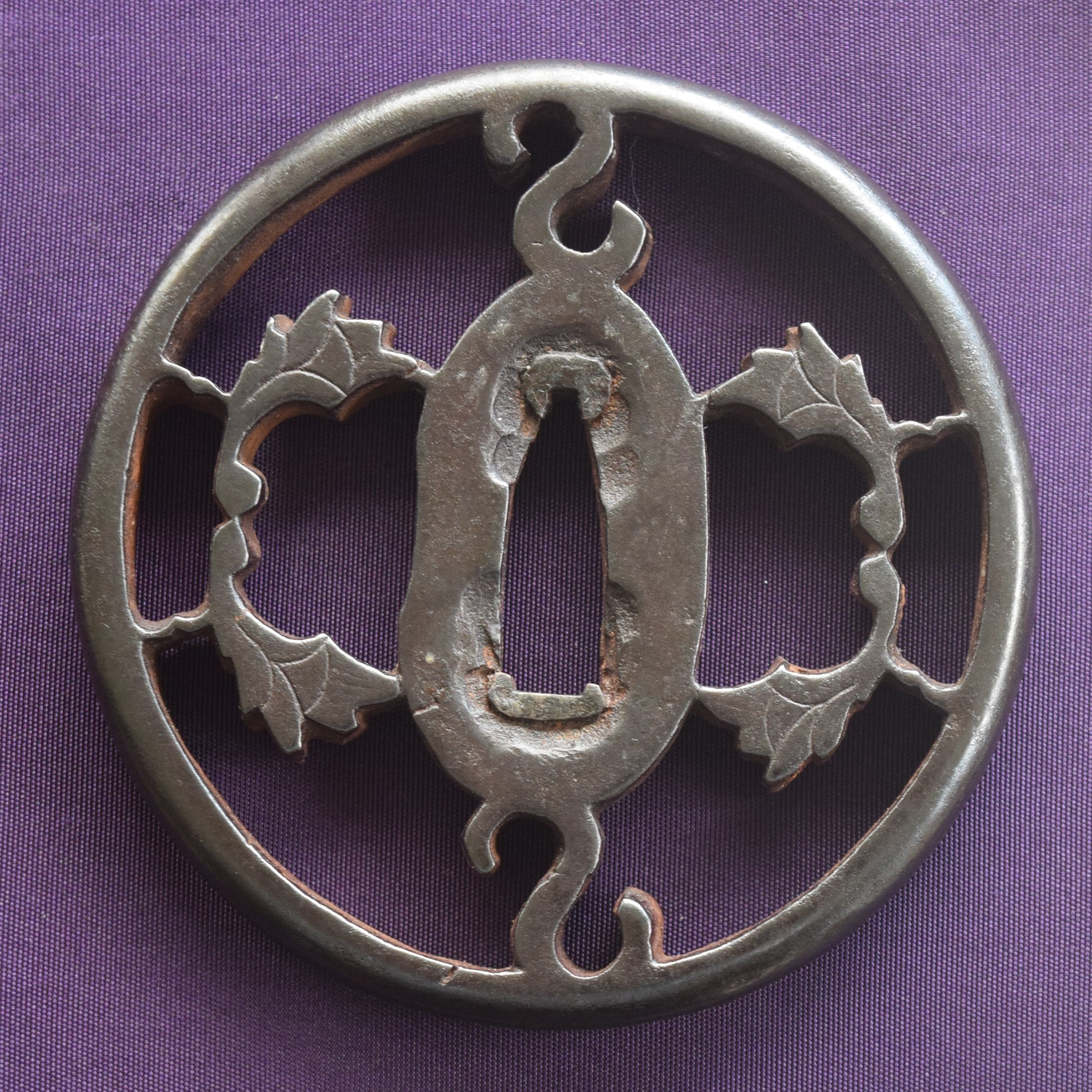

Spartancrest Posted December 14, 2024 Report Posted December 14, 2024 An Owari of a very similar design https://www.papilio....e-auction/5/item/206 Myōga [ginger plant] a very popular design. Many slight variations. https://www.seiyudo....10717.htm#movepoint1 https://bushidojapan...ith_Myoga_Motif.html The Akasaka school and others also used the Myōga motif in their sukashi designs. 1 1 1 Quote

GRC Posted December 15, 2024 Report Posted December 15, 2024 If I had to put a label on that one, I would have to agree with John J's Owari style (which is a a whole province by the way, not a singular school), can't pin down a date for certain, but the surface and edges look a little too "refined" to be an early one, so it's likely an Edo period piece (and who knows when in that 400 year period ). As for the S shape... I would suggest it could be a classic blacksmith's "S hook" for hanging a tea kettle on a chain over hot coals. The S motif is not something that is seen too often on sukashi tsuba. 2 1 Quote
