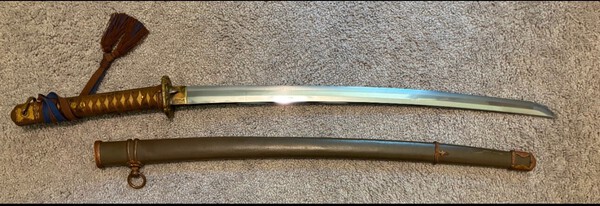

Swords Posted December 13, 2024 Report Posted December 13, 2024 I have a question regarding the weight of these 2 swords Both weight exactly the same Yet MORINOBU is longer and thicker than Kanenobu yet it weighs the same as Kanenobu is it because Tamahagane was used or maybe was folded more? Quote

Swords Posted December 13, 2024 Author Report Posted December 13, 2024 What I do is stand on the scale get my weight than hold the sword and subtract the difference Both swords were the same weight The longer sword is wider and thicker that’s what’s confusing Maybe John’s right about about the density of steels ? Because one is star stamped the adding of tamahagane But shouldn’t matter because both swords should have tamahagane I may be wrong if I remember after 1943 the star wasn’t used So that shouldn’t matter I think is unusual they both was exactly the same one being thicker and longer yet it’s the same weight Quote

Swords Posted December 13, 2024 Author Report Posted December 13, 2024 I don’t have a gram scale I’m thinking it’s probably a denser steel which leaves me with another question Is denser steel better ? I’m thinking probably stronger I understand the variables fittings scabbard scale and other things But thanks for all opinions They are cool swords Me favorites I will try and get some measurements I’ll get some pictures and post them Thanks 😊 Steve 1 Quote

Swords Posted December 14, 2024 Author Report Posted December 14, 2024 I am going to strip the swords as pointed out and weigh them separately I will also take photos and post them for John Thanks Steve 1 Quote
Swords Posted December 14, 2024 Author Report Posted December 14, 2024 Bruce I hope these photos are enough Quote
Bruce Pennington Posted December 14, 2024 Report Posted December 14, 2024 On 12/14/2024 at 8:45 PM, Swords said: I hope these photos are enough Expand Thanks Steven! I see we have that one in the charts - Aug '43. Trystan brought it to our attention a while back. Quote
