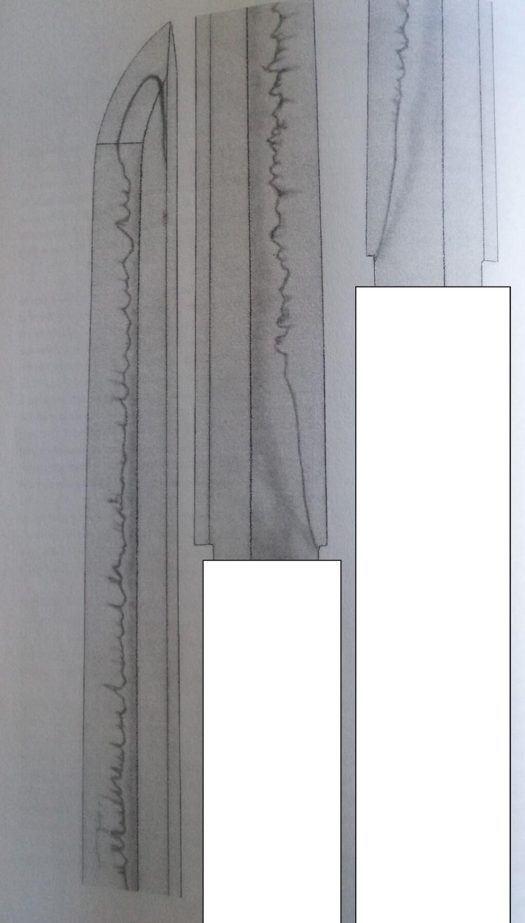

Jacques Posted December 13, 2024 Report Posted December 13, 2024 Nagasa = 64.8 cm Sori = 0.6 cm Kitae = Standing out ko-itame with a strong ji nie and a midare utsuri. Hamon = Nioideki compact and clear. Boshi = Suguha cho with hakikake along the rather pointed kaeri on the ura side Quote

Jacques Posted December 13, 2024 Author Report Posted December 13, 2024 It's Yasuhiro The sugata and yakidashi pointed to a Shinto blade, but the midare utsuri could lead people to think of a Bizen koto (that's why I hid all the nakago). The point that disqualifies Koto Bizen is the boshi, which should have been in accordance with the hamon as yakidashi is not compulsory. Nidai Sukehiro never produced an utsuri, the shodai did from time to time, but it's a pale bo utsuri that's hard to see, and katana by this smith are extremely rare. Nidai Sukehiro's yakidashi is shorter and the hamon often starts under the ha machi. In any case, bravo to those who dared to take the plunge and found the solution. ps Alex really doesn't know me very well... 2 2 Quote
