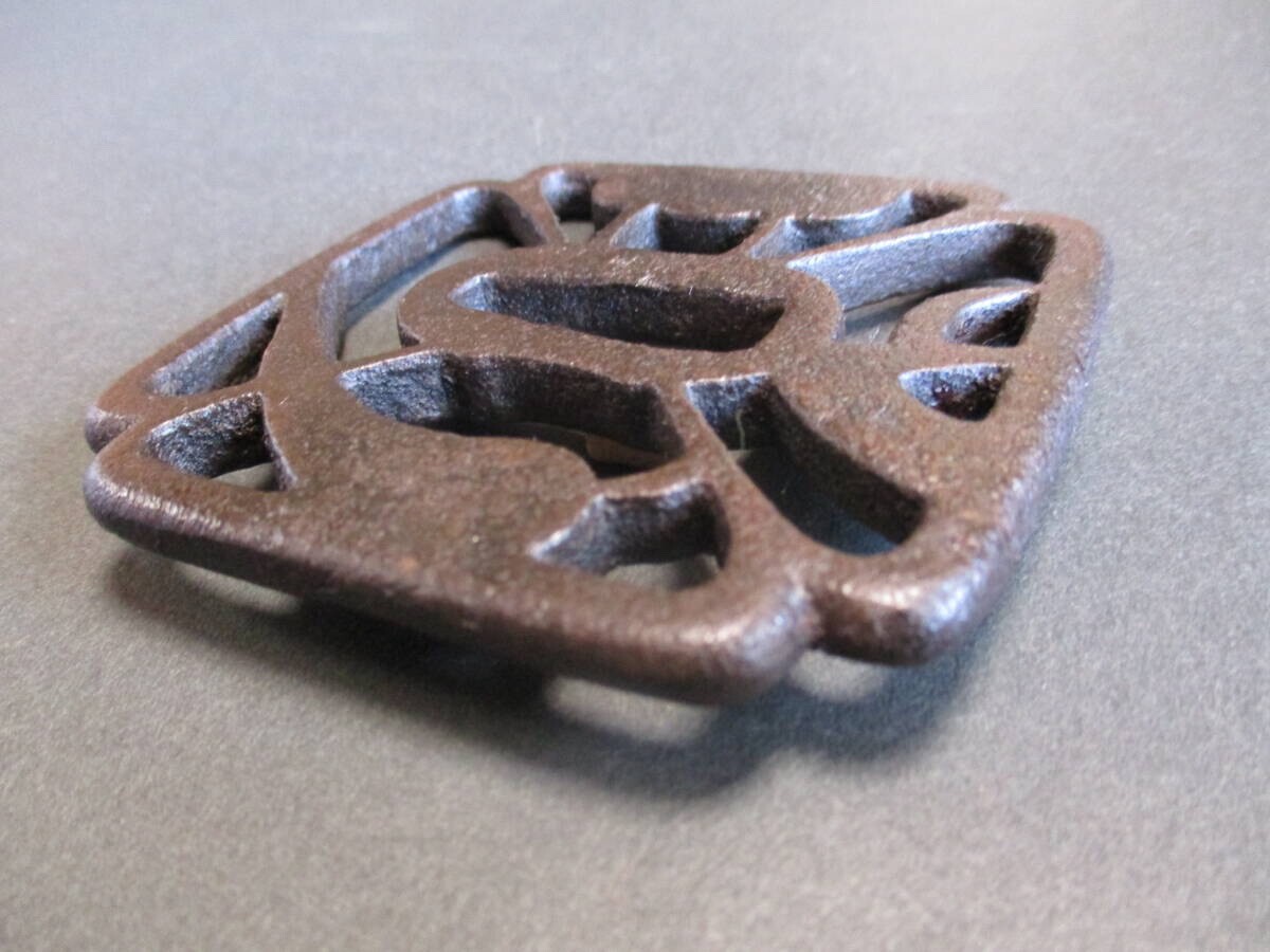

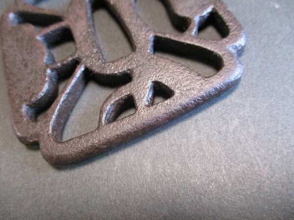

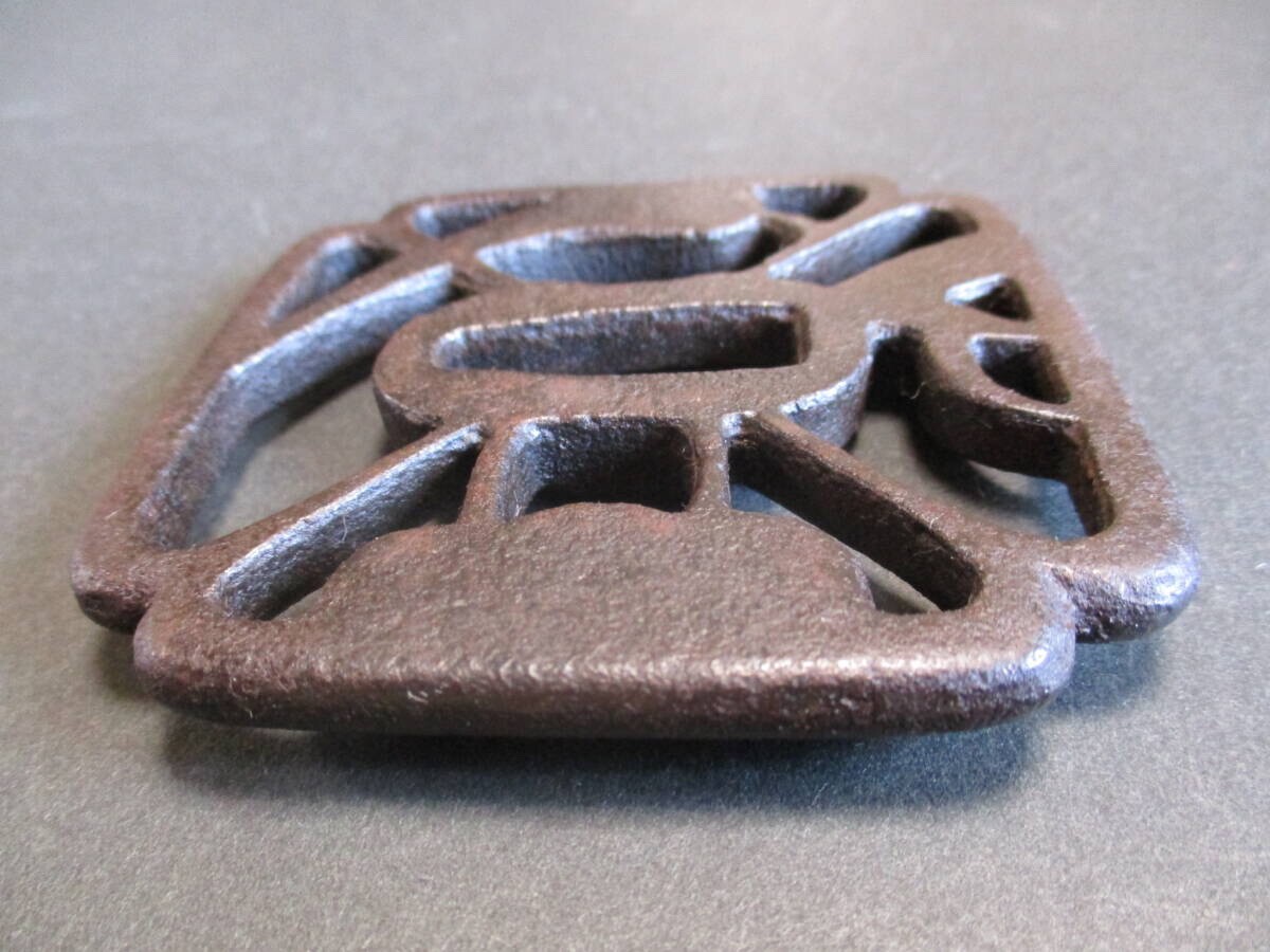

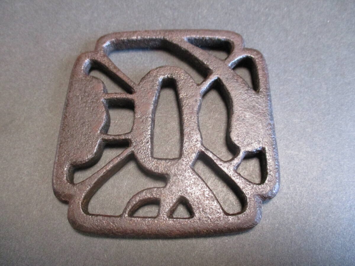

KungFooey Posted December 12, 2024 Report Posted December 12, 2024 No medical conditions in the answers please! 😉 I buy what I like just because I like it - but it sure does help when I get lucky in auction and pay peanuts. And I did just that yesterday! A nice big, square, iron tsuba - 7.5cm × 7.4cm × 0.6cm thick. Cause for concern, maybe: Rough iron surface or plain ol' corrosion? No sign of ever being mounted (punch marks). Iron bones on one side or a casting seam? 😳 So, please tell me what you think I've bought this time folks (and feel free to let me have it straight - I'm a big girl). Thanks again! Dee 1 Quote
Spartancrest Posted December 12, 2024 Report Posted December 12, 2024 Would you say the image colour is accurate? As you point out it doesn't look to have been fitted to a blade [unless it was not necessary to "tighten the fit" with tagane.] Well to my eyes it looks sandblasted clean, which would contribute to the rounded edges of the nakago-ana and the general pitted look. But possibly cast - though there is little direct evidence, just a few questionable spots. You could do the "drop test" but that is rather drastic. If you didn't spend too much it is always worth a gamble - alloy fakes are selling for stupid high prices, so an iron guard that may have been "over cleaned" and appeals to you is a no brainer. I presume you don't have it in hand just yet? There is usually "something" that speaks to you when you hold one and can really see it in good light. Good luck 1 Quote

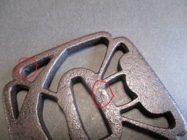

Dan tsuba Posted December 12, 2024 Report Posted December 12, 2024 Hi Dee! I think I have found a few more areas that may indicate that your tsuba is cast. 1 Quote
KungFooey Posted December 12, 2024 Author Report Posted December 12, 2024 On 12/12/2024 at 12:51 PM, Dan tsuba said: Hi Dee! I think I have found a few more areas that may indicate that your tsuba is cast. Expand Hi Dan! Oh well, then as I just said to Dale it'll make a real conversation piece as a paperweight! 😂 Quote
ROKUJURO Posted December 12, 2024 Report Posted December 12, 2024 Clearly cast for me. Not EDO. 2 Quote

KungFooey Posted December 13, 2024 Author Report Posted December 13, 2024 Well, my brother just got the guard in hand and it's cast all right! Now I have to decide on a paperweight or a wind chime! 😂 Many, many thanks to everyone who gave their opinion! Dee 1 Quote
