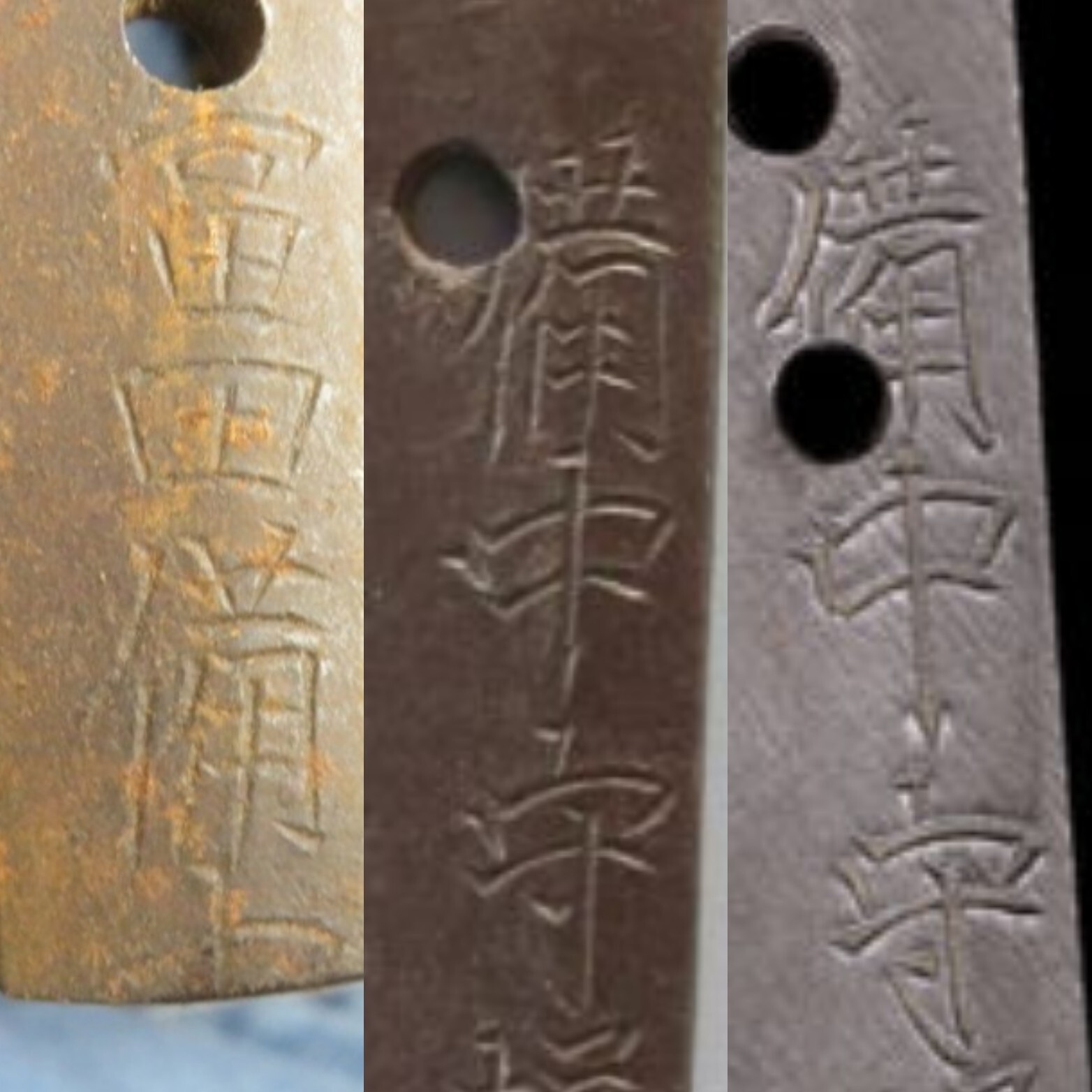

bachmanw Posted December 9, 2024 Report Posted December 9, 2024 Hello folks, New to this forum, but I know a few members from others. I dabble in Japanese Military Swords and not sure if I am still a complete novice, but not much past there. I know enough to ask for help though. A little intimidated because I don't know all the terminology, but I will do my best. Picked this up a while back in Kyu Gunto mounts. It has obviously been cut down and there is a partial Mei. There is also a Mum, which I understand signifies that the forge has been sanctioned by the Shogonate or retained? Any information or additional photos please let me know. Thanks, Bill Quote
Ray Singer Posted December 9, 2024 Report Posted December 9, 2024 Very likely the smith Bitchu (no) kami Yasuhiro (who did use a kikumon). https://nihontoclub.com/smiths/YAS804 3 Quote

Bruce Pennington Posted December 10, 2024 Report Posted December 10, 2024 May I ask what is being said on the side of the kiku? Quote
bachmanw Posted December 11, 2024 Author Report Posted December 11, 2024 Bruce - thanks for asking this. In addition, I would also like to understand the significance of the use of the Mum. Quote
Bruce Pennington Posted December 11, 2024 Report Posted December 11, 2024 On 12/11/2024 at 3:02 PM, bachmanw said: significance of the use of the Mum. Expand You had it right at the beginning - it's a seal of approval, so to speak, that the smith is approved by the Shogunate. Quote
