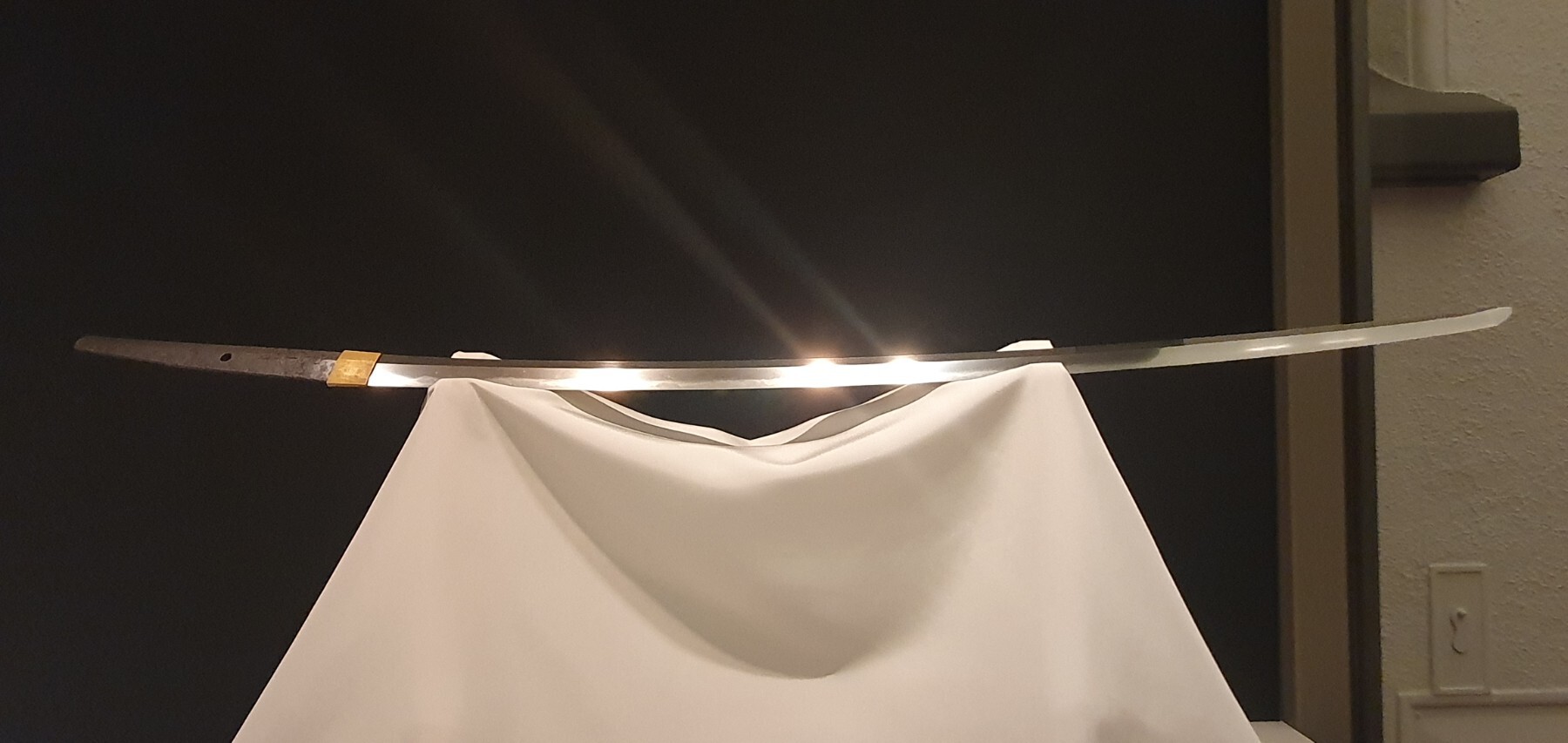

marivo Posted December 7, 2024 Report Posted December 7, 2024 Hello, just bought my second Wakizashi. Already got informed on the translation sectie its a Gimei and Suriage. But thats all. I like to know some more about this item. Mayby somebody can give it to me?? https://myalbum.com/...4b-beb9-5e426a8729b5 Quote

ChrisW Posted December 8, 2024 Report Posted December 8, 2024 How is it dead Jacques? It is certainly tired and overpolished, but I don't see any apparent fatal flaws. I suppose unless you count core steel as fatal. 1 1 Quote

Jacques Posted December 8, 2024 Report Posted December 8, 2024 When I say a sword is “dead”, I mean there's not much left to see. The hada has disappeared, while the hamon has become weak and perhaps even invisible in some places. I'll never buy a sword in this condition, even at a derisory price, but I certainly don't have the same approach to Nihontö as many others and i'm sorry if i study it very seriously.... 2 1 Quote

Matsunoki Posted December 8, 2024 Report Posted December 8, 2024 Well, what can we see in your images? (An image of the whole blade without habaki would help) The blade has obviously been polished many times and is a shadow of its former self. The kasane (thickness) of the nakago is far greater than that of the blade. The hada is not really discernible but we can see a lot of assorted forging flaws and openings. All the above suggests it’s an old blade that was perhaps not of the greatest quality to begin with. This in turn might suggest Koto, maybe late Muromachi….a time when many swords were hastily made. Hopefully others will offer opinions but the problem created by some members who post on here…..their attitude deters others from “having a go”. ..just an opinion……possibly wrong🙂 4 1 Quote

marivo Posted December 8, 2024 Author Report Posted December 8, 2024 1 hour ago, Matsunoki said: Well, what can we see in your images? (An image of the whole blade without habaki would help) The blade has obviously been polished many times and is a shadow of its former self. The kasane (thickness) of the nakago is far greater than that of the blade. The hada is not really discernible but we can see a lot of assorted forging flaws and openings. All the above suggests it’s an old blade that was perhaps not of the greatest quality to begin with. This in turn might suggest Koto, maybe late Muromachi….a time when many swords were hastily made. Hopefully others will offer opinions but the problem created by some members who post on here…..their attitude deters others from “having a go”. ..just an opinion……possibly wrong🙂 Thanks for your time, here a picture off the blade 1 Quote
Alex A Posted December 8, 2024 Report Posted December 8, 2024 Hi Ivo, you have not provided any blade measurements, as far as i can see. Just looking at your last picture, just wondering if it was once a katana, as looks a bit stout. Also, in one of your pics. Hard to see but is that a possible kirikomi in the nakago ? 1 Quote
Lewis B Posted December 8, 2024 Report Posted December 8, 2024 Certainly the sugata has that feel. Much longer blade substantially shortened. Battle damaged and repair is a good reason for its present state. 1 Quote
Alex A Posted December 8, 2024 Report Posted December 8, 2024 Maybe a shortened Momoyama sword, longish kissaki. Some more reading Ivo, plenty on the internet. Changes in the Shape of the Japanese Sword | Japan Forward 1 1 Quote
Matsunoki Posted December 8, 2024 Report Posted December 8, 2024 If we look at the kasane of the blade compared to nakago it looks as if there is a very substantial difference even allowing for optical distortions (see below). That would suggest that if the blade was shortened it was done quite some time ago and was then followed by many polishes to create such a difference. That makes you think/wonder if it isn’t shortened but is in fact ubu or maybe just re-worked. Also with suriage would we not have stronger machi…..but there is virtually no hamachi…..again….ubu?…..or shortened a long time ago Also the nakago patina is very consistent But then we look at the hamon at the machi and it appears to flow into the nakago suggesting suriage….but of course that could just be an effect of polishing. And then there is that lower mekugi ana to contend with. Im wondering if it’s even older than we think…..and maybe it’s tired condition supports that? Edit…..visibly very high shinogi in the nakago. Is that Yamato den? I’m not too hot on Gokaden🙂 1 Quote
Alex A Posted December 8, 2024 Report Posted December 8, 2024 Hi colin, if it was a Katana shortened to a wak back at the end of the 16th century, plenty of time to see many polishes. Its an hard time. Did see masame when i was looking earlier. Nakago done very crudely. Just putting ideas forward. Not sure about anything though. 1 Quote
Matsunoki Posted December 8, 2024 Report Posted December 8, 2024 3 minutes ago, Alex A said: Just putting ideas forward. Not sure about anything though. Me to. Interesting when something isn’t quite as obvious as it first appears. That really high nakago shinogi makes me think. Also it looks like it’s got a deep kasane. Not that my opinion counts for much🙂 1 Quote
marivo Posted December 8, 2024 Author Report Posted December 8, 2024 1 hour ago, Alex A said: Hi Ivo, you have not provided any blade measurements, as far as i can see. Just looking at your last picture, just wondering if it was once a katana, as looks a bit stout. Also, in one of your pics. Hard to see but is that a possible kirikomi in the nakago ? Its 47.3 cm, thanks for your time Quote
