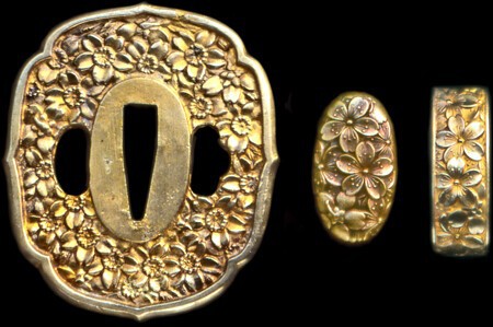

Bruce Pennington Posted December 4 Report Posted December 4 @SteveM or @Ray Singer, or one of the other guys will help with the smith's name. In the meantime, could you post a straight-on, clear shot of the menugi - the metal piece under the ito (handle wrap), please? Also, if you actually go by "Bullet" as a nickname among friends and family, great! But if not, please post a real first name in you profile that will show up. It's NMB rules, and we just like to chat with real people! 1 Quote

Tensho Posted December 4 Report Posted December 4 Looks like it has some "civilian" gunto fittings. I too would like to see more of the koshirae. Quote

Bruce Pennington Posted December 4 Report Posted December 4 Bullet, You might already know this, but a "fake" signature, or gimei, doesn't mean the sword is a fake. It was a fairly common practice done for hundreds of years. Thanks for the added photos. You have an interesting piece there. Old, civil blade re-fitted for the war. The black leather cover is usually found on Navy swords, but the menugi is Army. The fuchi (the collar on the handle with the flowers) is a pattern used for the civil branch of the military called Gunzoku. I suspect this explains the rest of the combo. Quote
