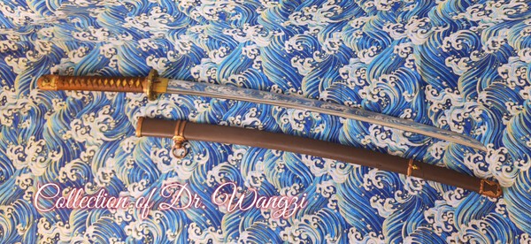

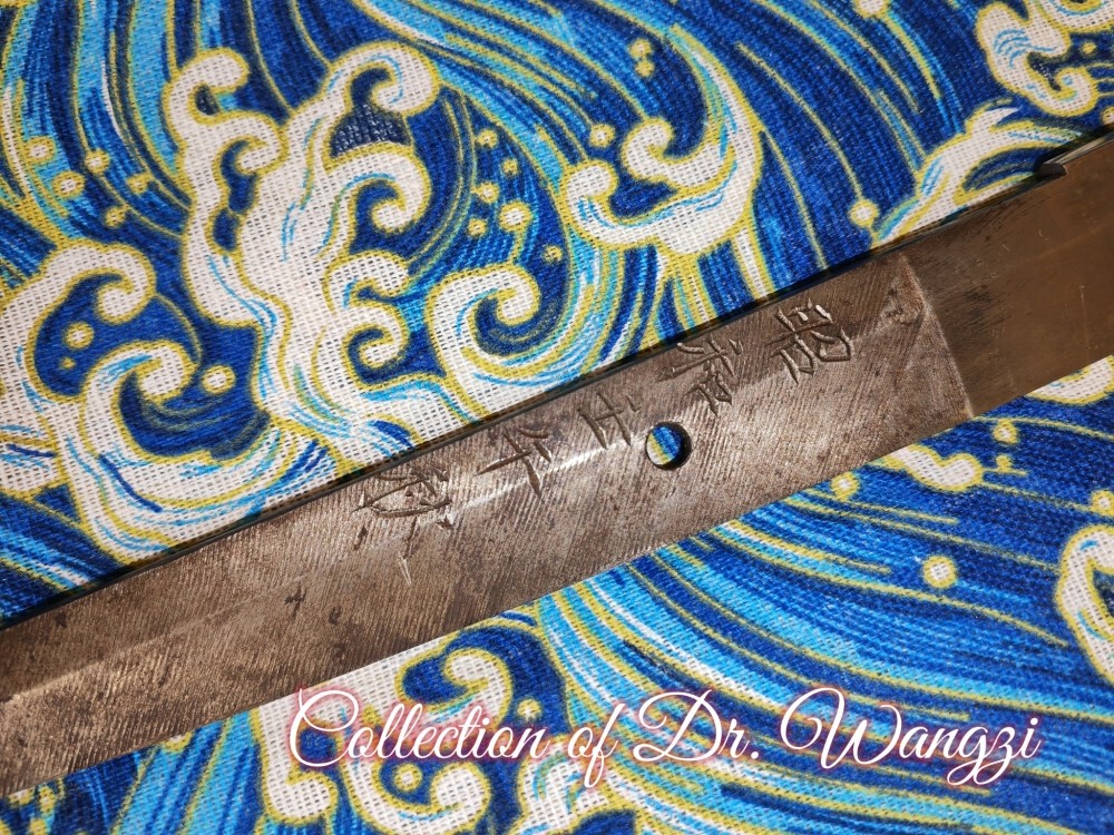

Wangzi Posted December 6, 2024 Report Posted December 6, 2024 On 12/5/2024 at 10:26 PM, Bruce Pennington said: Hi, Bruce, Yes, The SMR buildings in Dalian are now being used as museum ,exhibition gallery and liberary. However, it is a pity that exhibitions are mainly about history of SMR, not quite relate to its edged weapon manufacture. I am glad to post the details of my sword. It was forged in Autumn 1942(昭和壬午年秋), the number is Ku 101 (ク101). Zi 2 1 Quote
