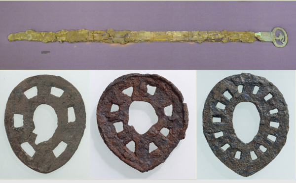

@Rivkin Kirill, are you referring to these Kofun period tsuba?
Yes they disappeared entirely once the straight bladed swords were replaced by the tachi with its very particular type of fittings:
It appears that the kiku chrysanthemum design (and "Saotome" rays tsuba) didn't appear until the late Muromachi period.
Guruma wheels didn't appear until the Owari type tsuba were being produced.
I would argue that those kofun tsuba were not "pictorial representations" like these later sukashi tsuba. Similar in appearance but significantly different in what they represent.

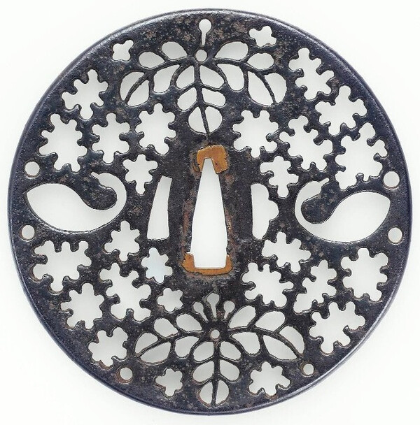

One of the implications of the hypothesis that ji-sukashi tsuba arose no earlier than late Muromachi period is that much of the date attributions of Sasano sensei and other influential scholars is wrong for Kyo-sukashi, Ko-Shoami, Owari, and Kanayama tsuba. We touched on how some sellers are hawking their tsuba as being among the earliest of these styles dating back to mid-Muromachi. The vast majority of these are Momoyama period and more recent. Again, there is no evidence for Muromachi period Kanayama tsuba. None.
Case in point: https://www.jauce.com/auction/b1089471872
I can't tell if the hakogaki indicates Muromachi. If this is Kanayama, I actually don't think it is Momoyama either. The relative stiffness of the composition suggests Early Edo during a transition period to confirmatory Takagawa culture. There are no tekkotsu that I can discern on images.

From the images provided by the seller in the auction, this certainly looks Edo Period to me.  There is none of the characteristic dynamism infusing Momoyama Period Kanayama tsuba here.
The best evidence -- based on cultural consideration rather than material analysis --  is that Kanayama tsuba emerged in the Momoyama Period, probably in the 1580s or early 1590s.  There certainly is zero evidence that they were made before Momoyama.

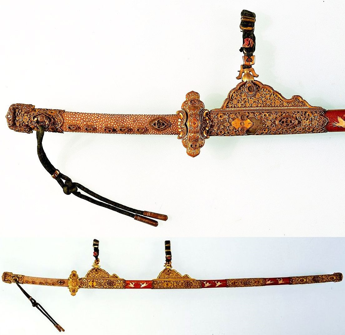

Here is a Nanbokuchō period tachi koshirae of Kasuga Taisha that is designated as Jūyō Bunkazai. Photo credits go to Sankei Shimbun (I just saved the picture): https://www.sankei.c...H35JUHNNY7ZFUJGZTBA/
I am hoping to visit Kasuga Taisha in 2025 as I have not yet been there. Nor do I have a book focused on solely on their sword collection. Unfortunately in my references I only have a tiny side view on this koshirae.

I think the oldest intact koshirae with sukashi tsuba that I have found so far are following famous koshirae
Akechi-goshirae (by old tradition was worn by Akechi Mitsuhide or Akechi Mitsuharu who both perished in 1582, however in Tokyo National Museum book it is written that there is no 100% evidence of the historical ownership). The tsuba is identified as Owari-sukashi.
This famous daishō that was owned by Toyotomi Hideyoshi has extremely rare very decorated early sukashi tsuba.

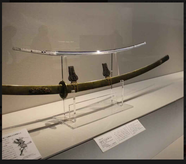

While again maybe going a bit off again with my love for ōdachi, Tsurugaoka Hachimangū has 2 ōdachi and 1 tachi that were all dedicated to the shrine in 1538 by Hōjō Ujitsuna, and all in their original koshirae. I visited the Hachimangū in 2023 but unfortunately none of these swords were on display then (but I was lucky to see their largest ōdachi). I have 2 books of the swords of Tsurugaoka Hachimangū but unfortunately neither of the books have a side view of the tsuba. However trying to look at the pictures closely on the second book I would assume at least the one with only wood remaining on tsuka has a sukashi tsuba.

As to the last photo you include here of the Odachi, it looks to be a kiku-sukashi work.  This lends credence to the understanding that kiku-sukashi and kuruma-sukashi tsuba may have seen somewhat sustained use through the Muromachi Period.  If so, it would seem, then, that the big innovation would have been ji-sukashi designs that departed from these two forms, an emergence that, again, would not have occurred before the latest years of the Muromachi Period, and probably more likely, the early Momoyama.

The tsuba described as "Owari sukashi" belonging to the koshirae supposedly used by one of the Akechi certainly does not appear to be Owari to me; it looks, rather, to be an Edo Period design.  Even if it were Momoyama, however, I don't see it being an Owari Province work.
I think Momoyama period is plausible, but yeah definitely not Owari work.
Here is an image of the Tsurugaoka Hachimangū Koshirae with the Tsuba visible, that Jussi was discussing above. It can be reliably be dated to late Muromachi.
