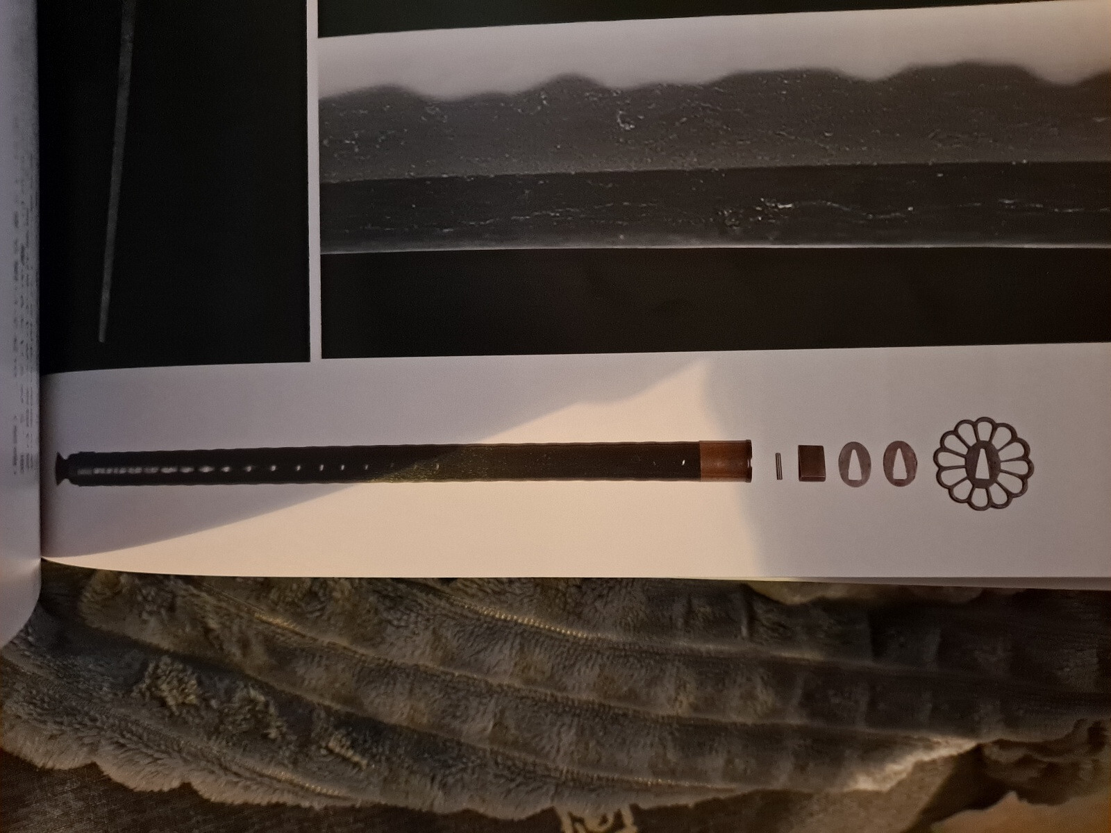

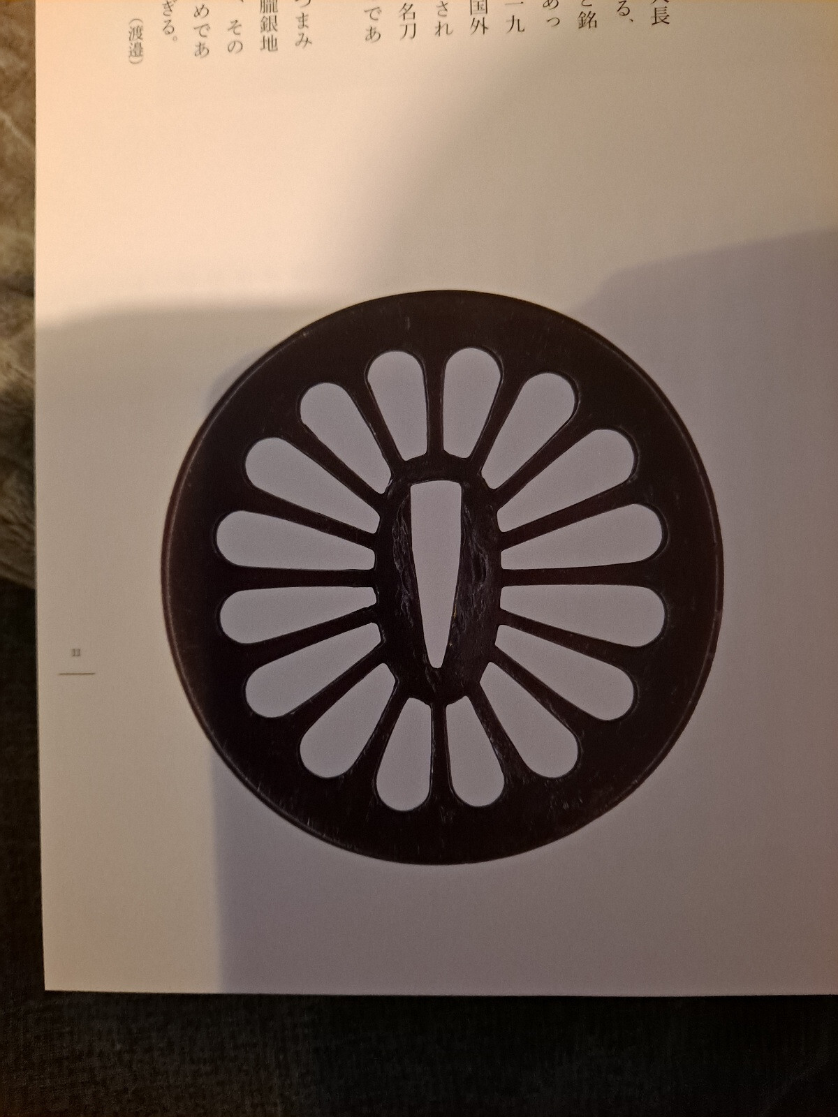

GRC Posted December 3, 2024 Author Report Posted December 3, 2024 by the way... here's some reliable "pseudo-datable sources" for specific iron kiku rays tsuba (that we typically wrongly call Saotome tsuba). ↑ tsuba signed by the armorer “yoshido” who worked during the Tenbun era (1532-1555)... note, we have no idea when he produced this specific piece, and that his working dates include 17 years after the first arrival of the Portuguese. ↑This was a tsuba that was on a naginata that was on record as having been donated to a shrine by the Ashikaga clan... but no exact date, nor the exact generation of Ashikaga is known. Now again, I must point out that the Ashikaga reign lasted a full 25 years beyond the first arrival of the Europeans. Therefore the ONLY sukashi tsuba that can be directly connected to the Ashikaga, and therefore the Muromachi period, are these simple kiku form tsuba. There are NO examples of ANY elaborately patterned sukashi tsuba that can be associated with the Ashikaga. I would argue that it is entirely likely that these tsuba were only being made in the last 25 years of their reign (after the first arrival of the Portuguese with their elaborate openwork hilts). If these were being made since the 1400s, surely some other themes and patterns would have/should have developed over the course of 100+ years, but there is NO evidence of their existence in this time period. This also supports my earlier statement that the more elaborately patterned sukashi tsuba developed under the reign of Nobunaga and Hideyoshi during the Azuchi-Momoyama period of the late 1500s. Quote
Jussi Ekholm Posted December 3, 2024 Report Posted December 3, 2024 I believe Steve has correct info on the painting as it is owned by Kyōto National Museum and I would take their description over others as they have the item in their collection. Here are few quite old sukashi tsuba for you. As I specialize my research on ōdachi and old naginata I think I should have perhaps info on few others in my books. Very large Kamakura period naginata (Katayama Ichimonji) in nagamaki mounts that has a sukashi tsuba, Jūyō Bunkazai item owned by Uesugi-jinja. From the same Uesugi Book a possible ōdachi tsuba 10,2 x 9,9 cm from Nanbokuchō period that resides in private collection. 1 1 Quote
GRC Posted December 3, 2024 Author Report Posted December 3, 2024 On 12/3/2024 at 3:59 PM, OceanoNox said: Thanks @GRC, I look forward to reading new stuff. The age of tsuba interests me particularly because I want to study the evolution over time. Oh, how I wish there were records to be found. Expand Same here!!! It's been sort of an obsession for me for the last two years or so. That's why I started going down the rabbit hole of checking all the existing sources of statements, and trying to discern which ones are valid and which ones are still just theories or hypotheses that have somehow accidentally turned into facts over time through repetition. 2 1 Quote
GRC Posted December 3, 2024 Author Report Posted December 3, 2024 On 12/3/2024 at 4:49 PM, Jussi Ekholm said: I believe Steve has correct info on the painting as it is owned by Kyōto National Museum and I would take their description over others as they have the item in their collection. Here are few quite old sukashi tsuba for you. As I specialize my research on ōdachi and old naginata I think I should have perhaps info on few others in my books. Very large Kamakura period naginata (Katayama Ichimonji) in nagamaki mounts that has a sukashi tsuba, Jūyō Bunkazai item owned by Uesugi-jinja. From the same Uesugi Book a possible ōdachi tsuba 10,2 x 9,9 cm from Nanbokuchō period that resides in private collection. Expand First, I would assert that there's next to no chance that those tsuba are original to those blades. They would have been changed many, many times over since the production of those blades. Secondly, I will restate that it makes no sense that kiku style openwork tsuba were being made during the Nanbochuko period and remained essentially unchanged until the Muromachi period when we get the Owari, Kanayama and Yamakichibei sukashi tsuba. It just doesn't make any logical sense. Thirdly, what proof is there of any kind that those tsuba were made at that date? Just to make the point: If I put an Edo period tsuba on a Nanbochuko blade, does that mean I could conclude the sword was made during the Edo period? Therefore the reverse also cannot be true... Sorry @Jussi Ekholm, but that simply cannot be used as evidence of any kind in this matter. Quote
GRC Posted December 3, 2024 Author Report Posted December 3, 2024 Truly, I beg of anyone to find a piece of evidence that shows sukashi tsuba were made as far back as the Nanbochuko period or even the early or mid Muromachi periods, other than "so and so said so"... Just because someone said it or published it, doesn't make it true. Still a house of cards built on nothing so far... I will gladly change my tune if some real evidence comes up. Quote
Jussi Ekholm Posted December 3, 2024 Report Posted December 3, 2024 That nagamaki tsuba in your post is for another Jūyō Bunkazai naginata of Uesugi-jinja, this one is attributed as Ichimonji Norikane. The shrine has 3 very large naginata with very similar mounts, I agree that Muromachi period would sound quite plausible for these koshirae. I believe the saya for these have been lost. 1 Quote
