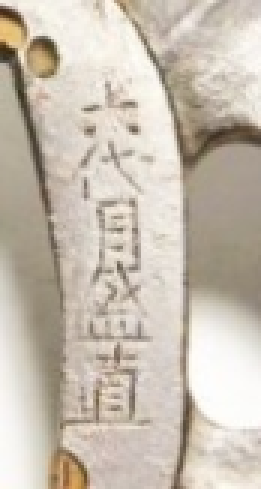

Sorry, but both of those tsuba look to be clear examples (or attempts?) at the Nidai mei.
I honestly don't see how you're getting a meijin shodai read on the first one (the more rounded one)... it has an angled stroke on the left side of the "Yama", and the length of the mei as a whole is shorter vertically than the nakago-ana... both features are distinctly more "Nidai-esque", rather than "Shodai".
Hi Glen :)
I think the poor quality of the photos I posted, especially of the first tsuba, kind of affect our reading of the mei.  The left "post" of the "Yama" ji on this tsuba actually is vertical; it is not angled inwards as we would see on a Nidai guard.  Below is another image of this tsuba (still awful photo quality, but I think you can see what I mean):
As for the degree of extension of the mei along the seppa-dai, there is actually a bit of a range here.  Some Meijin-Shodai mei are more compressed, while some Nidai mei can be more extended.  A few examples follow.  First, the Meijin-Shodai:

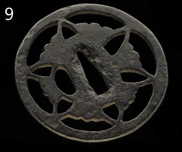

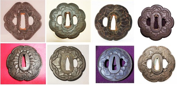

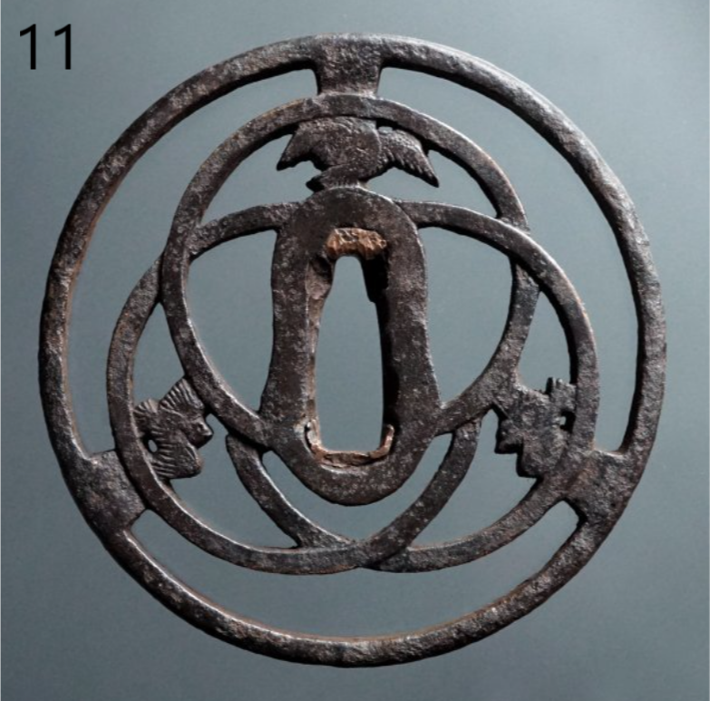

Well, I was hoping people would actually give the twelve tsuba I posted an honest attempt... with no fear of judgement.
But it seems that everyone is either too busy at this point in time of the year (speaking of theology ;-)) or just don't even have an idea where to begin trying to group together such seemingly disparate examples:dunno:
I'll spare you all the angst of trying to figure it out.
It turns out ALL twelve of these tsuba were papered as Ko-Shoami, which is a purely fictitious attribution that really gained a foothold with Sasano's publications.
It seems to me like the only kantei points the NBTHK is using for this attribution are:
-must be unsigned (so there's no way to check)
-pre-Edo period or Edo period (it really doesn't seem to matter, even though the "ko" in Ko-shoami is supposed to mean "pre-Edo period")
-steel plate (which can be solid or have just about any type of sukashi you can think of)
-and most importantly, it must be difficult to place in any of the other limited number of "schools" that have been pronounced and established over the last 100 years.
...so pretty much any steel tsuba that you can't stick into an existing category. ;)
It's kind of like the "Island of Misfit Toys" (a seasonal reference for those of you who know it...)
Actually, "ko-shoami" is a very handy category to have for an organization that needs to label things for money.
It's like a "get out of jail for free" card for those troublesome tsuba :thumbsup:
  • Like 7

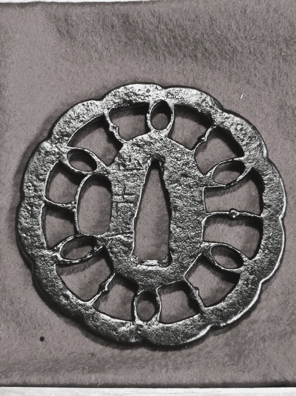

I know next to nothing about NBTHK papers but I did stumble on this https://shibuiswords.com/ELkarahana.html  Papered by NBTHK as likely Hizen.
My problem is I have 25 other examples, some saying they are Asian export guards and only one with a signature which I would need to have translated. I can't see how this "Karahana" can be definitively papered as Hizen - Also the only translation I can get from AI is "Karahana" = Groan, Moan or Whine! - Which is apt as that is the reaction I had when I saw it!   [plus a chuckle at the ridiculous price being asked for a rather poor example of the type! ]
flower karakusa carved signed (2).jpg  image.png.5ae04876764699f13b0172b4fe8257cc.png     六代目签直   "The sixth generation"  ???

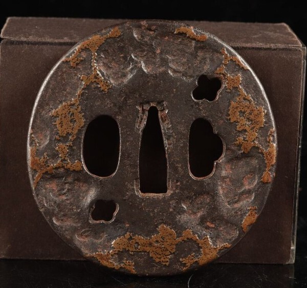

Here's another Frankenstein mash-up of "schools" and papers...
Heianjo encrustation on an obvious Tenpo plate (with stamps, although not prominently obvious), and with papers to...
Shoami!!! Really?????
At least pick Heianjo or Tenpo... but Shoami is ridiculous :crazy:
It's almost like the pressure to choose one or the other obvious one was too problematic it blurs the lines within the inadequate list of categories to slot things into, so the judges decided to skirt the issue and give it a completely different, unrelated attribution. It's the only rationale i can think of that might explain such decision.
