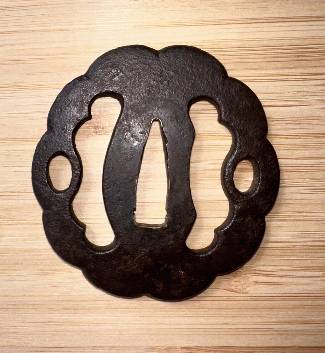

KungFooey Posted November 27, 2024 Report Posted November 27, 2024 Hi all, Some might remember the first guard I posted and me mentioning it was real rusty? It was thick, active rust so I looked at various comments on cleaning guards and got hold of some old pieces of ivory to scrape it off. Well, I sure got rid of all the active rust but I think I've taken it too far. 😳 It's lost it's brown look and turned a dull black grey with one or two points of silver steel peeking out On the wood background is the 'before' photos and on the white background is the 'after'. Sorry to all the angry people out there if I've destroyed a guard! Dee 1 Quote

Bugyotsuji Posted November 27, 2024 Report Posted November 27, 2024 All things considered, I think you have done a good job. It may need to settle down a bit, and you can get some handling into it, without application of hand creams, etc.! 1 Quote
Spartancrest Posted November 27, 2024 Report Posted November 27, 2024 Keep rubbing it every now and then with a soft cotton cloth, it will pick up a glossy finish eventually, sun exposure can also help. I think it will look much better over time, you did a good job to get rid of that "pork crackling" rust [A term I just made up ] 3 Quote

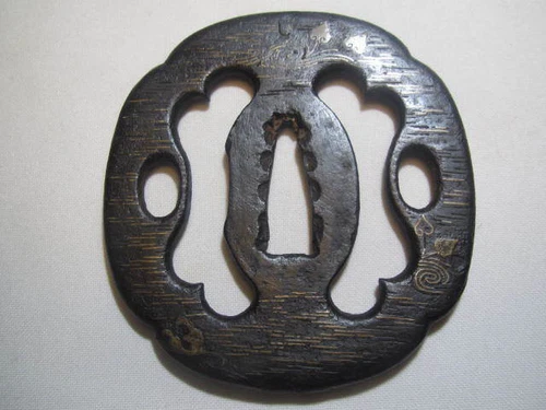

Spartancrest Posted November 27, 2024 Report Posted November 27, 2024 You aren't selling yours are you? https://www.jauce.com/auction/h1162893289 No not enough "lobes"! 1 1 Quote
ROKUJURO Posted November 27, 2024 Report Posted November 27, 2024 Deanne, you did well to remove the red rust! Now a good patina can build up. Iron TSUBA should be "cuddled" with bare hands quite often as this will help build up the protective black iron oxide layer. This process will take some time so be patient! 3 Quote
KungFooey Posted November 27, 2024 Author Report Posted November 27, 2024 Many thanks guys! I thought I'd messed it up 😳 I'll be sure to cuddle it a lot! 😊 Quote

sabi Posted November 27, 2024 Report Posted November 27, 2024 Moderate to severe rust will destroy the patina underneath, likely that it was long gone and you removing it revealed the state of things underneath. Looks pretty good and as others have said it'll (slowly) come back over time. I'll echo Jean's statement while mixing in some periodic cloth rubbing to clean up the surface. Keep in mind, this isn't an overnight process. Patience is key. I had a light spot on an Owari guard I previously owned (which are generally known to be fast healing) and it still took a couple years to fully blend in. 3 Quote
rkg Posted November 27, 2024 Report Posted November 27, 2024 On 11/27/2024 at 11:19 AM, Spartancrest said: Actually, if you look at this one, it could be that there is still inlay on this piece, and a lot of the "stuff" on the surface could well be something called "sukiurushi" - I've posted about this stuff in the distant past with microscope images, etc (I think - the chemo has actually messed with my memory - I can't recall now if I posted this work to Rich Turner's old tosogu FB page or here on the nmb) But I digress. The stuff is Really Hard and difficult to remove and... you almost should leave it in place as the inlay under it will look fresh and clean - and.. (diatribe on apparent age of pieces deleted) In any case, from this image, this appears to me to be one of those "are you feeling lucky" pieces - hard to tell if the surface is just rust and crud over long gone inlays, or if the inlays (or the bulk of them) are still there and it has gunk (probably sukiurushi) over (most of) them or what. maybe it the seller added an oblique image or two it would be more obvious.... Or maybe its just my new caffiene free lifestyle catching up with me... Best, rkg (Richard George) Expand On 11/27/2024 at 11:19 AM, Spartancrest said: You aren't selling yours are you? https://www.jauce.com/auction/h1162893289 No not enough "lobes"! Expand 1 Quote
Tim Evans Posted November 27, 2024 Report Posted November 27, 2024 A good start. Quite often a cleaning project will look worse before it gets better, so that requires a long term commitment. There is a detailed description of the iron tsuba cleaning and patina growth process in Sasano's "gold" book: Sasano, Masayuki. Sukashi Tsuba. London, England: Robert G. Sawers, 1974. It may be possible for you to find a copy through the local library if you want to read it first. As Sasano states, after removing the red rust the next step is to stimulate the formation of black rust, so avoid lotions or oily perspirations that would shut out air and interfere with the oxidation process. A wash with mild soap and water is ok to degrease and get off any remaining loose red rust. Setting it in a sunny window is helpful because adding some mild heat will increase the rate of oxidation. 3 Quote

Oldman Posted November 28, 2024 Report Posted November 28, 2024 Earlier this year I acquired an iron tsuba. Before buying it I noticed in the listing photos that it had an odd, very glossy, black "patina" and asked the dealer if the patina had been redone or otherwise enhanced. He assured me that it had not. Upon receipt the patina still looked odd, almost like it had been painted with gloss black paint. When handling it I found that my hands felt a bit oily and it smelled like maybe 3 in 1 oil. I followed suggestions from another thread here on the NMB regarding improving patination and did the following: 1) Washed it with hand soap and quite hot water, just using my hands. (Sure enough, it was no longer black, had a more natural brown colour, but a disappointing dull look, as though coated with Hersheys cocoa powder.) 2) Hung it outside on a covered porch, using a cord through the nakago ana. 3) Every couple of days brought it in and handled it all over, rubbing with my fingers, reasonably clean hands. After about 2 1/5 weeks of this treatment it was looking much better so I brought it in and spent the couple of months just handling it, e.g. while watching TV, and it now has a presentable patina. One note: I live close to the ocean and have regular nighttime dampness and mists which sometimes have a certain salinity to them (I've never seen that measured, but items stored outside get rusty faster than in other places I've lived). I was concerned about it being too damp when I hung outside so watched it closely for the first few days but didn't see any active rust starting so maybe the damp, marine, climate helped with the process. This ran longer than I meant to, but thought perhaps others might find some of the details of interest. Cheers, Michael BC 5 Quote
