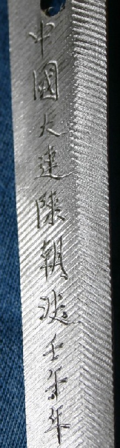

I am considering selling a Paul Chen sword to put towards a true nihonto and it would be nice to identify the mei and other marks for buyers. I have had it around four years and always wondered what it says.

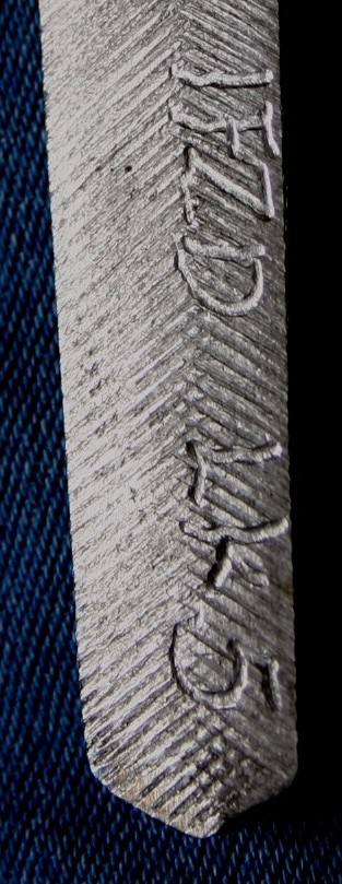

Can someone tell what this mei reads ? Also, what do the other markings indicate ?
Thanks in advance, Pez
The mei may be "中國大連陳朝波壬午年", though I do not know its Chinese reading.
The meaning may be as follows;
中國: China
大連: Dalian
陳朝波: name of a person (Chen Chao Po?)
壬午年: 2002 (year)
What Koichi said. Here's the Chinese (and in brackets the Japanese) reading:
中國 = ZHONG-GUO (CHŪ-KOKU) = China
大連 = DALIAN (DAI-REN) = a city in Liaoniang province, used to be called Port Arthur
陳 = CHEN (CHIN) = family name
朝波 = CHAO-PO (CHŌ-HA) = given name
壬午年 RAN-WU-NIAN (MIZU-NO-E UMA (no) TOSHI) = year of the horse = 2002
