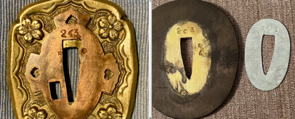

Polaria Posted November 24, 2024 Author Report Posted November 24, 2024 I took it apart again and found markings on the seppa. It also matches the tsuba and kind of doesn't. I am thinking there is at least a few washers missing here. Quote

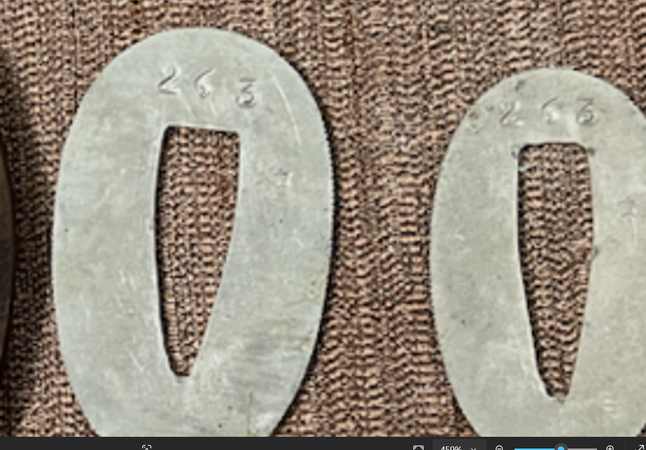

Bruce Pennington Posted November 24, 2024 Report Posted November 24, 2024 I agree with all the above. The koiguchi and sayajiri appear to be modern reproductions. I suspect the blade was legit and put into a variety of real and fake fittings. I'm really puzzled by the tsuba/seppa set. I THINK they are legit, but I have a kaigunto tsuba/seppa set with the exact same number - even the impartially struck "6" and small star: Quote
Polaria Posted November 24, 2024 Author Report Posted November 24, 2024 58 minutes ago, Bruce Pennington said: I agree with all the above. The koiguchi and sayajiri appear to be modern reproductions. I suspect the blade was legit and put into a variety of real and fake fittings. I'm really puzzled by the tsuba/seppa set. I THINK they are legit, but I have a kaigunto tsuba/seppa set with the exact same number - even the impartially struck "6" and small star Now that is very strange. As for the blade I found two Kaneyoshi: https://nihontoclub.com/smiths/KAN2998 and https://nihontoclub.com/smiths/KAN3072 Quote
Conway S Posted November 24, 2024 Report Posted November 24, 2024 Personally, I think the kai gunto fittings are 263. I'll have to look at the tsuka and fuchi the next time I have it out to see if they have any sub assembly numbers. The nakago mune is stamped, but the numbers are squiggly and I can only clearly make out the "2." Conway Quote
Conway S Posted November 24, 2024 Report Posted November 24, 2024 @Bruce Pennington I misread your post. Did not realize you mentioned the impartially struck 6. 1 Quote

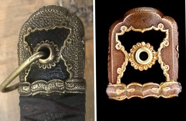

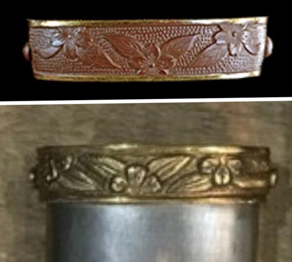

Polaria Posted November 26, 2024 Author Report Posted November 26, 2024 I approached the seller suggesting that the saya might be a fake. He said it was likely not the original saya of this sword, but denied strongly that it would be fake. This is a reputable antique seller so I am willing to give him the benefit of doubt. However I do not consider the discussion over yet, so here are some better pictures of the kochi-gane, ashi and shibabiki. You can see the mouth of the saya and the ishizuke in my previous posts. Are there any clear indications one way or another that you can see? I would really much want the saya to be genuine, but I am worried about so many little details just not quite matching what I've seen in other gunto sayas. Quote

Bruce Pennington Posted November 26, 2024 Report Posted November 26, 2024 Mikko, You can clearly see the quality difference in the first photo. The saya parts (don't know about the actual saya) are copies. I have others on in my Fakes file similar, even with the bare saya: Quote
lonely panet Posted November 26, 2024 Report Posted November 26, 2024 3 hours ago, Polaria said: I approached the seller suggesting that the saya might be a fake. He said it was likely not the original saya of this sword, but denied strongly that it would be fake. This is a reputable antique seller so I am willing to give him the benefit of doubt. However I do not consider the discussion over yet, so here are some better pictures of the kochi-gane, ashi and shibabiki. You can see the mouth of the saya and the ishizuke in my previous posts. Are there any clear indications one way or another that you can see? I would really much want the saya to be genuine, but I am worried about so many little details just not quite matching what I've seen in other gunto sayas. If the dealer cant see that the saya is modern fake crap. He isn't a reputable dealer. Just someone making profit of his ignorance. Run away and save you pennys Quote

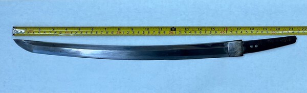

Stephen Posted November 30, 2024 Report Posted November 30, 2024 What's missing is the photos of the blade nagasa kissaki. The first photo says a lot the angei of tsuka to saya is very telling. Agree it's a Frankie. Terrible light of the tsuka it washed any color of the patina on nakago, try natural window light. So full shot of blade no fittings, geometry of the tip. Oh and pic of hamachi please. Quote

Polaria Posted November 30, 2024 Author Report Posted November 30, 2024 I live in Finland so at this time of the year any "natural light" is a hard to come by. I tried the best I could, so here goes nothing... The length of the nakago is just over 12 cm and the blade (measured from habaki to kissaki) is 63 cm. Quote

Stephen Posted November 30, 2024 Report Posted November 30, 2024 How long is it from tip to munemachi in inches Quote
Polaria Posted November 30, 2024 Author Report Posted November 30, 2024 24 minutes ago, Stephen said: How long is it from tip to munemachi in inches I don't have a measuring tape in inches, but conversion table says 63,5 cm is almost exactly 25 inches. 1 Quote
