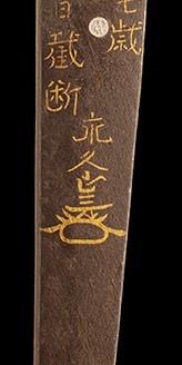

Bruce Pennington Posted November 26 Report Posted November 26 On 11/22/2024 at 7:51 AM, Alex A said: A rarity Wakizashi: Mumei(Unsigned)(Omiya)with Saidan-mei(NBTHK Tokubetsu Hozon Token) - Japanese Sword Shop Aoi-Art @SteveM Aoi Art says the cutter was Yamano Kanjuro, tested early Spring 1934 Do you concur with the name? I ask because his kakihan (kao) is identical to a cutter in the 1600's by the name of Nagahisa: Kanjuro Nagahisa 1 Quote
Nobody Posted November 26 Report Posted November 26 33 minutes ago, Bruce Pennington said: @SteveM Aoi Art says the cutter was Yamano Kanjuro, tested early Spring 1934 Do you concur with the name? I ask because his kakihan (kao) is identical to a cutter in the 1600's by the name of Nagahisa: Kanjuro ..................................................... There are several misunderstandings. 1. Aoi Art says that early spring 1934 is the date when Kanzan wrote the sayagaki. 2. The correct date when the sayagaki was written is early spring in 1968. This is Aoi Art’s mistake. 2 2 Quote
Bruce Pennington Posted November 26 Report Posted November 26 So, the cut tester was Kanjuro, but we don't have a date? Sorry for the rookie questions, but in this, I really am a rookie! Quote
SteveM Posted November 26 Report Posted November 26 10 hours ago, Bruce Pennington said: Do you concur with the name? I ask because his kakihan (kao) is identical to a cutter in the 1600's by the name of Nagahisa: Kanjuro The inscription is Yamano Kanjuro, but you are right in that the kaō does indeed look exactly like Nagahisa's kaō. I'll assume that the NBTHK didn't find anything suspicious in the cutting test mei (otherwise they might have made the subtle notation "to saidan mei ga aru" (i.e. "there is a cutting test inscription which says....."). This is their way of distancing themselves from any validation on the cutting test inscription. In other words, they use that phrase when they want to say "the sword is from so-and-so, and by the way there is also a cutting test inscription, but we make no claim about the validity of the cutting test inscription". But yes, an interesting observation. 2 Quote
