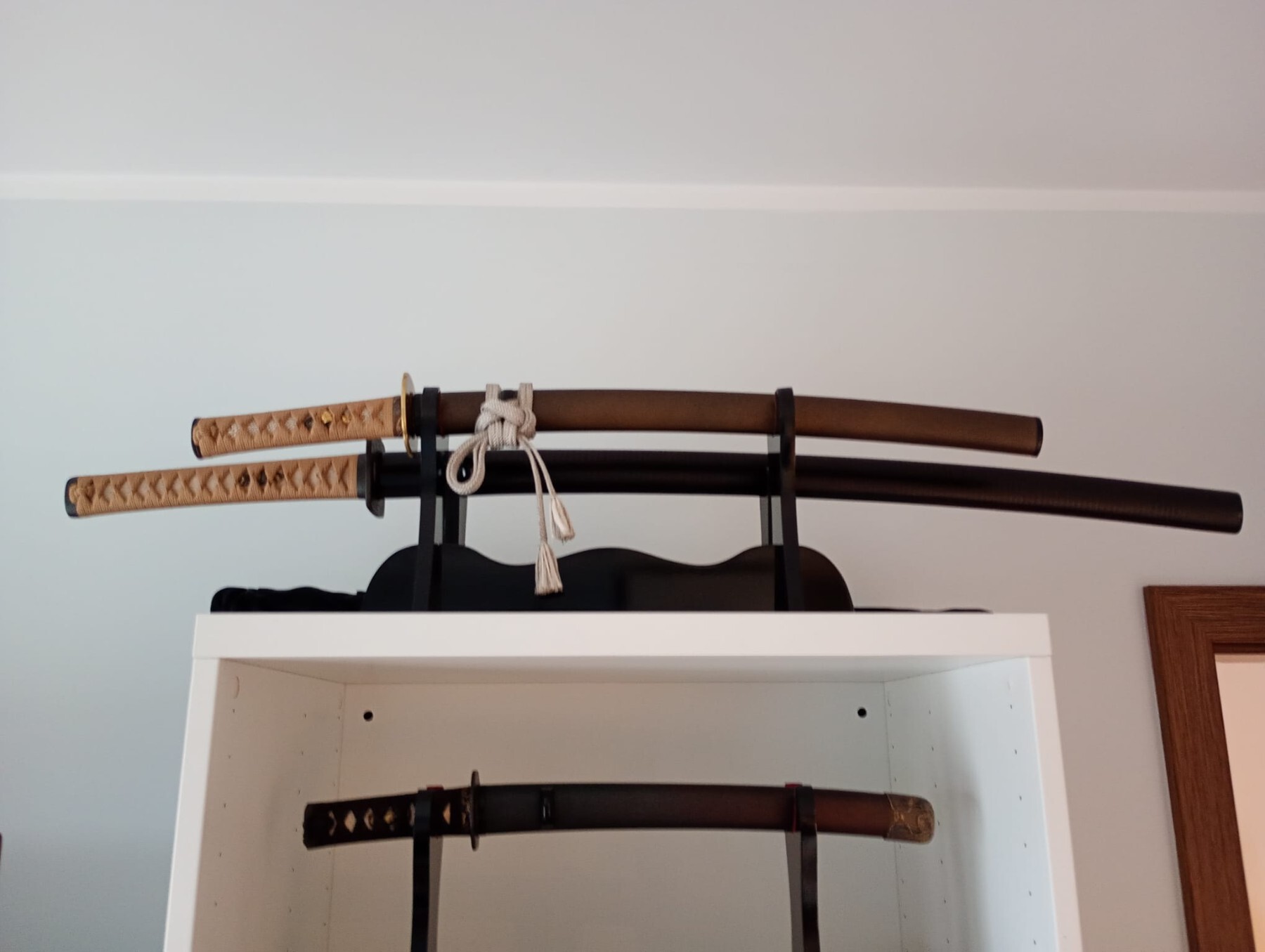

2devnul Posted December 30, 2024 Author Report Posted December 30, 2024 https://www.ebay.com...7:g:KDgAAOSwUO5nbz-1 https://www.ebay.com...2:g:xHQAAOSwHjdnbzTB PS. Here is my 'Daisho' for display. 1 Quote

Alex A Posted December 31, 2024 Report Posted December 31, 2024 Ps Adam, like your Daisho, don't like the stand lol (only joking) Quote

Alex A Posted December 31, 2024 Report Posted December 31, 2024 Think two swords like that deserve a nice Japanese stand. Don't have be old and megabucks, see them on Fleebay at reasonable prices, oldish wood stands. Ps, for someone just wanting a display without wanting to spend a fortune, then i guess the Daisho i linked could suffice. Also, never going to know when those two swords were put together for sure. May have been late Edo, may have been together in other koshirae previously. I guess one would need to take a real close look for further clues. Evaluate all the fittings and fit and wear. Says in "old polish", just noticed that. 1 Quote
