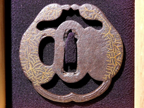

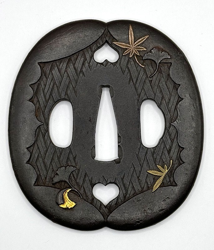

Jesta Posted Tuesday at 01:09 PM Report Posted Tuesday at 01:09 PM I picked this one up on a whim, mostly because I liked the unusual shape, and the the autumn theme. Can anyone shed any light on the school or origins of this type of design? I can’t seem to find many that have this symmetrical ryo mokko gata design. 4 Quote
ROKUJURO Posted Tuesday at 02:37 PM Report Posted Tuesday at 02:37 PM Justyn, many later TSUBA cannot be related to a specific school, as designs and techniques spread around and were widely copied. This one looks like a very late but very good TSUBA with autumn theme, probably the shape is also called MOMO GATA. 3 Quote
Gunome Posted Tuesday at 09:48 PM Report Posted Tuesday at 09:48 PM What about an Umetada school influence ? 2 Quote
Steves87 Posted Tuesday at 09:50 PM Report Posted Tuesday at 09:50 PM Also nown as futatsu-mokko-gata. Very nice guard by the way, congratulations! 2 Quote
Spartancrest Posted yesterday at 05:11 AM Report Posted yesterday at 05:11 AM A paperweight a little like some of the features with Ajiro [mat background] but not the same shape. https://world.seiyud...m/product/tu-120515/ shape? As Steve has pointed out futatsu-mokko-gata could be the shape it is usually associated with Musashi Namako tsuba but they are sukashi not solid plate One reference calls the shape "Kaigu Tsuba" https://ho-sui.com/en/products/鍔-つば-武蔵 that site sells replica tsuba so I doubt the name is accurate. 1 Quote
Jesta Posted yesterday at 05:29 AM Author Report Posted yesterday at 05:29 AM 15 minutes ago, Spartancrest said: As Steve has pointed out futatsu-mokko-gata could be the shape it is usually associated with Musashi Namako tsuba but they are sukashi not solid plate One reference calls the shape "Kaigu Tsuba" https://ho-sui.com/en/products/鍔-つば-武蔵 that site sells replica tsuba so I doubt the name is accurate. Thanks, you are always a reliable source of knowledge and references. The only ones I have been able to find with the top and bottom indents are the sukashi type, until your tanto tsuba. 1 Quote
Spartancrest Posted yesterday at 06:18 AM Report Posted yesterday at 06:18 AM An incidental outline shape from the Klefischauktionen collection. No information on it unfortunately. The shape seems very rare, I have looked through 3,000 tsuba images and only found two, other than yours! [So far ] This one may well be the ura of the other? 2 1 Quote
Jesta Posted yesterday at 08:37 AM Author Report Posted yesterday at 08:37 AM Thanks for looking so hard. I couldn’t find any. Those are beautiful. Quote
Spartancrest Posted yesterday at 11:03 AM Report Posted yesterday at 11:03 AM (edited) Starting to find others - this one tilted over 90 degrees, does that count? https://www.jauce.com/auction/p1118290518 Smooth sided Myoga https://www.honto-nihonto.com/en/sue-tegai . While there are many Myoga tsuba like this design, they are more Kawari-gata because of the indents for the sides of the flowers/leaves (?) so I don't think they would count. Edited 23 hours ago by Spartancrest More images 1 1 Quote
Steves87 Posted yesterday at 11:05 AM Report Posted yesterday at 11:05 AM Futatsu means two (like, two lobes), in what context im not entirely sure though... and admittedly, i got it from Sesko's sword encyclopaedia in the mokko section. 3 Quote
Jesta Posted 23 hours ago Author Report Posted 23 hours ago 30 minutes ago, Spartancrest said: Starting to find others - this one tilted over 90 degrees, does that count? https://www.jauce.com/auction/p1118290518 Smooth sided Myoga https://www.honto-nihonto.com/en/sue-tegai . While there are many Myoga tsuba like this design, they are more Kawari-gata because of the indents for the sides of the flowers/leaves (?) so I don't think they would count. 90 degrees is interesting, and I would say that it counts for this taxonomy… Twin lobes, mirrored. The Myoga tsuba is really nice. I remain in awe of your sleuthing abilities… Quote
Spartancrest Posted 22 hours ago Report Posted 22 hours ago (edited) I have sixteen images of double "Sho" woodwind instrument like a Pan pipe but I am not sure they qualify because the top and bottom indents are not the same? These are from my utsushi records - no big surprise just how many of the same designs get produced, yet each is an individual not a cast copy. I may as well throw in a Shingen from the Warsaw museum as well Make that 17 "Sho" Edited 22 hours ago by Spartancrest More images 2 1 Quote
sabiji Posted 21 hours ago Report Posted 21 hours ago I had a sukashi kanayama with constrictions at 3 and 9 o'clock, not at 12 and 6 o'clock as is so often the case here. Officially, the papers said Ryo-Mokko-Gata, but an expert told me that at least my tsuba was based on the shape of the Kemari ball. That seemed very plausible in my case. Quote
Spartancrest Posted 7 hours ago Report Posted 7 hours ago I found a "Do it yourself Futatsu" just a little work with a hammer! NAH! I don't think so. 2 Quote
Spartancrest Posted 3 hours ago Report Posted 3 hours ago https://www.ebay.com.au/itm/296351643175 Is it just me or does this look like Grover kissing a mirror or two Proboscis monkeys ? Quote
