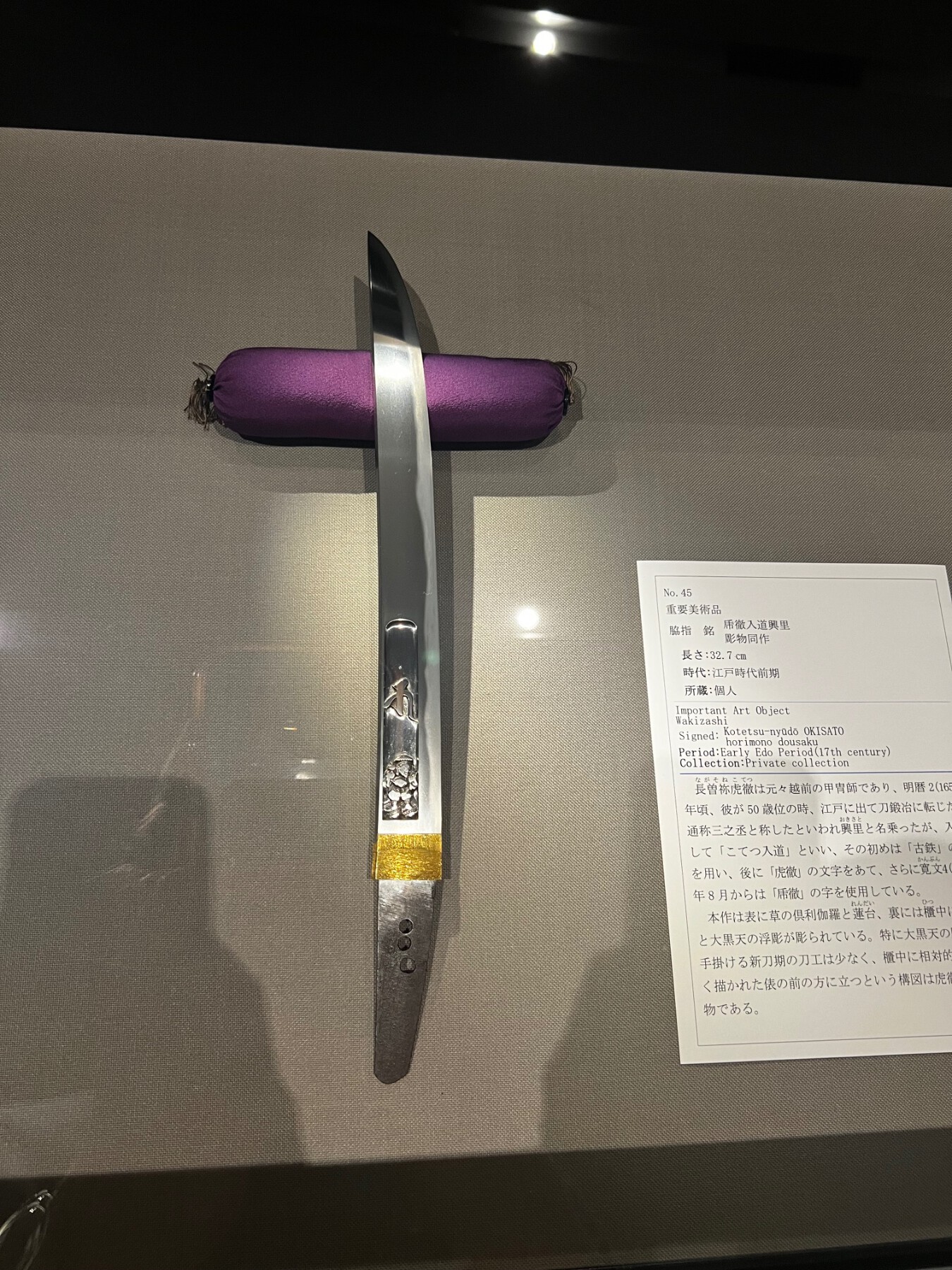

Baka Gaijin Posted November 15, 2024 Report Posted November 15, 2024 A few snaps from the current Horimono exhibition at the NBTHK Hakubutsukan in Tokyo. Photography is allowed, just no Flash. 8 1 Quote

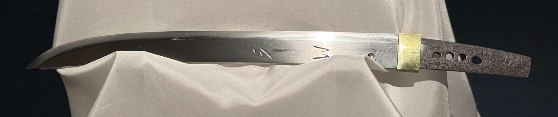

Gerry Posted November 25, 2024 Report Posted November 25, 2024 There was this pretty odd looking nanbokucho era Tomomitsu wakizashi with a 41cm, nagasa, and almost half as wide. Complete with accompanying koshirae with a huge kozuka. 1 Quote

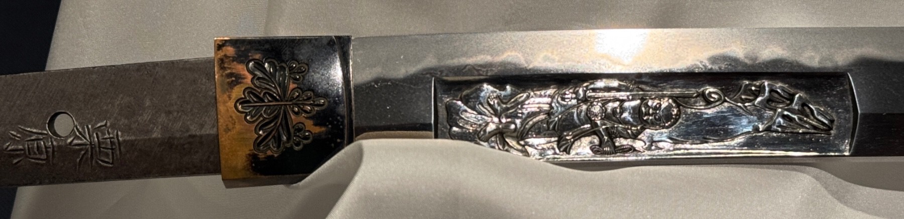

nulldevice Posted November 25, 2024 Report Posted November 25, 2024 Here are a couple photos I snapped that of some blades that captured my eye that haven’t been posted yet. 2 Quote
nulldevice Posted November 25, 2024 Report Posted November 25, 2024 Closeup of the Rai Kunitoshi 3 Quote

Jussi Ekholm Posted November 25, 2024 Report Posted November 25, 2024 The ultrawide Tomomitsu wakizashi was a historical Masamune that is owned by Yasukuni-jinja. I have so far missed it everytime I have visited Yasukuni-jinja as it has been at NBTHK grading run for a good while now, it just passed as Tokubetsu Jūyō and I hope it will be back at Yasukuni-jinja next summer. The mumei Sadatsuna tachi has the following kiritsuke-mei - 奉納象頭山金毘羅大権現 / 文政十二年己丑六月日 / 願主杉山政徳敬白 - There might be an error in my translation but I believe it was dedicated to Konpira Daigongen of Mt. Zozu by Sugiyama Seitoku (or Masanori) in 1829. 1 1 Quote
Gerry Posted November 25, 2024 Report Posted November 25, 2024 13 minutes ago, Jussi Ekholm said: The ultrawide Tomomitsu wakizashi was a historical Masamune that is owned by Yasukuni-jinja. I have so far missed it everytime I have visited Yasukuni-jinja as it has been at NBTHK grading run for a good while now, it just passed as Tokubetsu Jūyō and I hope it will be back at Yasukuni-jinja next summer. The mumei Sadatsuna tachi has the following kiritsuke-mei - 奉納象頭山金毘羅大権現 / 文政十二年己丑六月日 / 願主杉山政徳敬白 - There might be an error in my translation but I believe it was dedicated to Konpira Daigongen of Mt. Zozu by Sugiyama Seitoku (or Masanori) in 1829. Hi Jussi, you're correct, this Tomotisu is listed as Tokubetsu Juyo. 1 Quote
Gerry Posted November 25, 2024 Report Posted November 25, 2024 There was also this tanto with a rather peculiar usagi carving. 2 1 Quote
CSM101 Posted January 26 Report Posted January 26 Not Tomomitsu but Koyama Munetsugu. Just in case... 1 Quote
Brano Posted January 27 Report Posted January 27 12 hours ago, CSM101 said: Not Tomomitsu but Koyama Munetsugu. Just in case... They are two different blades Uwe Quote
