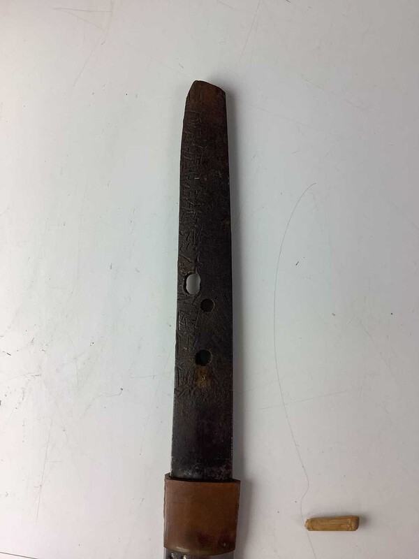

Marcus Devonport Posted November 10, 2024 Report Posted November 10, 2024 First Timer Poster, hoping I may be able to call upon more experienced collectors than myself I'm in my first months of Collecting Nihonto and won this item through online auction, advertised as a "Genzaemon Sukesada" katana- extract below. "A Muromachi period Genzaemon Suke Sada katana with 61cm double grooved blade, in near mint Japanese polish, signed to the tang and dated El-Roku, Hachi, Nen, Ni Gatso (made in the 8th year of 1565, February a lucky day" The attached some photos of the Nakago weren't available to me at the time- however I was taken aback by what looked to be an active Hamon, from what limited photos were available and admittedly caught auction-fever on the day of the sale Can I get some general opinions; the Nakago does appear strange in shape having being altered during its life- however I'm mostly concerned over the Mei itself. I'll admit I'm not at a point where I can confidently compare signatures- I would be grateful if I could get some opinions on this piece. Thanks all, I really hope you can help! Quote
Alex A Posted November 10, 2024 Report Posted November 10, 2024 Not great pics, but dont like the look of that mei or the state of the nakago. Saying that though, the blade could be Sue Bizen Quote
Marcus Devonport Posted November 10, 2024 Author Report Posted November 10, 2024 3 minutes ago, Alex A said: Not great pics, but dont like the look of that mei or the state of the nakago. Sadly, the I had potentially put too much faith in the auctions description as I've built up a level of trust with that particular one- the terrible photos are the best I have to work with for the time being. Would you refuse it, it should it be a forged signature? would it count as such in an auction, and be a *forgery* with lack of a better term? I don't know whether I need to accept I may have been burned on this one, as it caused quite a stir at auction and didn't go for cheap. It would be a great shame, as initially all looked correct in the lot photos (or at least the initial ones did!) Quote
Alex A Posted November 10, 2024 Report Posted November 10, 2024 Hi Marcus, auctions talk nonsense at the best of times. The blade actually looks ok, so as long as you paid the right price for a gimei blade with a dodgy nakago then all is well. As someone new to the hobby i would do a lot of reading up and stay away from auctions. You can buy swords with NBTHK papers etc that authenticate the blade. Quote

Alex A Posted November 10, 2024 Report Posted November 10, 2024 Don't forget, that's just my opinion above. We see Sukesada mei from various Sue Bizen Sukesada that look shoddy but have papers. That one looks a step too far. Nothings real clear from those images. I cant say any more than with what's available i would have passed. Others may have differing opinions. Quote
Brian Posted November 10, 2024 Report Posted November 10, 2024 Shouldn't be buying unpapered mainly for the mei anyways. So many gimei, I don't think the mei would be enough to refuse the win. The sword is real, and in decent polish. Nakago has been altered in not a good way. But the sword is real. Price was...high. But unless they guarantee the mei, I think it was fairly represented. Not a terrible sword. If the nagasa is really 61cm accurately measured, then it's a katana and not a crazy price. If it's a wakizashi then it's a different story. 1 Quote
Nobody Posted November 10, 2024 Report Posted November 10, 2024 2 hours ago, Marcus Devonport said: First Timer Poster, hoping I may be able to call upon more experienced collectors than myself I'm in my first months of Collecting Nihonto and won this item through online auction, advertised as a "Genzaemon Sukesada" katana- extract below. "A Muromachi period Genzaemon Suke Sada katana with 61cm double grooved blade, in near mint Japanese polish, signed to the tang and dated El-Roku, Hachi, Nen, Ni Gatso (made in the 8th year of 1565, February a lucky day" ...................................................... The reading of the mei is wrong. After 備前國住長舩 (Bizen no kuni ju Osafune), the chiseled name is 源兵衛祐定 - Genbe'e Sukesada. And if the mei is genuin, chiseled name should be 源兵衛尉祐定 - Genbe'e no jo Sukesada. 4 1 1 Quote

Brian Posted November 10, 2024 Report Posted November 10, 2024 If I get Moriyama san's inference, the mei has to be gimei since it is not signed as per that smith's conventional signature. 1 Quote
Alex A Posted November 10, 2024 Report Posted November 10, 2024 Maybe that's a way out of the sale as it was described incorrectly. Well spotted Moriyama san! 1 Quote

Marcus Devonport Posted November 10, 2024 Author Report Posted November 10, 2024 8 hours ago, Nobody said: The reading of the mei is wrong. After 備前國住長舩 (Bizen no kuni ju Osafune), the chiseled name is 源兵衛祐定 - Genbe'e Sukesada. And if the mei is genuin, chiseled name should be 源兵衛尉祐定 - Genbe'e no jo Sukesada. Thank you, thats a very good point that I will take away from this. Appreciate your help Quote
Marcus Devonport Posted November 18, 2024 Author Report Posted November 18, 2024 Hey, guys- I wanted to give a much delayed update, to close off this thread. After seeing the collective response from the community on N.M.B and having this verified by the Auctionhouse, they were happy taking back the item and to give me a full refund on this occassion. I was incredibly fortunate, for under the circumstances. Although, the experience gave me a much needed lesson on bidding on signed Nihonto, prior to doing the proper research. 2 1 Quote
