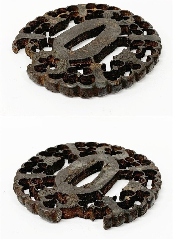

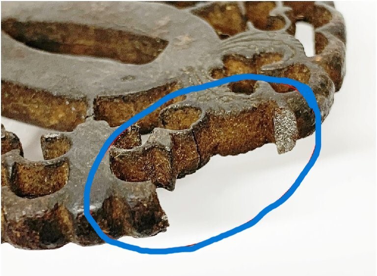

So, in my first post on this thread I wanted to show members what a broken piece of cast iron looks like.
Well, a broken cast iron tsuba is shown in picture number 1 and 2 below.
Compare those pictures (showing small grainy or sand type raised and lowered areas) to another cast iron tsuba shown below.  That other cast iron tsuba was shown on my post on p. 12 of my "Tsuba casting molds?" thread. (and yes, we all remember that thread!) -with explanation on June 26, 2023- picture 3 below-which you might have to zoom in on.   And let us not forget that I show pictures and state a reference here, unlike many members on that privously mentioned thread (oh well, let's not go there!).
I know that is a tiny area of that particular tsuba that was chipped off (on purpose if you read the post), but you can still notice the sand type texture of that exposed tiny piece.
So, my opinion is that the picture of that chipped tsuba referred to above is a cast iron tsuba.
I am pretty sure it would take a lot more effort to chip a small piece from a wrought iron tsuba than it would to chip a small piece from a cast iron tsuba (since cast iron is very brittle).
Pictures number 4, 5 and 6 shows a different broken cast iron tsuba for comparison (smaller areas of cast iron shown).
Now compare those pictures to the broken piece picture of wrought iron shown below (picture number 7).
Big difference!

(and as a side note- I did not damage any of the tsuba shown.  All pictures are from the internet!)

Dan Tsuba:
That's a great example of the characteristics of cast iron which are evident with destructive testing.  Not of course something most of us would prefer as a testing method, but it does happen!
Robert S
