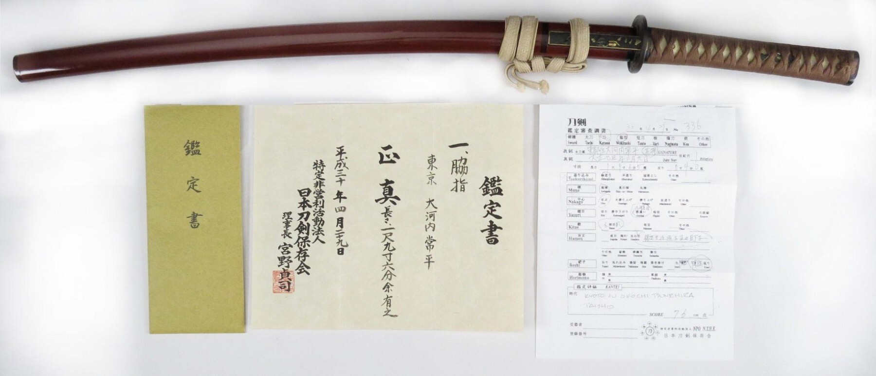

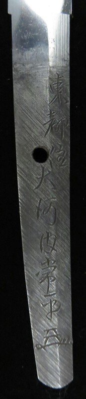

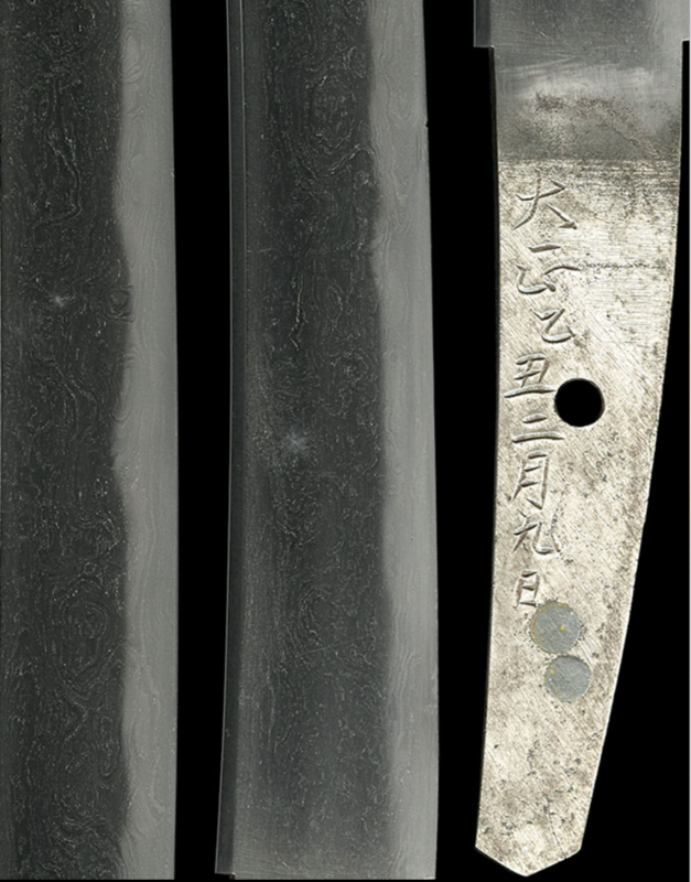

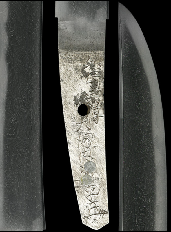

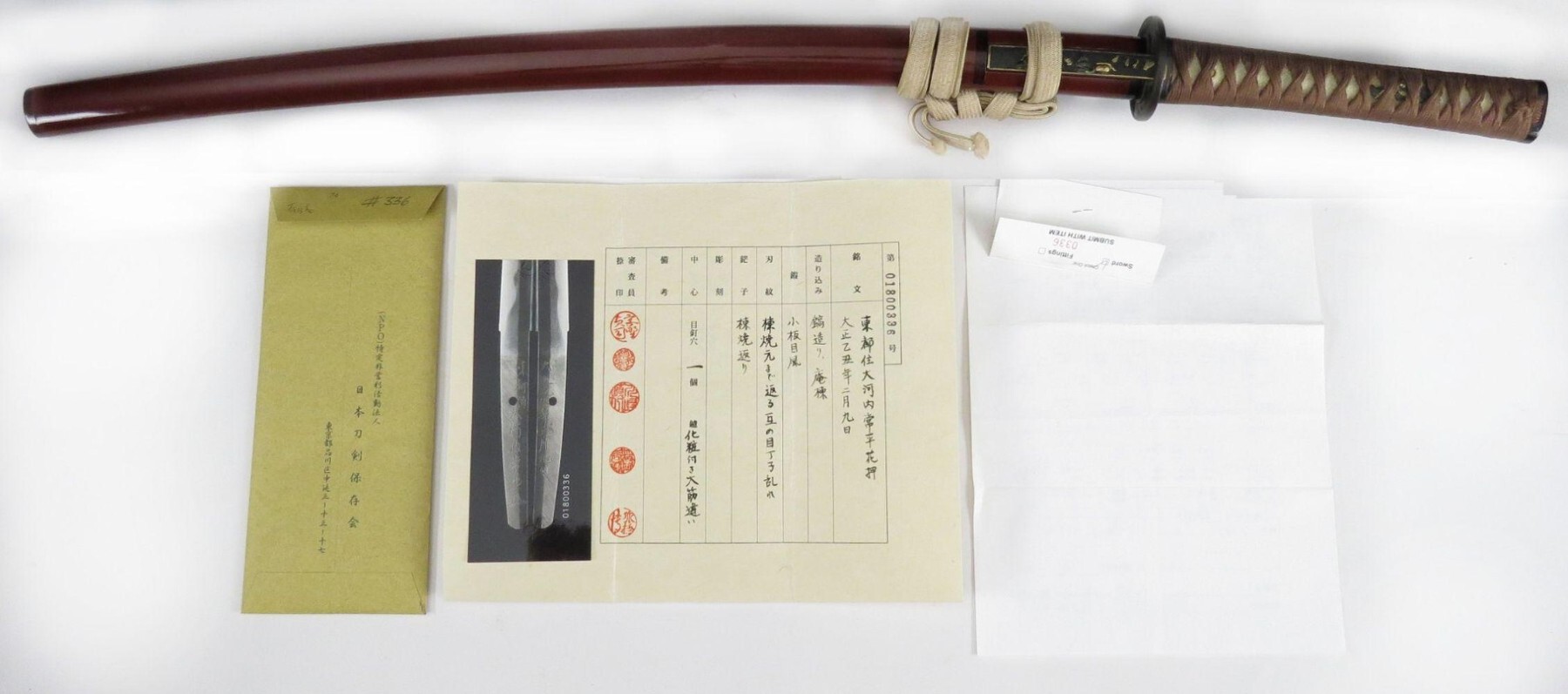

Ok.  They thought that one to be gimei.  Here's one linked to by @Nobody that is legit, with the same date: https://www.nipponto...swords6/KY332493.htm
Can you tell me that date.  I see it's Taisho, but cannot make out the year numbers.
The guy was born in 1925 (https://entities.ocl...mR9VfQ8B6yvgDjd.html), so it can't be 1913 like the auction house said.

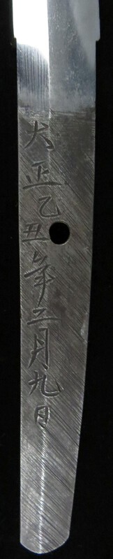

Screenshot2024-11-08071433.thumb.png.965973ea89a4aec3ee7fcb112f451735.pngScreenshot2024-11-08071458.thumb.png.439dac32ea6cf7e1c4720f8274af0c8e.png
The date on the nakago is 大正乙丑二月九日 – Taisho Kinoto-Ushi (1925), 2nd month, 9th day.
Okochi Tsunehira seems to have inscribed the date of his birth on his blade.
  • Wow 1
Thanks Moriyama-san!  What an unusual practice.
So no way to know if these were made during or after the war.  He would have to have made them before  the age of 20, though, to have been during the war.
