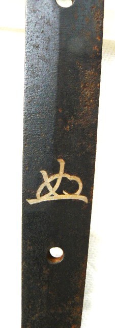

Kanenaga Posted November 5, 2024 Report Posted November 5, 2024 Kakihan on a blade by O-Sa? May we see it? Quote
Tsuba gardener Posted November 5, 2024 Author Report Posted November 5, 2024 Thanks Bryce, thanks for your reply especially as you brought points up which have questioned my hypotheses that only the heads of the school used a kao rather than students. On 11/3/2024 at 12:01 AM, Bryce said: G'day Neil, My favourite smith Gassan Sadakatsu almost always finished his mei with a kao, but occasionally he left it off. I don't really know why. His father Sadakazu on the other hand often didn't sign with a kao. Sometimes he did include one, sometimes he used a kokuin instead and sometimes he included a kokuin and a kao. No real pattern to this I can discern. Also, when students signed for their master, they also incuded the kao. Cheers, Bryce Quote

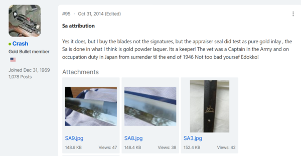

Bruce Pennington Posted November 5, 2024 Report Posted November 5, 2024 14 hours ago, Kanenaga said: Kakihan on a blade by O-Sa? May we see it? Les, Here is what I have from a Gunboards thread: 1 Quote
Kanenaga Posted November 8, 2024 Report Posted November 8, 2024 So it's a kinzogan mei, an attribution rather than a signature. And the kakihan likely belongs to whoever did the inlay work, rather than Sa himself. Just my opinion, of course. 1 Quote
Shugyosha Posted November 8, 2024 Report Posted November 8, 2024 I may be wrong but that looks more like a kinpun mei than kinzogan: I can’t see any evidence that the gold was inlaid rather than “painted” on and I think that reduces the likely veracity of the attribution. There have been a lot of these on the Japanese auction sites lately with a fanciful attribution painted on in gold to lend the air of an authoritative judgement - generally without papers of course. 1 Quote
