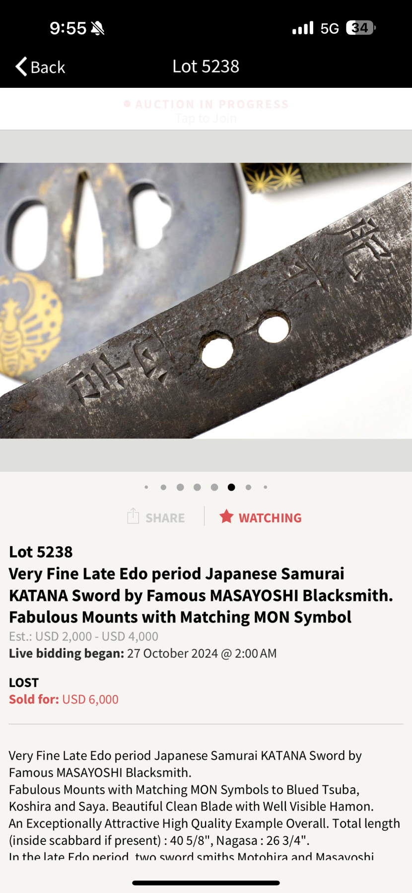

Bosco Posted October 26, 2024 Report Posted October 26, 2024 So this was sold today for $6000. I guess people not as expert as our member here to spot its a gimei ? Quote

Geraint Posted October 27, 2024 Report Posted October 27, 2024 Dear All. Minh posted this sword in an earlier thread where he got some feedback, hence his remark about information from members. Be a real shame if someone believed the translation provided by the auction house and thought they were getting a Masayoshi! All the best. 2 1 1 Quote

gatsu Posted October 28, 2024 Report Posted October 28, 2024 Why is title and description of the sword stating a completely different smith from the one in question (tadayoshi)? gimei or not, someone is paying $6000 for a sword that consist of completely false information. Quote
The Blacksmith Posted October 29, 2024 Report Posted October 29, 2024 But Kev, I think that perhaps one should simply forget the mei and simply think of the blade as mumei, then the simple question is, is the blade then, as it stands, worth the money? If it is, then nobody loses out. That said, I must admith that them getting the smith wrong is very annoying and they should be more carful, but as ever with such things, caveat emptor. I bought a Tsuta Sukehiro wakizashi blade years ago, Obviously, it wasn't by Sukehiro, even with my limited knowledge, but the blade was simply gorgeous, so I was very happy to buy it. Some would decry the blade as it was gimei, but the blade was fantastic workmanship and in perfect polish, so to me, well worth the £700 that it cost me. 3 1 Quote
Shugyosha Posted October 29, 2024 Report Posted October 29, 2024 Hi Russ, At the level of your Sukehiro, I think you're absolutely right and I've done it myself at that level but for $6k you can get quite a lot of genuine, authenticated blades from decent schools. As a mumei katana the new owner is looking at having paid two to three times what the blade would be worth if he tried to re-sell it as-is. Maybe he thought it was a genuine signature and bought with a view to papering it or he got taken with auction fever, who knows? Everyone's a treasure hunter these days. 2 Quote
Bosco Posted October 29, 2024 Author Report Posted October 29, 2024 On 10/29/2024 at 6:47 AM, The Blacksmith said: But Kev, I think that perhaps one should simply forget the mei and simply think of the blade as mumei, then the simple question is, is the blade then, as it stands, worth the money? If it is, then nobody loses out. That said, I must admith that them getting the smith wrong is very annoying and they should be more carful, but as ever with such things, caveat emptor. I bought a Tsuta Sukehiro wakizashi blade years ago, Obviously, it wasn't by Sukehiro, even with my limited knowledge, but the blade was simply gorgeous, so I was very happy to buy it. Some would decry the blade as it was gimei, but the blade was fantastic workmanship and in perfect polish, so to me, well worth the £700 that it cost me. Expand I was more interested in the Koshirae than the actually blade. It was signed by Shigenao full set Koshirae. 1 1 Quote
