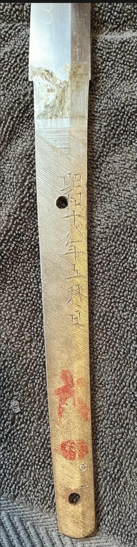

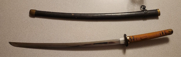

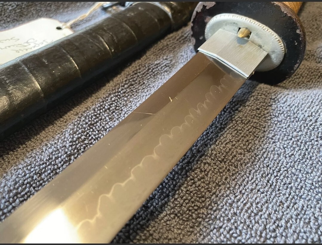

waljamada Posted October 26, 2024 Report Posted October 26, 2024 I've had this Rinji (type 3) gunto for a while signed by Torio Hiromasa dated 1943. I've read this kind of type 3 koshirae with some brass fittings was a prototype via Ohmura's site and other random places on the internet but also heard that they are simply a variation of the Type 3. Perhaps they were made early in manufacturing of the type 3...or perhaps throughout Type 3 production as an available option? I read in the Type 3 Timeline forum that the Rinji model was thought up by 1941 and not kicked into full roll out until 1943. I also read that blades dated early as 1941 in Rinji Type 3's (could have just used an older blade in a rinji koshirae though) in Bruce Pennington's records. To me the Torio Hiromasa being a 1943 blade could potentially lean away from being a prototype as it's much closer to the 1943 roll out period than the 1941/42 "mock up" periods. I bought mine thinking it was just a variation. Wondering if anyone knows the consensus on these or perhaps seen or come across any other information? First pics are of my Hiromasa and second sword is from a listing a long time ago for a Nagamitsu with type 98 tsuba, likely re-wrapped tsuba and the fittings do look a bit more like painted rather than brass. Last one is from an NMB post in 2013 where it was said it's a variation rather than from a prototype production round. Thanks in advance for any insights! 1 Quote

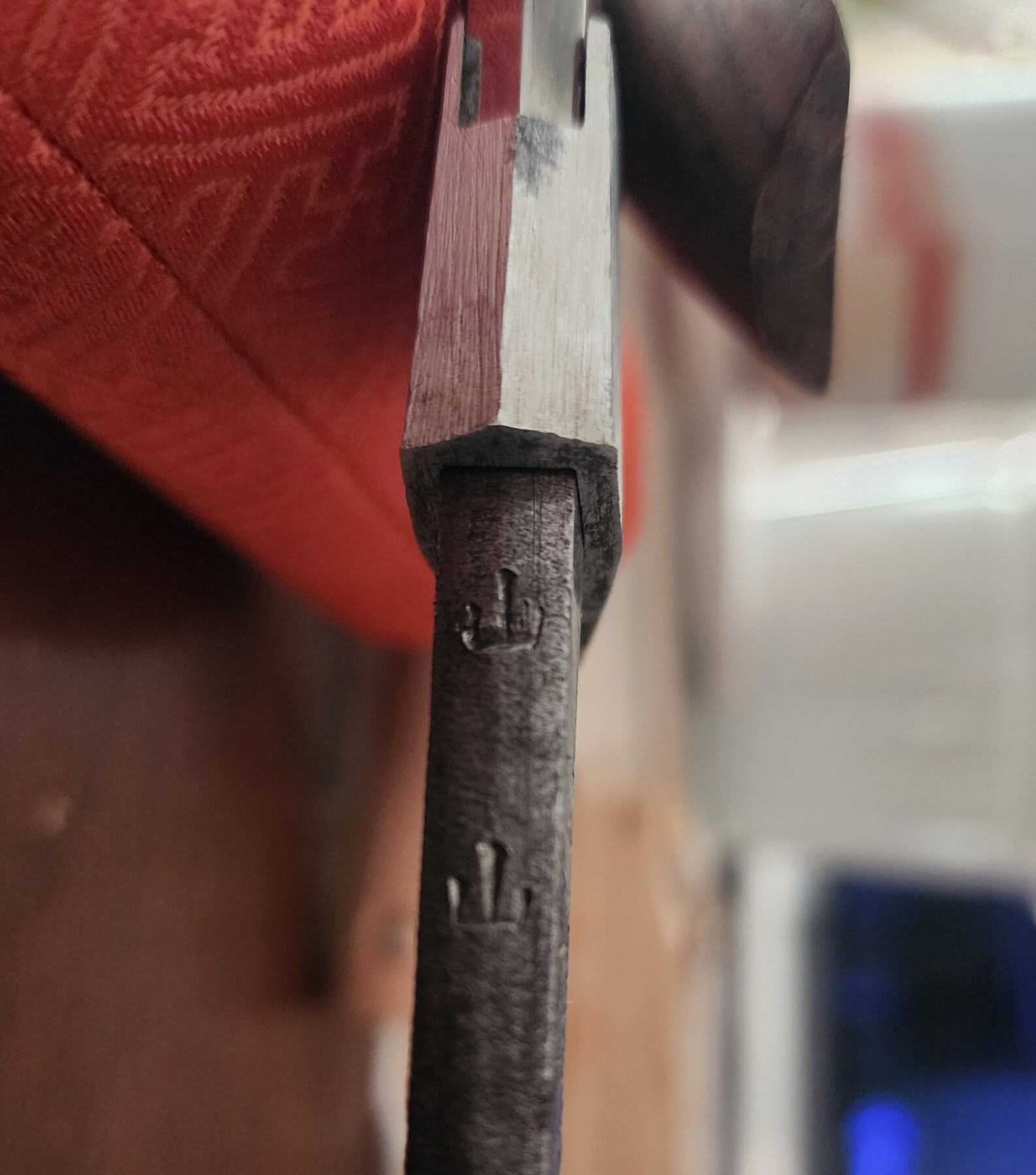

mecox Posted October 26, 2024 Report Posted October 26, 2024 Adam, does your sword have any stamps on the nakago mune? 1 Quote

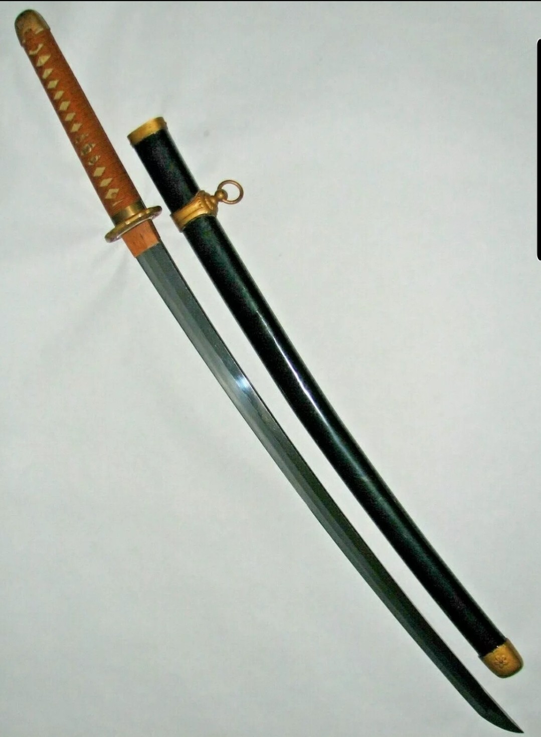

Brian Posted October 26, 2024 Report Posted October 26, 2024 I have at least 2 swords in the same mounts as the first one. Same wrap and menuki, and diagonal saya wrap. These mounts almost always contain fairly decent Gendaito from what I've seen. Definitely swords worth checking out if you see one. Also love to know more about this style. It was clearly a pattern. 1 Quote
PNSSHOGUN Posted October 26, 2024 Report Posted October 26, 2024 Given the simplification of fittings & reduction in quality, a last stage variant using less man hours seems most likely. 2 Quote
waljamada Posted October 26, 2024 Author Report Posted October 26, 2024 7 hours ago, mecox said: Adam, does your sword have any stamps on the nakago mune? Yes, a double yama. I'm gonna call this sword the "Two Mountain". 1 Quote
Bruce Pennington Posted October 26, 2024 Report Posted October 26, 2024 Adam, that is a beautiful Hiromasa! Looks like I should have read that old Rinji thread before posting on it. It's got some outdated info that I'll have to update. The Contingency model was designed in 1938 and production and sales began 22 August 1940. Unveiling the Rinji-seishiki Sword in 1940 - Nick Komiya It's taking me a while to find his post revealing the Uniform regulation change that allowed, even required, simplified fittings designs due to war shortages and Allied bombing damage to the industry. I'll post when I find it (or maybe @Kiipu has the reference??) My gut feel is this style was due to that relaxation of the mil specs and request to simplify weapons production. Update: Found it! From Rinji-seishiki to Daiyou-seishiki of Weapon Specs - Nick Komiya It was 1943: "The Daisei-Heiki Era Then by 1943, this kind of choice would no longer be available, as the standard quality stocks ran out. By this time, even primary weapons like rifles were routinely produced in nonstandard specs. Such symptoms were no longer of a "Rinji" nature but a chronic one, expected to get even worse in the future. So they officially coined a new phrase to describe these items of “compromised specs” and called them “Daiyo-Seishiki-Heiki” 代用制式兵器, (Substitute-Spec Weapons), which they abbreviated into the term, “Daisei-Heiki” 代制兵器." "These downgraded spec standards were applied to items that had little impact on military performance, like weapon accessories such as muzzle lids, rifle oilers made of resin instead of brass, belts, holsters and ammo pouches made of rubberized canvass instead of leather, woolen uniform items replaced by cotton, felt or even silk mixed in wool." 4 Quote
Bruce Pennington Posted October 26, 2024 Report Posted October 26, 2024 2 minutes ago, waljamada said: double yama. 山(yama) Matsuyama Branch office of Kokura Arsenal Quote
waljamada Posted October 26, 2024 Author Report Posted October 26, 2024 The only thing about this variation that bucks the standard Rinji trend to me is that it uses some materials that they were switching out due to supply at that point. Brass on the tsuka and aluminum for the seppa. 1 Quote

mecox Posted October 26, 2024 Report Posted October 26, 2024 Adam, that is a very nice blade from a good smith. There is info on Torio Hiromasa in NMB Downloads: (1) Showa/Ehime and (2) Fukuoka/Kokura. 1 Quote

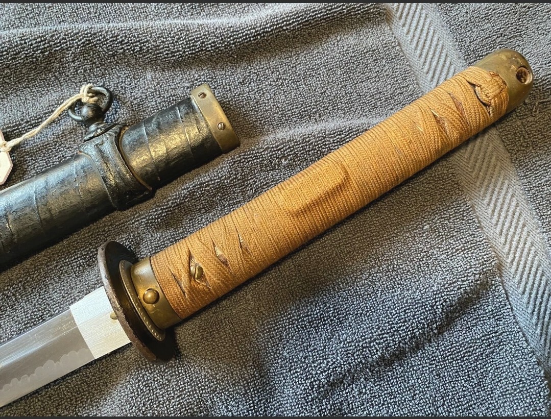

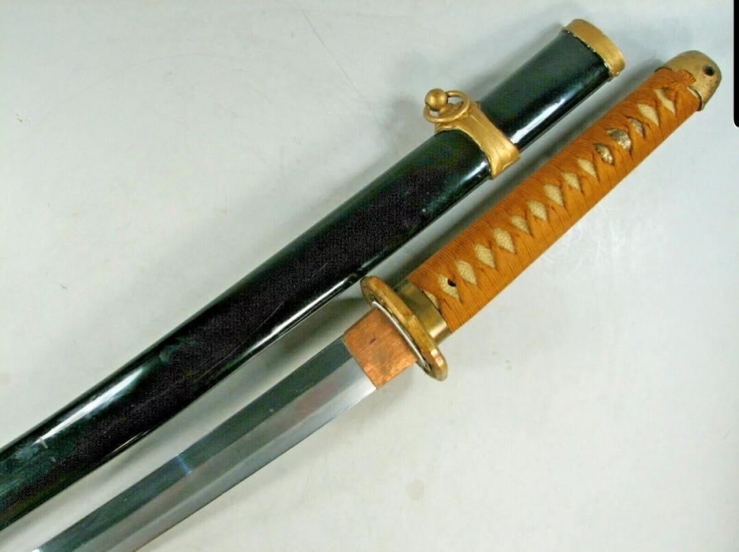

Conway S Posted January 17, 2025 Report Posted January 17, 2025 Another example on eBay right now: - Signed Ki Masatsugu https://www.ebay.com/itm/306045414160 1 Quote

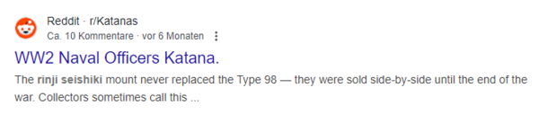

vajo Posted January 18, 2025 Report Posted January 18, 2025 That term Rinji Seishiki (Special Contingency 臨時正式 ) from Nick Komiya who was neither a collector than an military expert, read that word in only one document and you all jump in that boat and call this nonsense name which doesn't refer to a sword type. Call it what ever but Rinji Seishiki is total worse. It sounds like an obsession You could search the whole wide net about this 臨時正式 and you will find nothing. "Sweetheart? Yes, darling. Have you seen my "Special Contingency" sword? Yes, it's in the umbrella stand. Could you tell me, why do all the other officers have Type98 and you have a makeshift sword? Oh, darling, I'm just a sucker." Btw. The first "makeshift" special contingency rinji seishiki swords with high quality gendai-to blades came out 1942. And why the IJA produce low quality showa-to blades from medium range smiths equipped with your so called "high quality " Type98 mounts? They put scrappy showa-to blades into a bling bling koshirae and expensive tamahagene forged gendai blades in a special contingency koshirae for what? Blaming their officers? Is that really that what you belive? The type 3 has iron fittings. The type 98 is equipped with brass fittings. Did you think the ancient samurai walk into a war with brass fittings? 1 Quote
RobCarter3 Posted January 18, 2025 Report Posted January 18, 2025 I don’t think this nomenclature debate will ever be resolved. FWIW, I like “Type 100” or “Type 0” for this pattern. We now know that the prior belief in a 1943 adoption date is incorrect, so “Type 3” is wrong (but not as wrong as “SNLF/NLF,” “marine,” or “Type 44”). “Type 3” is the prevailing term outside this and a handful of other collector forums, so it’s likely here to stay. Technically, none of the Showa officer sword patterns had official “Type,” designations, because their requirements were promulgated with the uniform regulations. But, there’s a longstanding practice among both Western and Japanese collectors of referring to officer swords as “Type 94,” “Type 98,” etc. @vajo, I don’t think the takeaway from Nick Komiya’s articles on this pattern should be that it’s just a lesser, ersatz version of the Type 98. The Type 0 is a superior fighting sword mount. High and low quality blades exist in both Type 98 mounts and Type 0 mounts. The high-quality Type 0 mounts with ishime-lacquered wood saya were undoubtedly more time and labor intensive to produce than painted steel Type 98 saya. Several things can be simultaneously true: - this pattern incorporated improvements and addressed common points of failure based on feedback from the field; - this pattern reduced the use of war-critical materials and was intended to help alleviate the sword availability/cost shortage; - high-quality gendaito were sold to officers at artificially low prices thanks to heavy subsidization by the army through the RJT program. 1 1 Quote

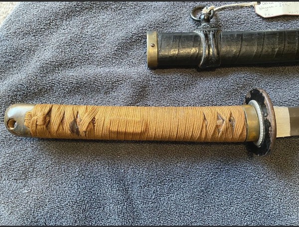

Bruce Pennington Posted January 18, 2025 Report Posted January 18, 2025 @SteveM @Kiipu @george trotter what do you say about this mei? It appears the Masa and Tsugu were crammed together side by side. If so, what is that last kanji? It doesn't look like Saku. Sorry about the blurry photo, it is the one posted by the seller. And is the first one "Ki" as the seller states? I don't see a KI Masatsugu in the RJT list or in Sesko's list. Quote

vajo Posted January 18, 2025 Report Posted January 18, 2025 I'll never get used to the term Rinji Seishiki. The term means Provisional Emergency Model. So derogatory in all respects. It sounds like someone quickly cobbled something together so that no one has to run around with a bare blade. Quote

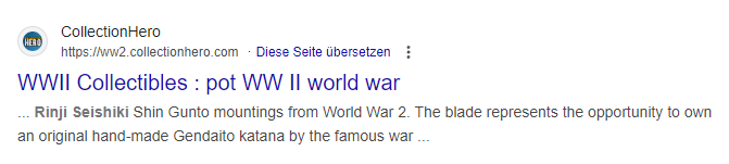

vajo Posted January 18, 2025 Report Posted January 18, 2025 @Bruce Pennington a lot of people uses now that term. Mostly in a negative context because they favorite Type 98 or want to sell higher. Thats my observe of the problem. I didn't know if everyone knows what the term means. In Germany we called FIAT cars "Fehler In Allen Teilen" (failure in all parts). It was from the 70s up to the 90s a big problem for that company. Type 3 sounds neutral. The NMB as an information board makes the music. If you rate here you make a vote up or down. It is not a closed community. 1 Quote
mecox Posted January 18, 2025 Report Posted January 18, 2025 @vajo Chris, Nick Komiya located the original Japanese docs using "rinji seishiki" which give the history and explanation. I have attempted to summarise that in my Kyushu paper on pages 16-17 to give correct historic context. The intro..."Rinji Seishiki Gunto 臨時 制式 軍刀 There is some confusion regarding the “name” of this sword and what it is. The first reference was in Army Ordnance No. 5668 September, 1938 with a proposal for a “rinji seishiki” sword, meaning a “temporary regulation” sword as a contingency measure. However, it was never formally approved as a “Type” so does not have a name; therefore, terms such as “Type 3” are incorrect; “Type 100” is also used as the design was approved in 1940, and “1940 Variant” has also been proposed. These terms are labels for convenience. 2 1 Quote
