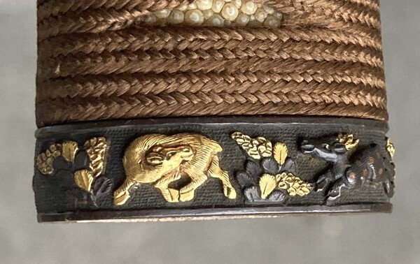

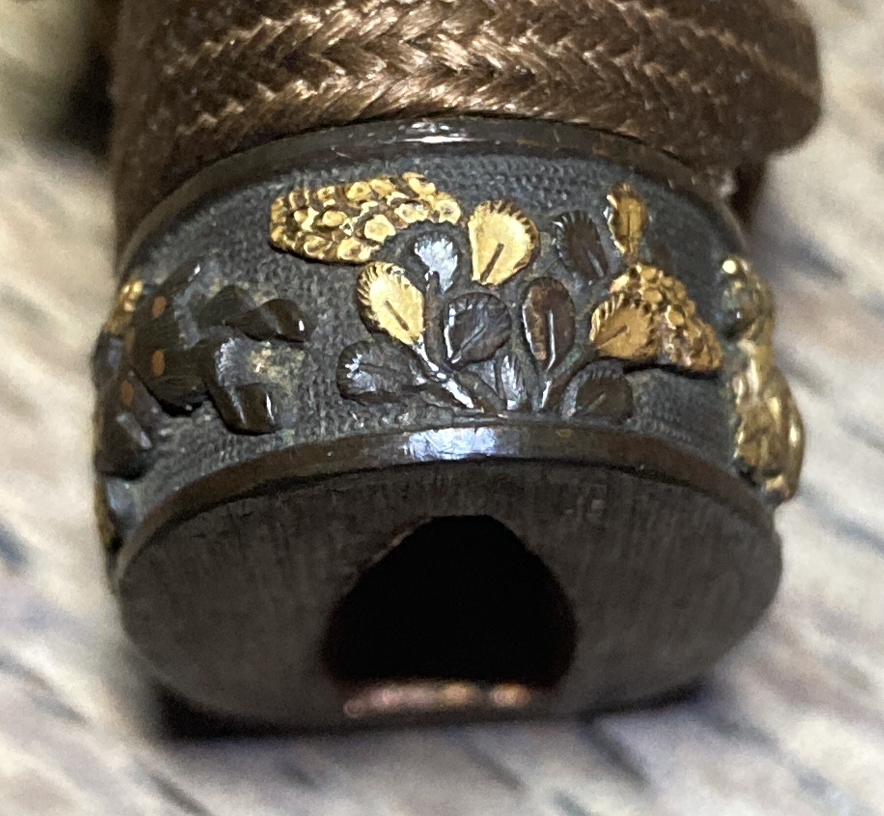

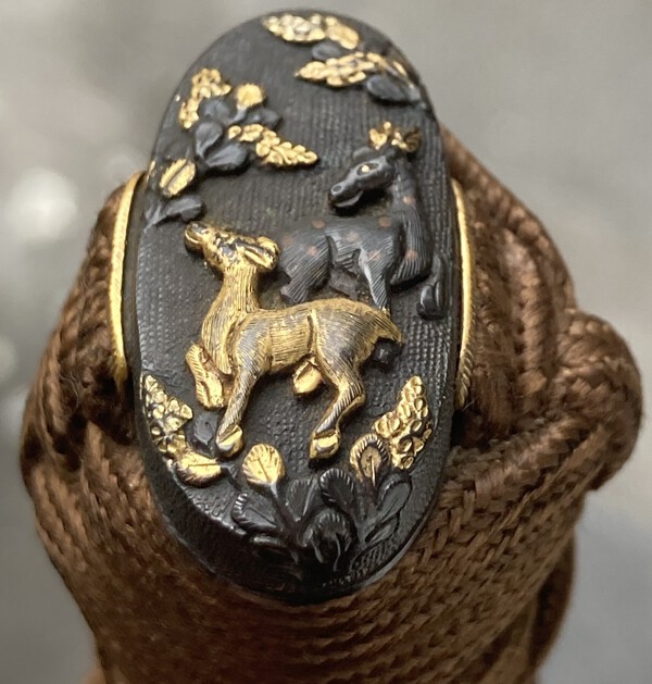

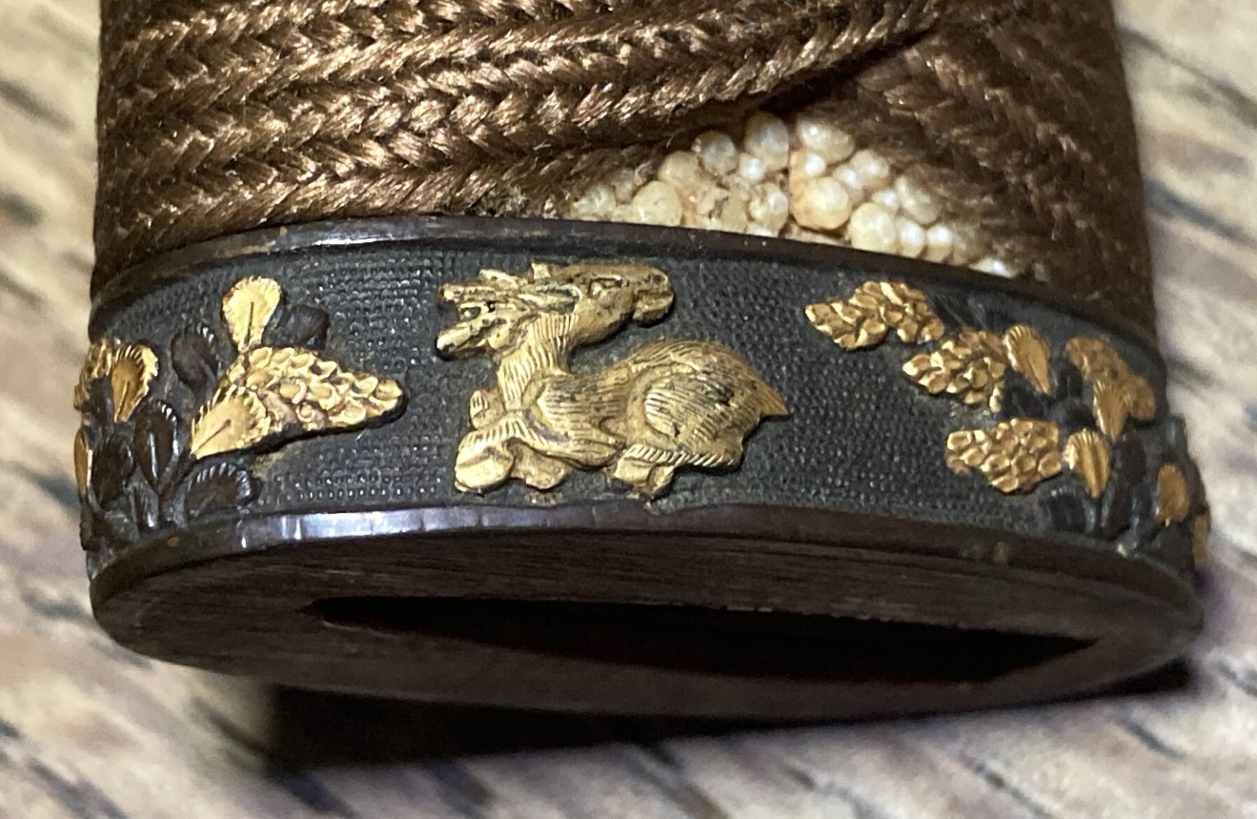

I wonder if this is considered as Goto?
What are you thoughts about the quality of these Fuchi and Kashira?
Are the golden deer and its spotted black friend based on a legend or story?
They do remind me about my nice time in Nara.
Kind regards.
Paris, just an opinion but I would describe these as being of very modest quality and definitely not Goto. I do not think they depict a specific legend or story
  • Thanks 2
