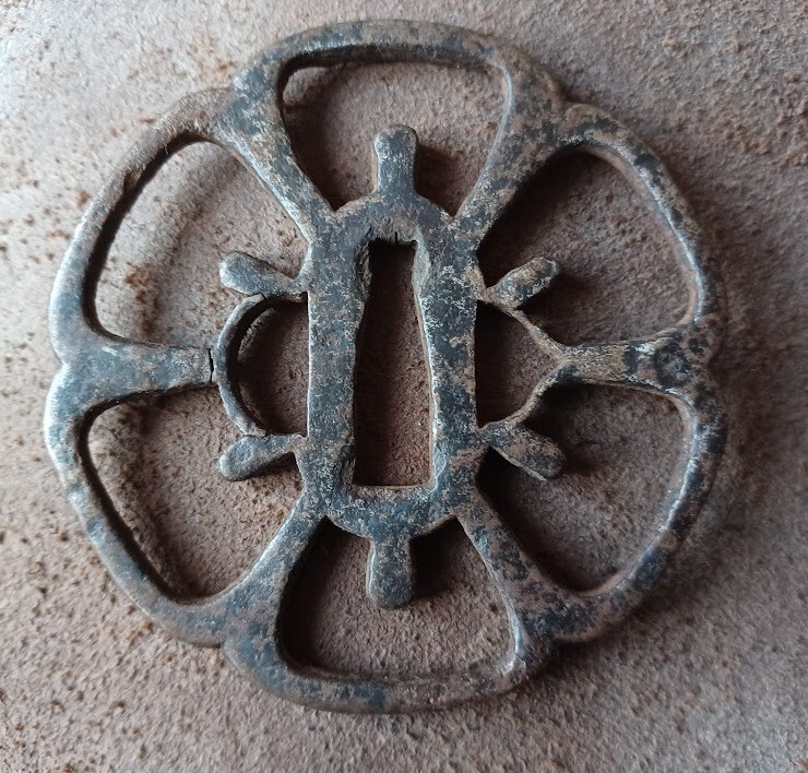

Ron M Posted November 1, 2024 Report Posted November 1, 2024 This is one of the “alleged” momoyama period Rope Mimi tsuba in my collection.Nice and thick! 🤣 5 Quote

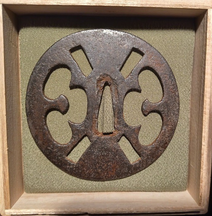

ROKUJURO Posted November 1, 2024 Report Posted November 1, 2024 A small KO-SHOAMI TSUBA, I think pre EDO JIDAI: 3 Quote
