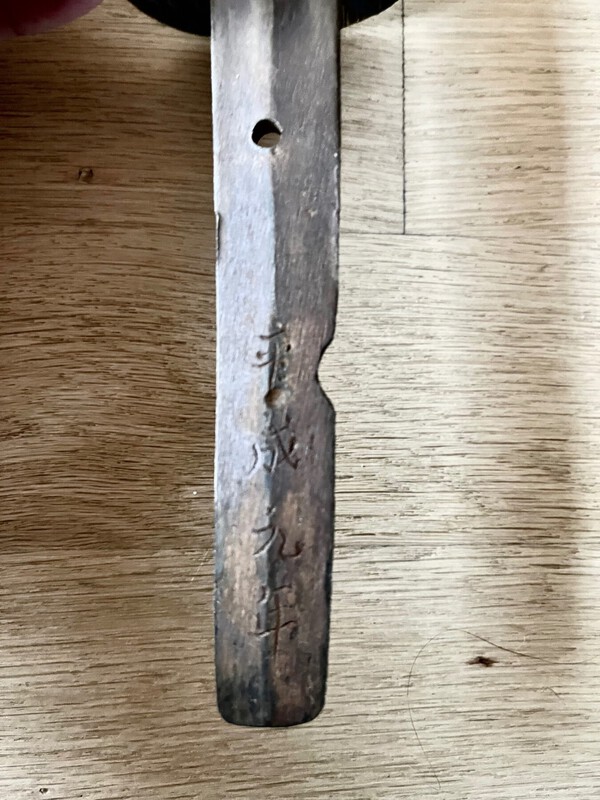

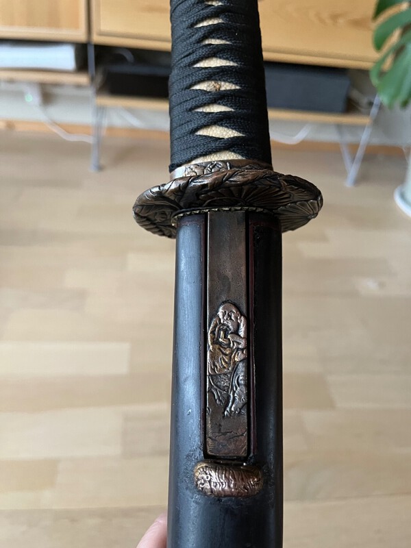

I recently purchased a katana with parts that contain shunga motif. It seems like the parts are a copy, but upon removing the tang the kanji seem to indicate that this blade was made made in 1944 « showa 19 by a smith called Kojima Kazaharu or Kojima Kazuji. Got this translation from Chat Gtp.
Can anyone help me with the translation and verify that this is indeed a blade from a gunto or if it a replica of some sort?!

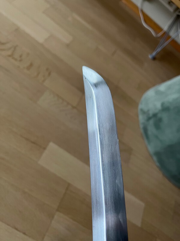

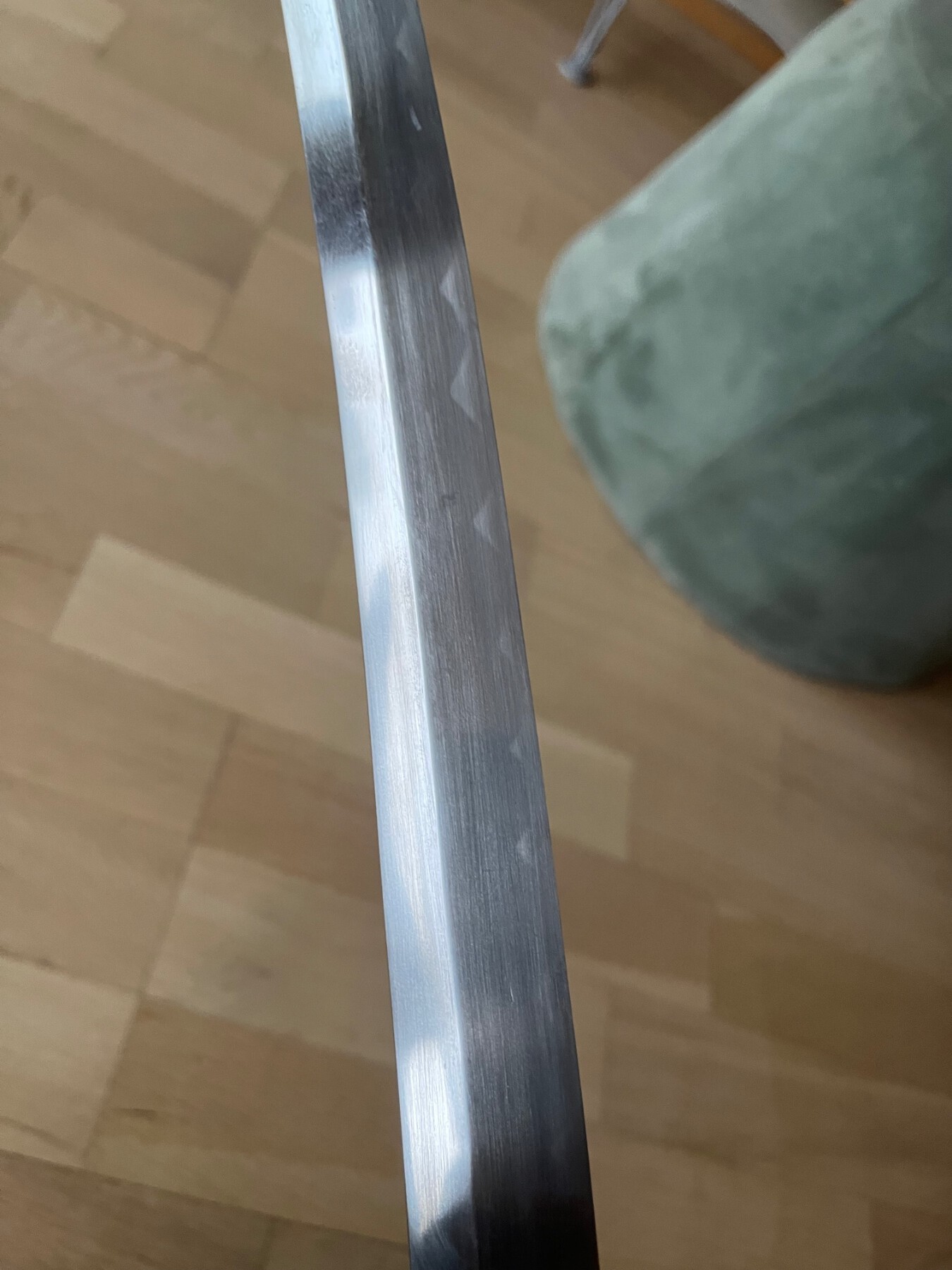

Thank you for your replies. As a newbie I would like to know how to spot fake from real nihonto. In this specific case is it because of the kanji or lack of yokote line on the kissaki?
Ryan , sorry but it is basically everything about the sword that  is wrong , especially the mounts and the tang and the kanji and etched Hamon .
Hi Ryan,
Like the Treasury Dept detectives that study the real money so that when the fake shows up, they recognize it right away, your best defense is to spend time looking at the real thing.  You can start, for free, on Ohmura's excellent site: http://ohmura-study.net/900.html.  65+ pages of pristine Japanese swords.  You'll find as you go through, he posts several nakago with mei, that you can compare to the sword in this thread.  You can also peruse the various threads here at NMB for examples of nakago and real hamon (temper patterns).
The final item I would add to Ray's list is the ito (handle wrap).  Japanese always alternate the fold direction of the wrap.  Chinese fold it in the same direction across the handle.
